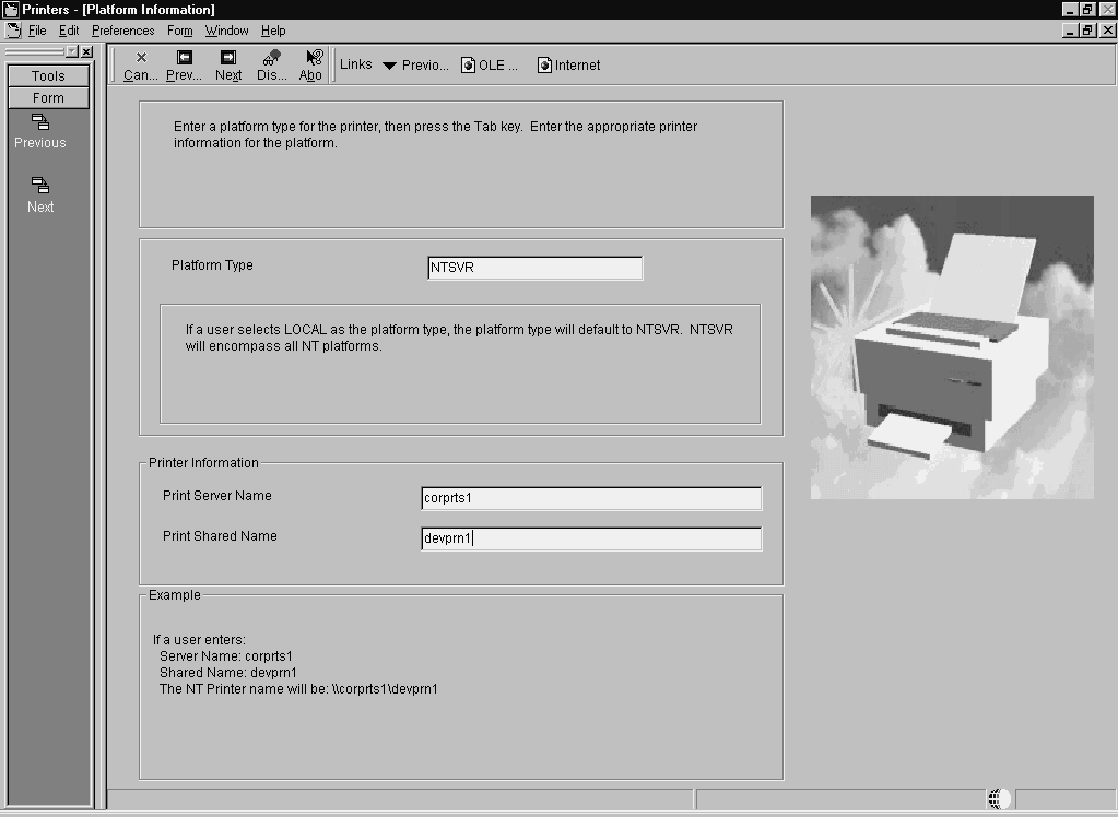

    The Platform Information form appears. The platform type may appear by default, depending on the operating system on which Release 9.2 is running.
    This image is described in the surrounding text.
  4. On Platform Information, complete these fields:
    Field
    Description
    Platform Type
    Enter the platform type on which you are installing or use the visual assist button to select a platform type.
    Print Server Name
    Enter the name of the print server for the printer you are setting up. Valid characters are all alpha (A-z), numeric (0-9), period ( . ), and dash ( - ). Release 9.2 uses this name, along with the print shared name, to create the printer name, which is unavailable for modification on the subsequent form.
    For printing reports to a non-network printer, leave this field blank.
    Print Shared Name
    Enter the share name of the printer you are setting up. All characters are valid except the forward slash ( \ ) and the backslash ( \ ). Release 9.2 uses this name, along with the print server name, to create the printer name, which is unavailable for modification on the subsequent form.
  5. After you complete the requisite fields, click Next to access the Printer Setup form.

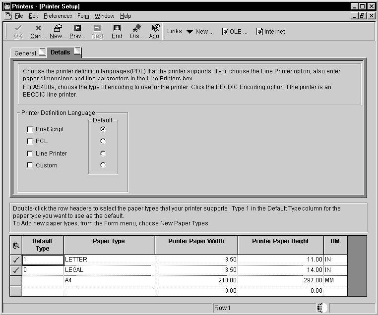

  7. On the Details tab, in the box labeled Printer Definition Language, select one of these options:
    • PostScript
    • PCL
    • Line Printer
    • Custom
  8. In the Default box, specify one of the Printer Definition Language options as the default value.
    You can select multiple PDLs, but only one default PDL. A user can override this default PDL at the time a batch process is submitted.
    Choosing PostScript or Printer Command Language (PCL), Release 9.2 disables the Line Printer option. Choosing Line Printer, Release 9.2 disables the PostScript and PCL options.

  16. In the grid at the bottom of the Printer Setup form, double-click the row header for each paper type that your printer supports. A checkmark appears in the row header for each paper type that you select.
    You can add new paper types as necessary. Instructions are included later in this task.
  17. In the Default Type column, enter the numeral 1 in the row for the paper type you want to use as the default.
    select only one paper type as the default. A user can override the default paper type when a batch process is submitted.
