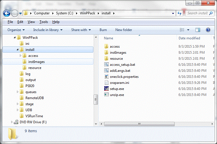

  3. Extract the zip files within the root of the folder created above. Using the example in this guide, a correctly extracted structure is:
    This image is described in the surrounding text.
  4. In the above extracted structure, locate the setup.exe file under the \install subdirectory, right-click on it, and select Run as Administrator.

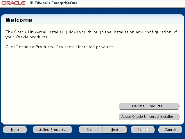

  5. On Welcome, click the Next button.

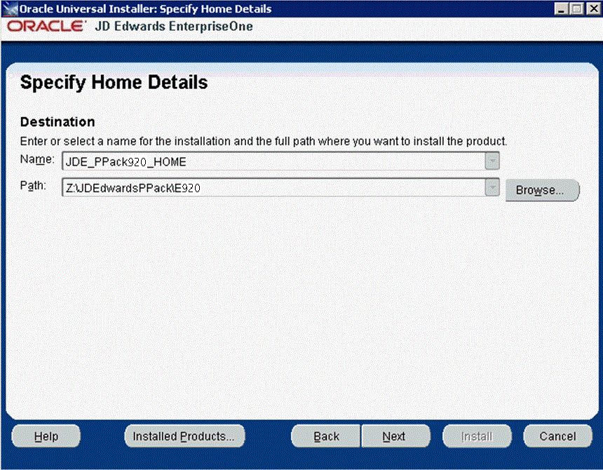

  8. On Specify Home Details, complete these fields:
    • Name
      Caution:
      Do not accept the default value for this field. If any Oracle product is already installed, the installer automatically populates this field with the existing ORACLE_HOME values, which will be incorrect for JD Edwards EnterpriseOne.
      Enter a unique name for the JD Edwards EnterpriseOne Platform Pack installation. For example:
      JDE_PPack_920_HOME
      Caution:
      Due to Java file and directory naming conventions, the directory name you specify here cannot contain special characters or blank (space) characters.
    • Path
      Caution:
      Do not accept the default value for this field. If any Oracle product is already installed the installer automatically populates this field with the value corresponding to the home for the ORACLE_HOME of the installed product, which will be incorrect for JD Edwards EnterpriseOne.
      Enter the drive and directory where you want the files installed on your Enterprise Server. For example:
      Z:\JDEdwardsPPack\E920
      Caution:
      Make sure to choose a disk or drive with enough space to accommodate required space for the mandatory logic server components and optionally the database components. If desired, later in the installation you can specify to install the database artifacts (such as tablespaces and tables) on a different disk and/or machine.
      If you are rerunning the JD Edwards EnterpriseOne Platform Pack Installer, refer to Rerunning the Platform Pack Installer.

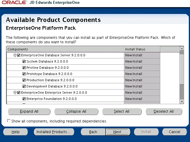

    The Oracle Universal Installer displays a list of available JD Edwards EnterpriseOne product components, as shown in the example below:
    Tip:
    Use the scroll bar to on the right hand side of the screen to view the complete list of available components.
    On Available Product Components, select from these choices:
    JD Edwards EnterpriseOne Database Server
    • System Database
      This selection includes mandatory system tables. If you do not select this box and the OUI installer does not detect that the component was previously installed, it selects this component automatically. Likewise, if you rerun the JD Edwards EnterpriseOne Platform Pack Installer to add an environment it will check to ensure that this component has already been installed and you will not be given an option to install the environment on a machine, drive, or directory that is different from that which contains the JD Edwards EnterpriseOne System Database.
    • Production Databases
    • Prototype Databases
    • Development Databases
    • Pristine Databases
    JD Edwards EnterpriseOne Enterprise Server
    • JD Edwards EnterpriseOne Foundation
      This selection includes system files. You must choose this feature for all initial installations of the Enterprise Server. If you do not select this feature, the JD Edwards EnterpriseOne Platform Pack Installer automatically selects it for installation.
    • ES Production
    • ES Prototype
    • ES Development
    • ES Pristine
  10. After you have verified your selection of components, click the Next button.

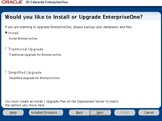

  11. On Would you like to Install or Upgrade EnterpriseOne?, choose whether you want to install or upgrade JD Edwards EnterpriseOne. The list below describes each run mode.
    • Install
      Install EnterpriseOne
      In this mode, the JD Edwards EnterpriseOne Platform Pack Installer checks for the existence of JD Edwards EnterpriseOne business data and control tables; if either exists, the JD Edwards EnterpriseOne Platform Pack Installer aborts. This prevents the inadvertent overwriting of existing critical business data and control tables. If the JD Edwards EnterpriseOne Platform Pack Installer does not detect pre-existing JD Edwards EnterpriseOne data or control tables, the installation process continues normally.
      Caution:
      You should always back up all databases that you want to preserve.
    • Traditional Upgrade
      Traditional Upgrade EnterpriseOne
      In this mode, the JD Edwards EnterpriseOne Platform Pack Installer checks for the existence of JD Edwards EnterpriseOne business data and control tables which are prerequisites to an upgrade of JD Edwards EnterpriseOne.
      In this Upgrade mode, the installer replaces all objects in the selected pathcodes.
      Caution:

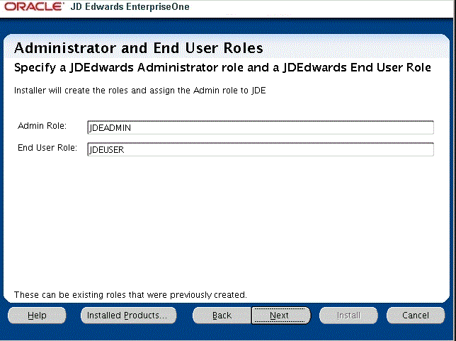

  17. On Administrator and End User Roles, specify the roles that the installer will create and assign to the JDE users in the database:
    • Admin Role
      The default value is JDEADMIN.
    • End User Role
      The default value is JDEUSER.
    Caution:
    For your Production systems, Oracle highly recommends that you change these default values for roles.

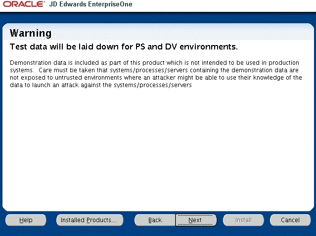

  18. On Warning, Test data will be laid down for PS and DV Environments, the following warning is displayed:
    Demonstration data is included as part of this product which is not intended to be used in production systems. Care must be taken that systems/processes/servers containing the demonstration data are not exposed to untrusted environments where an attacker might be able to use their knowledge of the data to launch an attack against the systems/processes/servers.

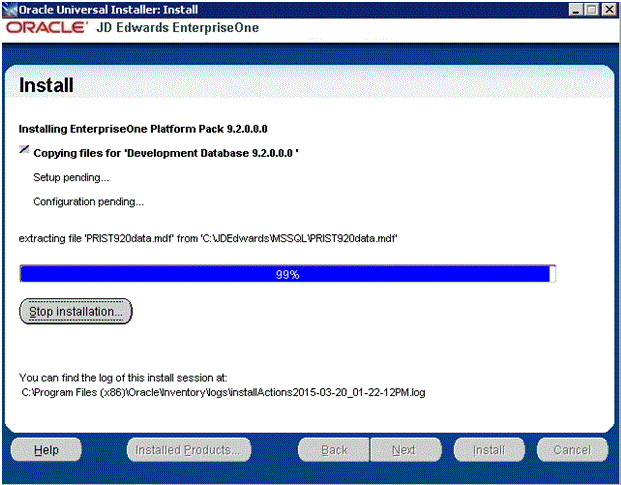

  20. Click the Install button.
    As the installer runs it displays the Install progress, as shown in the following example.

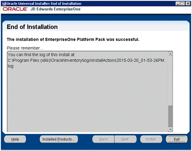

    After the installation is complete, the following End of Installation screen is displayed.
  21. On End of Installation, verify the installation of the EnterpriseOne Platform Pack was successful.
    Review the Please remember ... portion for the installer log file location. The log file name is specified with the date and stamp when the installer ran. For example:
    c:\Program Files (x86)\Oracle\Inventory\logs\installActions2011-08-09_04-11-06-PM.log

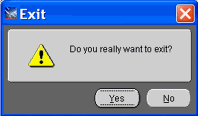

  22. Click the Exit button to exit OUI.
  23. On Exit, click the Yes button.
