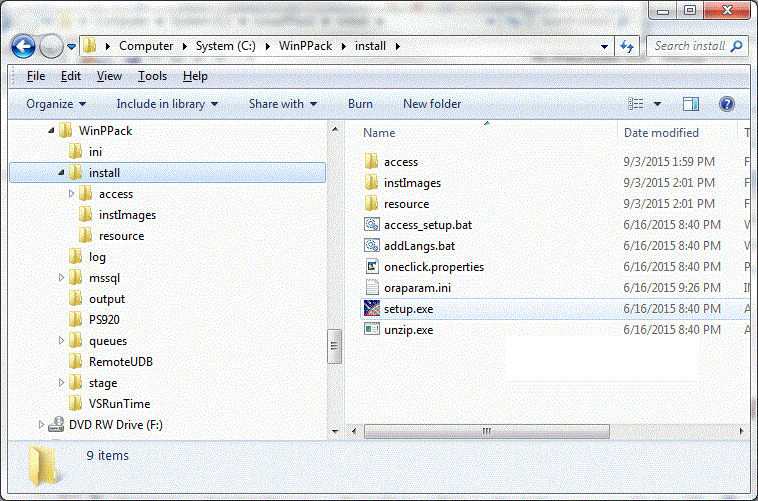

  4. In the above extracted structure, locate the setup.exe file under the \install subdirectory, right-click on it, and select Run as Administrator.
    The Oracle Universal Installer takes a few minutes to start up.

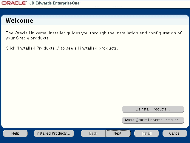

  5. On Welcome, click the Next button.

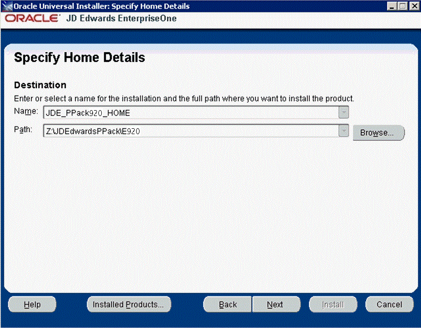

  8. On Specify Home Details, complete these fields:
    • Name
      Caution:
      Do not accept the default value for this field. If any Oracle product is already installed, the installer automatically populates this field with the existing ORACLE_HOME values, which will be incorrect for JD Edwards EnterpriseOne.
      Enter a unique name for the JD Edwards EnterpriseOne Platform Pack installation. For example:
      JDE_PPack_920_HOME
      Caution:
      Due to Java file and directory naming conventions, the directory name you specify here cannot contain special characters or blank (space) characters.
    • Path
      Caution:
      Do not accept the default value for this field. If any Oracle product is already installed the installer automatically populates this field with the value corresponding to the home for the ORACLE_HOME of the installed product, which will be incorrect for JD Edwards EnterpriseOne.
      Enter the drive and directory where you want the files installed on your Enterprise Server. For example:
      Z:\JDEdwardsPPack\E920
      Caution:
      Make sure to choose a disk or drive with enough space to accommodate required space for the mandatory logic server components and optionally the database components. If desired, later in the installation you can specify to install the database artifacts (such as tablespaces and tables) on a different disk and/or machine.
      If you are rerunning the JD Edwards EnterpriseOne Platform Pack Installer, refer to Rerunning the Platform Pack Installer.

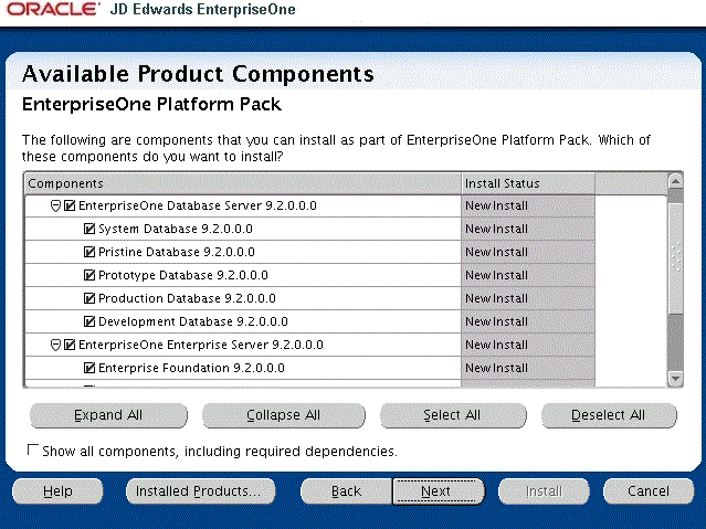

    The Oracle Universal Installer displays a list of available JD Edwards EnterpriseOne product components, as shown in the example below:
    This image is described in the surrounding text.
    Tip:
    Use the scroll bar to on the right hand side of the screen to view the complete list of available components.
    On Available Product Components, select from these choices:
    JD Edwards EnterpriseOne Database Server
    • System Database
      This selection includes mandatory system tables. If you do not select this box and the OUI installer does not detect that the component was previously installed, it selects this component automatically. Likewise, if you rerun the JD Edwards EnterpriseOne Platform Pack Installer to add an environment it will check to ensure that this component has already been installed and you will not be given an option to install the environment on a machine, drive, or directory that is different from that which contains the JD Edwards EnterpriseOne System Database.
    • Production Databases
    • Prototype Databases
    • Development Databases
    • Pristine Databases
    JD Edwards EnterpriseOne Enterprise Server
    • JD Edwards EnterpriseOne Foundation
      This selection includes system files. You must choose this feature for all initial installations of the Enterprise Server. If you do not select this feature, the JD Edwards EnterpriseOne Platform Pack Installer automatically selects it for installation.
    • ES Production
    • ES Prototype
    • ES Development
    • ES Pristine
    For any Upgrades, you should always select the Pristine environment. Otherwise, Table Conversions will not process correctly.
    For Simplified Upgrades, you must have the Pristine environment in order to run Spec Merge.

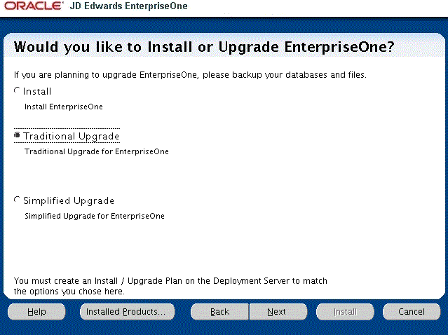

  11. On Would you like to Install or Upgrade EnterpriseOne?, choose whether you want to install or upgrade JD Edwards EnterpriseOne. The list below describes each run mode.
    • Install
      Install EnterpriseOne
      In this mode, the JD Edwards EnterpriseOne Platform Pack Installer checks for the existence of JD Edwards EnterpriseOne business data and control tables; if either exists, the JD Edwards EnterpriseOne Platform Pack Installer aborts. This prevents the inadvertent overwriting of existing critical business data and control tables. If the JD Edwards EnterpriseOne Platform Pack Installer does not detect pre-existing JD Edwards EnterpriseOne data or control tables, the installation process continues normally.
      Caution:
      You should always back up all databases that you want to preserve.
    • Traditional Upgrade
      Traditional Upgrade EnterpriseOne
      In this mode, the JD Edwards EnterpriseOne Platform Pack Installer checks for the existence of JD Edwards EnterpriseOne business data and control tables which are prerequisites to an upgrade of JD Edwards EnterpriseOne.
      In this Upgrade mode, the installer replaces all objects in the selected pathcodes.
      Caution:
    • Simplified Upgrade
      Simplified Upgrade EnterpriseOne
      The Simplified Upgrade is only available when upgrading from JD Edwards EnterpriseOne Applications Releases 9.0 Update 2 or 9.1.
      As with the Traditional Upgrade, in this mode the JD Edwards EnterpriseOne Platform Pack Installer checks for the existence of JD Edwards EnterpriseOne business data and control tables which are prerequisites to an upgrade of JD Edwards EnterpriseOne.
      The Simplified Upgrade does not deliver Central Objects, except for PS920. The existing Central Objects are preserved and the data sources are configured to point to existing prior release path codes, which can be either from JD Edwards Release 9.0.2 or 9.1. The installer delivers logic objects and path codes for each environment that is selected for the upgrade.
      For example, if you run a Simplified Upgrade from DV900 to DV920, the DV900 Central Objects do not match those that are required for Applications Release 9.2. The Central Objects - DV920 points to DV900. The process ensures that an attempt for an object match on these objects does not occur until you run the Spec Merge. The Platform Pack requires the 9.2 table definitions in order to run the TC Workbench (which runs before Spec Merge). Therefore the Platform Pack installs a second spec.ini (Simplified_spec.ini) which points ALL pathcodes to PS920FA
      If you choose a Simplified Upgrade, the Platform Pack renames the existing spec.ini to another name (for example, spec.bak) so that it can rename the file for Simplified Upgrade, which is Simplified_spec.ini, to spec.ini. If you build and deploy and new PS920 package before upgrading DV, you will need to update the spec.ini in DV920 to point to the new PS package. For example, PS920FB.
      If you choose to upgrade the Pristine and Development environments, the installer delivers databases for these path codes:
      • PS920
      • PS920CTL
      • PS920DTA
      • SY920
      • OL920
      • DD920
      • SVM920
      For the database, the JD Edwards EnterpriseOne Platform Pack Installer performs the same as a Traditional Upgrade in terms of delivering the entire database for the Pristine environment. However, unlike the Traditional Upgrade, the Simplified Upgrade does not deliver Central Objects for other environments.
      For Simplified Upgrade, for all databases, these users are created by the Platform Pack but they are not used:
      • DV920
      • PD920
      • PY920
      Caution:
  12. Click the Next button.

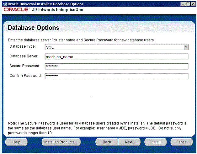

  13. On Database Options, complete these fields:
    • Database Type
      Use the pulldown to choose SQL.
    • Database Server
      By default, the JD Edwards EnterpriseOne Platform Pack Installer automatically detects and populates this field with the machine name on which it is running. The JD Edwards EnterpriseOne Platform Pack Installer validates the Database Server name and compares it against the name of the local computer. If these values are different (for example, if you manually change the value of this field), the JD Edwards EnterpriseOne Platform Pack Installer assumes the Database Server is either a clustered or remote server. If you have selected to install databases, and the database server name that you entered cannot be validated, a warning dialog is displayed with resolution instructions. Refer to the section of this chapter entitled: Warning - Database Server Name Does Not Match.
      For additional details on all Platform Pack error conditions, refer to the section of this chapter entitled: Troubleshooting Platform Pack Installation.
      Caution:
      If you are installing the Enterprise Server and the Database Server on different machines, you cannot run the installer on the Enterprise Server and install the Database Server remotely. You must copy the installer images to the Database Server and run the installer on that machine. For the Enterprise Server only, you will need the image for disk1. For a Database Server, you will need the disk1 image plus the database disk images.
    • Secure Password
      Caution:
      In order to ensure data security, Oracle strongly recommends that you change this to a secure password.
      If you wish to change the default password that the JD Edwards EnterpriseOne installer uses to connect to your SQL Server database, you can enter a value for the Secure Password that conforms to the password policy of your operating system. The maximum length of the password is 10 characters and cannot contain any of these special characters: @$ / \.
      Caution:
      The non-encrypted value for the Secure Password is stored in the SQL_set.bat file. This password is used to load the database components. Oracle strongly recommends that you erase this value once the database scripts have run successfully.
      Note: If you subsequently add an additional database component, you must set the value in the set script back to the Secure Password before running the scripts or the OUI installer (which calls the scripts) for the additional components.
      If you do not change the default value (DEFAULT), the system creates a password for each user where the password is the same as their user ID. For example, if a user ID is JDE, then by default the system creates a corresponding password of JDE for that user.
      Caution:
      When you change the default password in the Platform Pack installation for your Enterprise Server, you must also manually change the [DSPWD] section in the jde.ini on the Deployment Server and specify the new secure password that you are using. If you fail to synchronize these database password settings, the various Installation Workbenches will not be able to connect to the database.
      For additional details on working with the [DSPWD] section of the jde.ini file, refer to the section of this chapter entitled: Working with Database Security.
    • Confirm Password
      Re-enter the password.

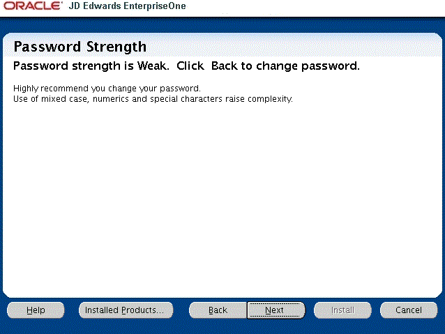

  15. The installer displays the Password Strength panel if you have chosen a weak password.
    Caution:
    The installer program does not force you to change your password for a weak value. However it is highly recommended that you change your password. Use of mixed case, numerics and special characters raise complexity.
  16. Click the Back button to go back and change the password or click the Next button to continue.

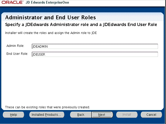

  17. On Administrator and End User Roles, specify the roles that the installer will create and assign to the JDE users in the database:
    • Admin Role
      The default value is JDEADMIN.
    • End User Role
      The default value is JDEUSER.
    Caution:
    For your Production systems, Oracle highly recommends that you change these default values for roles.

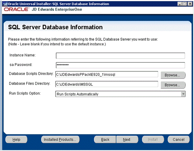

  18. Click the Next button to enter SQL Server database information.
    On SQL Server Information, complete these fields referring to the Oracle Database Server that you want to use:
    • Instance Name
      Leave this field blank if you want to use the default instance (MSSQL SERVER). Otherwise, enter an instance name.
    • sa Password
      For the selected instance, enter a valid password for the system administrator of your SQL Server database.
      Caution:
      The non-encrypted value for the sa Password is stored in the SQL_set.bat file. This password is used to load the database components. Oracle strongly recommends that you erase this value once the database scripts have run successfully.
      Note: If you subsequently add an additional database component, you must set the value in the set script back to the sa Password before running the scripts or the OUI installer (which calls the scripts) for the additional components.
    • Database Scripts Directory
      Enter the directory in which you want to put your database scripts. For example:
      C:\JDEdwardsPPack\E920_1\mssql
    • Database Files Directory
      Enter the directory in which you want to put your database files. For example:
      C:\JDEdwards\MSSQL
    • Run Scripts Options
      Use this pulldown to choose:
      Run Scripts Automatically
      The Installer configures and runs the database scripts. This is the default selection.
      Run Scripts Manually Later
      The Installer edits and deploys the scripts and dump files, but does not run them. Choose this option if:
      • You want to manually run the scripts at a later time.
      • You want to spread your tablespaces over multiple drives.
  19. Click the Next button.

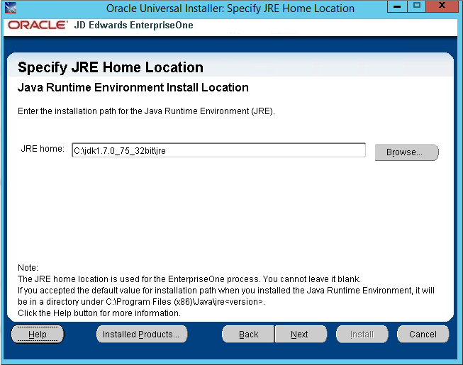

  20. On Specify JRE Home Location, enter or browse to the location of your 32-bit Java Runtime Environment (JRE). In order to proceed, you cannot leave this value blank and you must specify an existing valid location and the JRE in that location must be a 32-bit version. If you accepted the default value for installation path when you installed the Java Runtime Environment, the location will be in a directory under:
    c:\Program Files (x86)\Java\jdk<version>
    The installer validates the specified location and copies the JRE to a location where it can be used by the runtime processes of JD Edwards EnterpriseOne.
    Caution:
    This JRE is a prerequisite to installing JD Edwards EnterpriseOne. Because JD Edwards EnterpriseOne running on an Enterprise Server as a 32-bit application, the pre-installed JRE for use by JD Edwards EnterpriseOne on the Enterprise Server must be a 32-bit version. Refer to the Oracle Certifications for JD Edwards EnterpriseOne Enterprise Servers for additional details and supported vendors and releases of JREs for your platform and operating system.

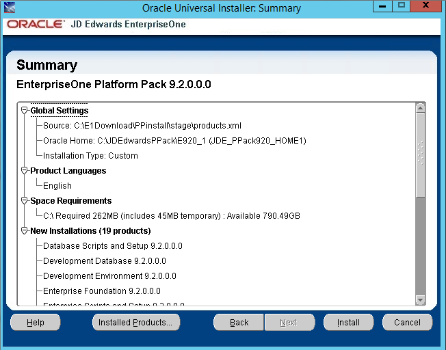

  22. On Summary, in the top half of the screen, review your selections and in the bottom half of the screen review the NOTES, which detail the disk space requirements for OUI support files and also for the Platform Pack being installed on this machine.

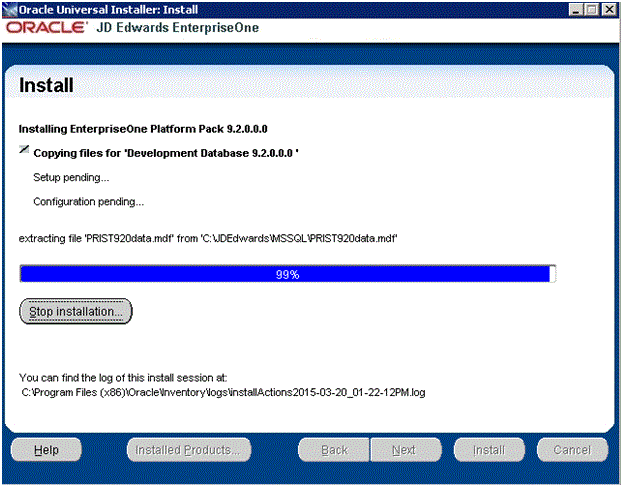

  23. Click the Install button.
    As the installer runs it displays the Install progress, as shown in the following example.

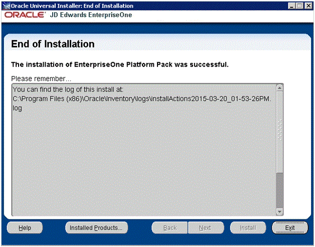

    After the installation is complete, the following End of Installation screen is displayed.
  24. On End of Installation, verify the installation of the EnterpriseOne Platform Pack was successful.
    Review the Please remember ... portion for the installer log file location. The log file name is specified with the date and stamp when the installer ran. For example:
    c:\Program Files (x86)\Oracle\Inventory\logs\installActions2011-08-09_04-11-06-PM.log
  25. Click the Exit button to exit OUI.

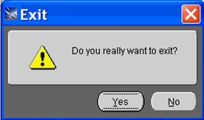

  26. On Exit, click the Yes button.
