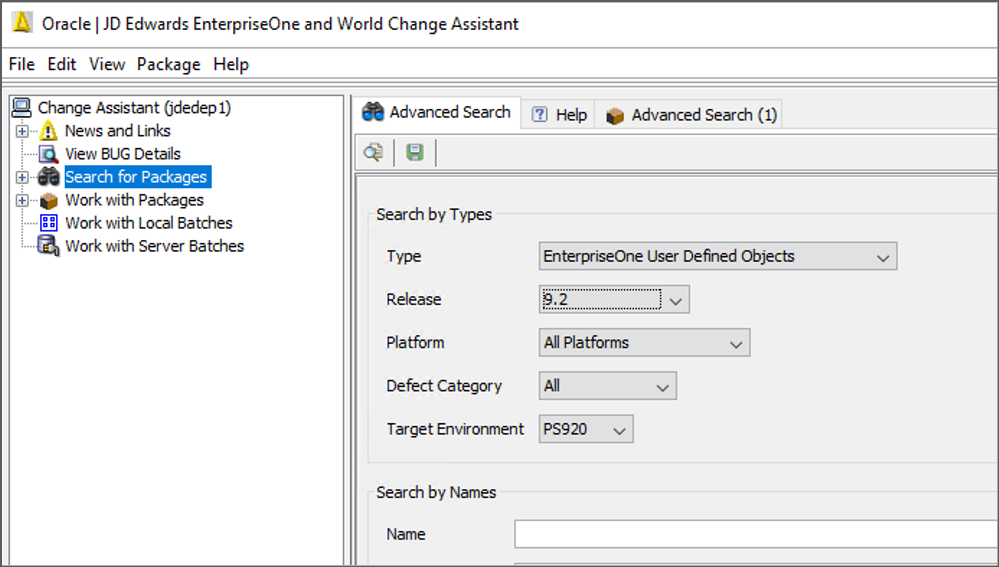

  1. Select Search for Packages from the Change Assistant tree node.
  2. In the Advanced Search screen, set these criteria:
    • Type: EnterpriseOne User Defined Objects
    • Release: 9.2
    • Platform: All Platforms
    • Target Environment: PS920 or a valid target environment to deploy the package.
    Description of sample-image-1.png follows
    Change Assistant - Advanced Search
  3. Click Search Search icon.
    Description of sample-image-14.png follows

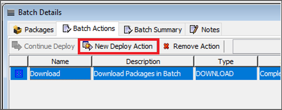

    Alternatively, click the Batch Actions tab and then click New Deploy Action.
    Batch Details Pane - New Deploy Action Button on the Toolbar

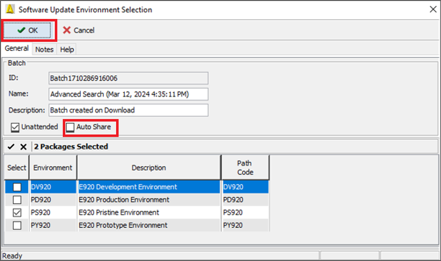

    The Software Update Environment Selection form is displayed.
  4. Select the Auto Share option to automatically share the UDOs after deployment.
    Software Update Environment Selection Form
  5. Click OK to start the deployment.

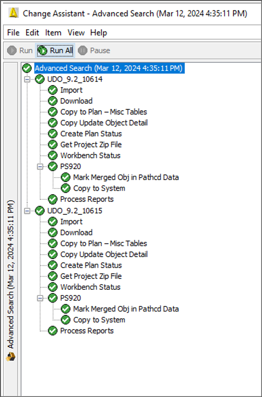

    UDO Deployment
  6. Click Show Details to review the deployment steps.
    UDO Package Deployment Steps

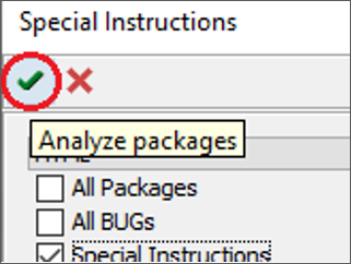

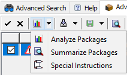

  5. Use the Tool drop-down to select Special Instructions.
    Description of image follows
    Tools Drop-Down - Special Instructions Option
  6. In the Special Instructions options, select Special Instructions
    Special Instructions Option Selection

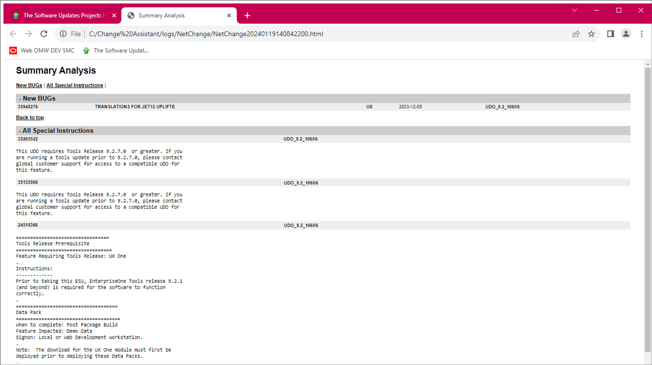

  7. Click Analyze Packages. When the analysis process finishes, the Summary Analysis Report appears.
    Analyze Packages
    Note: Hover over the processing icon at the top of the browser window to view background processes.
  8. The Summary Analysis report includes the special instructions for the list of selected packages.
