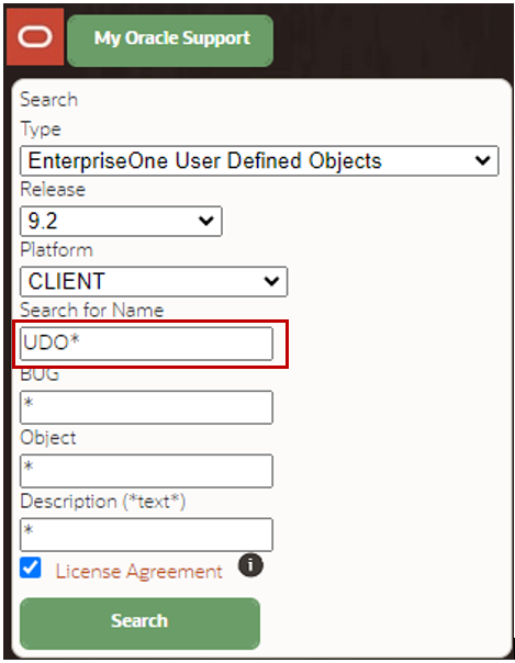

  1. Access the Oracle JD Edwards Update Center.
  2. In the Search section, set the following criteria:
    • In the Type field, select EnterpriseOne User Defined Objects.
    • In the Release field, select 9.2.
    • In the Platform field, select CLIENT.
    Description of image-1.png follows
    Oracle JD Edwards Update Center - UDO Search Criteria
  3. Enter the UDO name or UDO* in the Search for Name field to further limit the UDO search.
    Description of sample-image-2.png follows
    UDO Search on the Oracle JD Edwards Update Center
  4. Click Search.

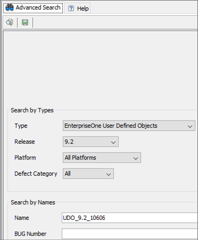

  2. Expand the Search for Packages navigation node to begin searching the Update Center and click Advanced Search.
  3. Enter the following search criteria and click Search.
    • Type: EnterpriseOne User Defined Objects
    • Release: 9.2
    • Name: UDO_9.2_10606
    Description of sample-image-1.png follows
    Advanced Search in Work With Software Updates

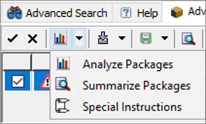

  5. Use the Tool drop-down to select Special Instructions.
    Description of image follows
    Tools Drop-Down - Special Instructions Option

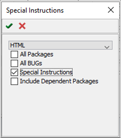

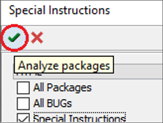

  6. In the Special Instructions options, select Special Instructions
    Special Instructions Option Selection
  7. Click Analyze Packages. When the analysis process finishes, the Summary Analysis Report appears. The system downloads the
    Analyze Packages

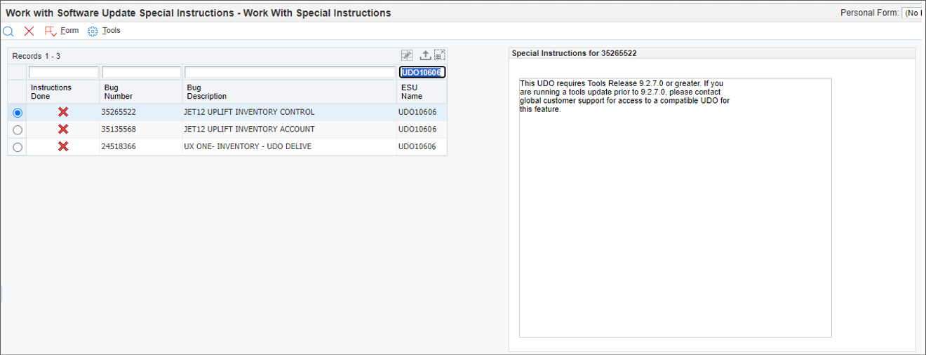

  9. To review the special instructions for the selected UDO package on the Web Client, sign in to the Web Client and run the Work with Software Update Special Instructions (P96700RW ) program from the fast path. Alternatively, you can navigate to Software Updates menu (GH9612) and run the Work with Software Update Special Instructions (P96700RW) program.
    Navigation to the Work with Software Update Special Instructions Form
  10. In the Query by Example (QBE) field, enter the ESU Name UDO10606 and click Find to filter the special instructions.
    Special Instructions for the Filtered ESU
  11. Review the special instructions.

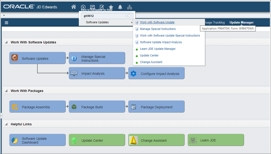

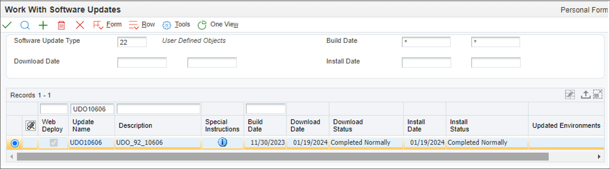

  1. Sign in to EnterpriseOne on the web client.

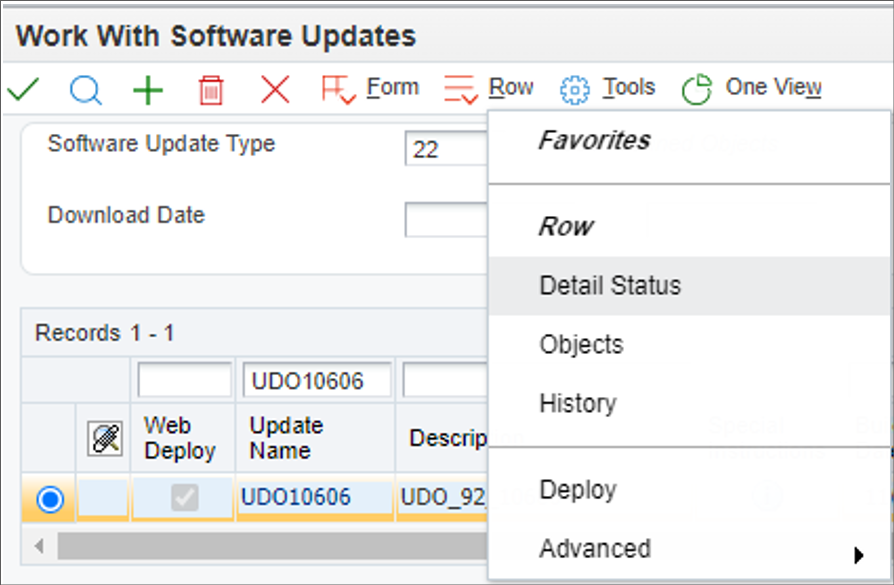

  2. From the Software Updates menu (GH9612), select Work with Software Update application (P96470W).
    Description of sample-image-14.png follows
    Navigation to the Work with Software Updates Form
  3. On the Work With Software Updates form, enter 22 (User Defined Objects) in the Software Update Type field and click Find.
  4. Select the Form menu and click Import.
    Work With Software Updates - Import UDO

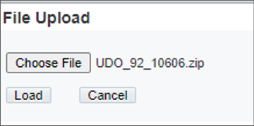

  5. On the File Upload dialog box, click Choose File and select the UDO_92_10606 file you downloaded. Only one UDO can be imported at a time.
    UDO File Upload

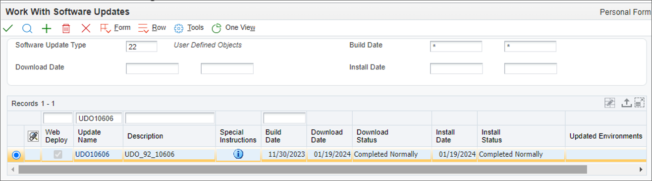

  6. Click Load. The system imports the file and returns to the Work With Software Updates (P96470W) form. The new UDO appears in the grid.
    Work With Software Updates Form - Imported UDO Shown in the Grid

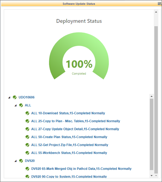

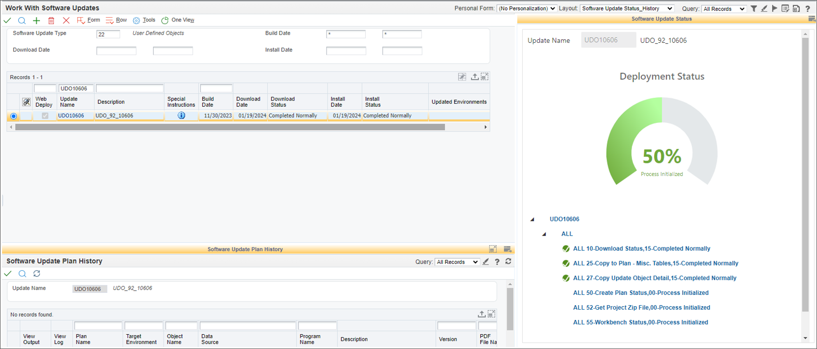

  7. The system also populates the Software Update Status pane on the screen which displays a visual of the deployment status, highlighting the current deployment step and the percentage of updates remaining.
    Work With Software Updates Form - Deployment Status
    Note: If the Software Update Status window does not appear, select Software Update Status_History from the Layout drop-down list.

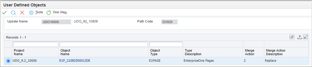

  8. To view objects delivered with this UDO, click the Row menu and select Objects.
    Work With Software Updates Form - Objects Menu Option
    User Defined Objects Form - Objects Delivered with Selected UDO

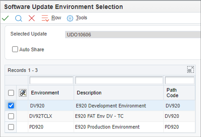

  5. The Software Update Environment Selection form is displayed. The Auto Share check box is NOT selected by default.
    If you select the Auto Share check box, the system promotes the UDO object(s) to the ‘Shared’ (08) status after import and deploy.
    Software Update Environment Selection Form - Auto Share
  6. Select the check box corresponding to the Environment(s) that you want to deploy the UDO UDO10606 to.
    Note: For Trial Edition, use PS920 because DV920 does not exist.

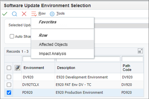

  7. To verify the list of objects that will be applied, click the Row menu and select Affected Objects.
    Software Update Environment Selection Form - Affected Objects Menu Option

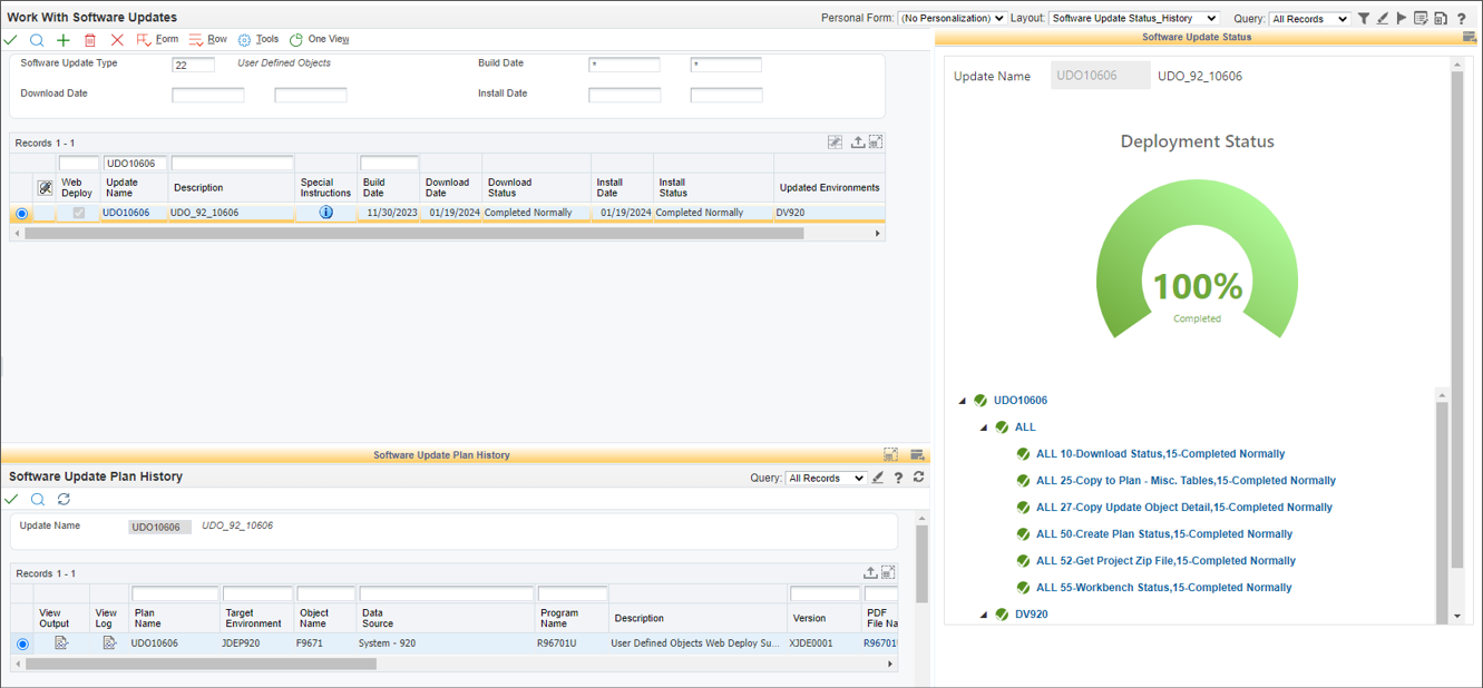

  11. The Software Updates Status on the Work With Software Updates form shows the progress. When the UDO deployment is complete, the system displays 100% Complete status in the Deployment Status.
    Work With Software Updates Form - UDO Deployment Status
    Work With Software Updates Form - UDO Deployment Completion
  12. Click Find on the Work With Software Updates form to refresh the grid columns.
  13. Click Refresh on the Software Update Plan History pane.
    Software Update Plan History Pane

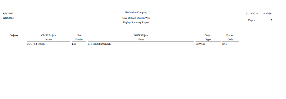

  14. Click the View Output icon in the Grid Column to download the UDO Web Deploy Summary Report.
    UDO Web Deploy Summary Report - OMW Objects

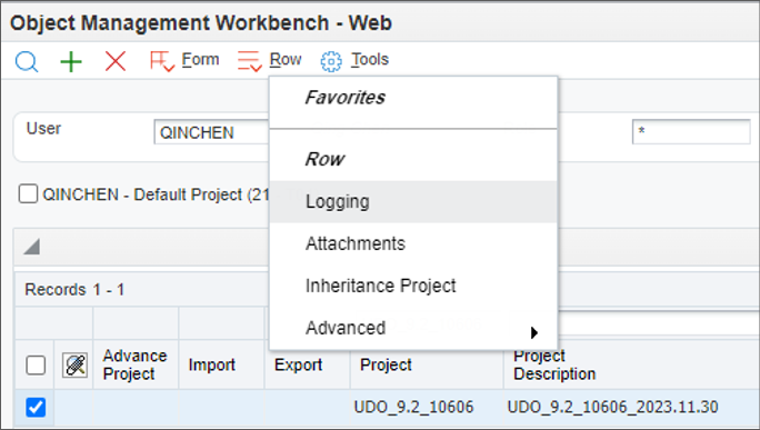

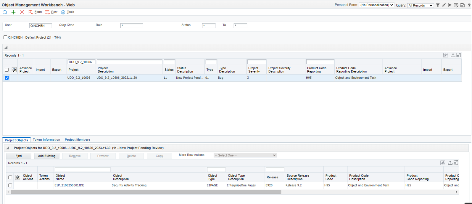

  1. To verify the UDO deployment using Web OMW, run the Object Management Workbench – Web application (P98220W).
  2. Search for the UDO Project UDO_9.2_10606 and click Find. The system displays the deployed objects in the Project Objects tab.
    Object Management Workbench - Web Form
  3. Select Logging from the Row menu.
    Object Management Workbench - Web Form - Logging Menu Option

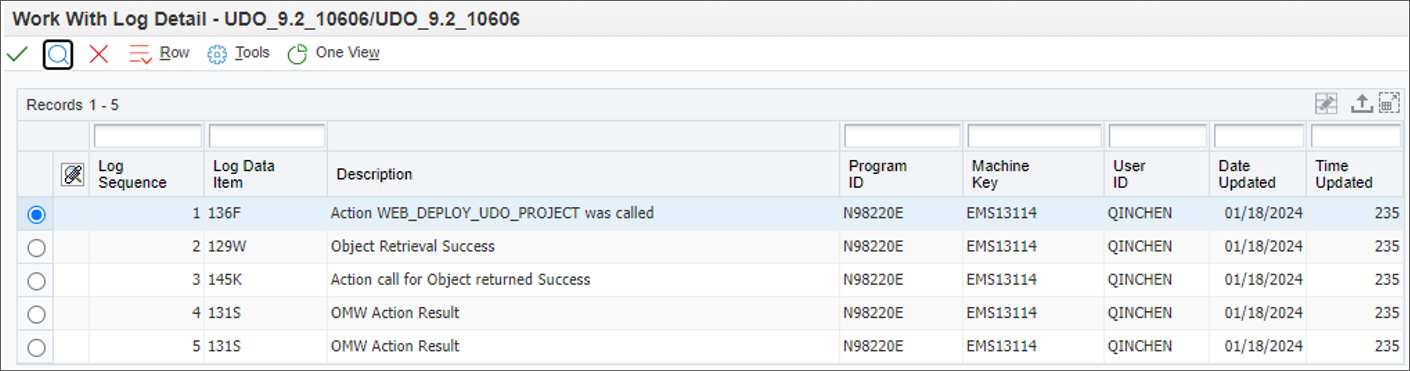

  4. Click Find on the Work With Project Logs form.
  5. Click the log data item and view the log detail.
    Work With Log Detail Form

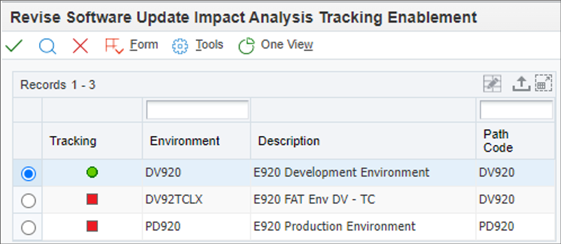

    Enable Impact Analysis environment tracking from the Work With Software Updates application (P96470W).

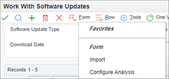

  1. Click Configure Analysis from the Form menu. The Revise Software Update Impact Analysis Tracking Enablement form is displayed.
    Work With Software Updates Form - Import Menu Option
  2. Select the tracking environment and click OK.
    Revise Software Update Impact Analysis Tracking Enablement Form

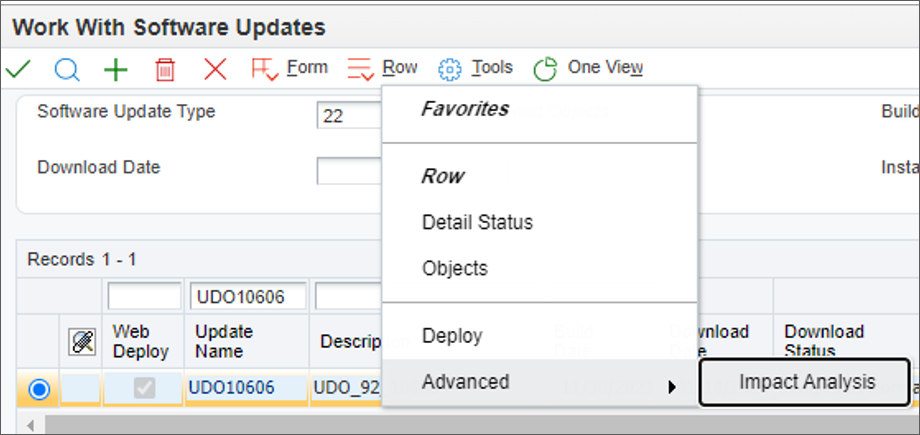

  3. On the Work With Software Updates form, select Advanced and Impact Analysis from the Row menu. The Work With User Defined Object Impact Analysis form is displayed.
    Note: If Impact Analysis Tracking is enabled for the environment, the system populates the Impact Analysis data (F96710) during Add and Import, and displays the Impact Analysis option when you select Advanced option from the Row menu.
    Work With Software Updates Form - Impact Analysis Menu Option

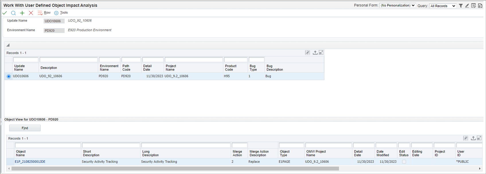

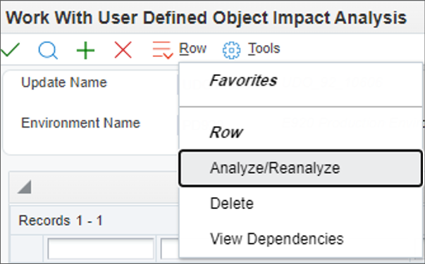

    Work With User Defined Object Impact Analysis Form
  5. On the Work With User Defined Object Impact Analysis form, click View Dependencies from the Row menu. The Work with Project Object Dependencies form is displayed.
    Work With User Defined Object Impact Analysis - View Dependencies Menu Option

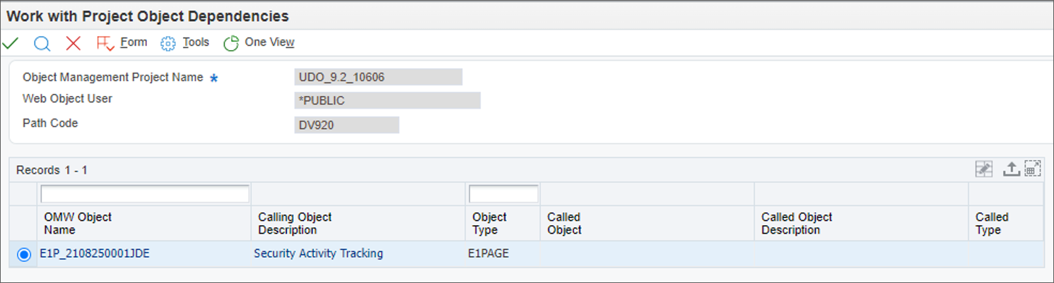

    If there is a dependent UDO for the project (UDO_9.2_10606), it is displayed in the grid.
    Work with Project Object Dependencies Form
