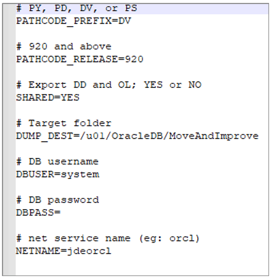

  3. Edit the exp_set file with these settings.
    The exp_set file
    The exp_set file
    Field Description
    PATHCODE_PREFIX The prefix of the path code to export. Enter DV.
    Valid values are PY, PD, and DV.
    PATHCODE_RELEASE The path code release to export. Enter 920.
    SHARED Export data dictionary schema. Enter YES to export data dictionary.
    Otherwise enter NO.
    DUMP_DEST The full path to the folder where you want to store the database dump files. Enter /u01/OracleDB/MoveAndImprove.
    *Ensure the directory exists*
    DBUSER The database user with privileges to perform EXPDP operations. Enter system.
    DBPASS The password for DBUSER. Enter the system password.
    Note: If your database password contains any allowable special character like $ you must put single quotes around the database password in both the exp_set and the imp_set files. For example, if your database password includes a $ symbol, you would specify this value like this:
    DBPASS='Hello$123'
    NETNAME The TNS name for the database (for example, enter orcl).
  4. Save and close exp_set.

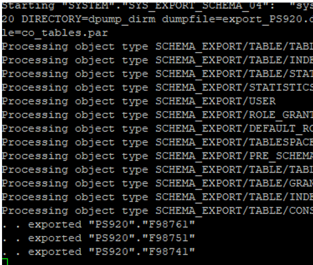

  5. Run the export.sh script.
    The exp_set file
    export.sh
  6. Verify that successfully completed is found in all generated log files.
  7. Verify that the .dmp files were successfully created in the specified location.

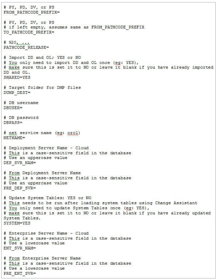

  3. Open the import folder and edit the imp_set file.
    The exp_set file
    The imp_set file
    Field Description
    FROM_PATHCODE_PREFIX The prefix of the path code you exported on the on-premises Database Server. Enter DV.
    TO_PATHCODE_PREFIX The prefix of the target path code on Oracle Cloud Database Server.
    Can be the same or different from FROM_PATHCODE_PREFIX.
    PATHCODE_RELEASE Enter 920. Do not change.
    SHARED Enter YES to import data dictionary. You only need to import the data dictionary once.
    Otherwise enter NO.
    DUMP_DEST The full path to the folder where you copied the database dump files. Enter /u01/OracleDB/MoveAndImprove.
    DBUSER The database user with privilege to perform IMPDP operations.
    DBPASS='Hello$123'
    DEP_SVR_NAM The name of the Oracle Cloud Deployment Server in uppercase.
    PRE_DEP_SVR The name of the on-premises Deployment Server in uppercase.
    SYSTEM Enter YES. This should only be imported once.
    ENT_SVR_NAM Oracle cloud enterprise server name. Match the case as the name in the SY920.F9650 table.
    PRE_ENT_SVR On-Premises Enterprise Server name. Match the case as the name in the SY920.F9650 table in the on-premises Enterprise Server.

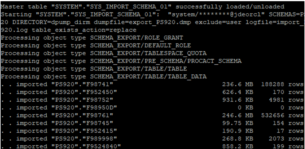

  4. Switch (su) to your oracle user and navigate to your scripts folder.
  5. Run the import.sh. Logs are created in the dump directory. Check the logs to ensure that the import was successful.
    The exp_set file
    import.sh
