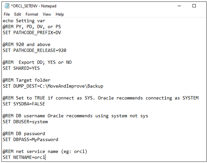

  4. Open the export folder and edit the ORCL_SETENV.bat file with these settings.
    The ORCL_SETENV.bat file
    The ORCL_SETENV.bat File
    Field Description
    SET PATHCODE_PREFIX The prefix of the path code from which to export. Enter DV.
    Valid values are PY, PD, and DV.
    SET PATHCODE_RELEASE The path code release to which to export. Enter 920.
    SET SHARED Export data dictionary. Enter YES to export data dictionary.
    Otherwise enter NO. Only needs to be done once.
    SET DUMP_DEST The full path to the folder where you want to store the database dump files. Enter c:\MoveAndImprove\Backup.
    *Ensure the directory exists*
    SET SYSDBA
    Enter TRUE if you are connected as Database Administrator.
    SET DBUSER
    The database user with privileges to the schemas being inserted. Enter system.
    Valid values are system and sysdba.
    SET DBPASS The password for DBUSER. Enter the system password.
    SET NETNAME The net service name or connecting string for the database (for example, enter orcl).

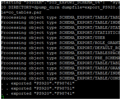

  5. In the command window, navigate to your scripts folder.
  6. Run ORCL_EXPORT.bat.
    The exp_set file
    ORCL_EXPORT.bat
  7. Verify that all the generated log files are successfully completed.
  8. Verify that the .dmp files were successfully created in the specified location.

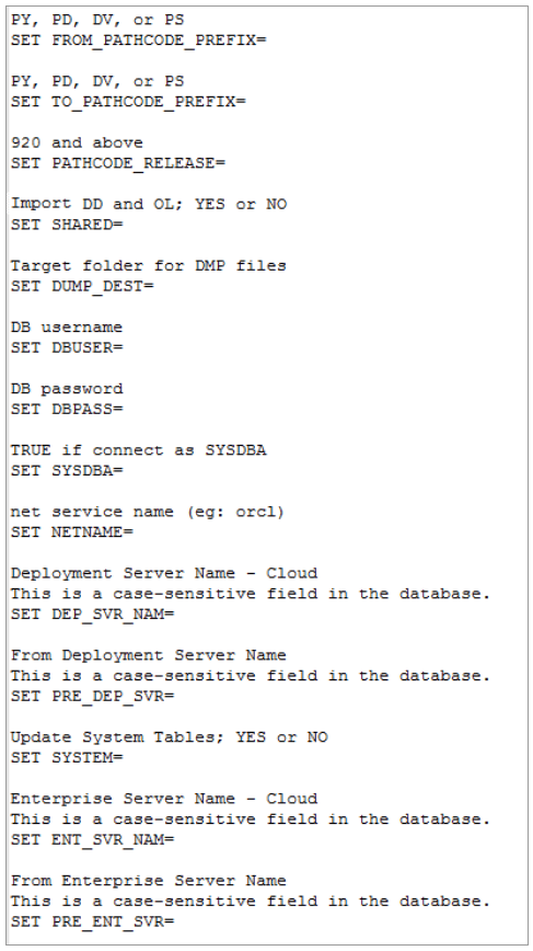

  4. Open the import folder and edit the ORCL_SETENV.bat file.
    Field Description
    SET FROM_PATHCODE_PREFIX The prefix of the path code you exported on the on-premises database server. Enter DV.
    SET TO_PATHCODE_PREFIX The prefix of the target path code on Oracle Cloud Database Server. Enter PY, PD, or DV.
    Can be the same or different from FROM_PATHCODE_PREFIX.
    SET_PATHCODE_RELEASE Enter 920. Do not change.
    SET SHARED Enter YES to import data dictionary. You only need to import the data dictionary once.
    Otherwise enter NO.
    SET DUMP_DEST The full path to the folder where you copied the database dump files. Example, C:\MoveAndImprove.
    SET DBUSER The database user with privileges to perform IMPDP operations. Oracle recommends to use system.
    Note: If your database password contains any allowable special character like $ you must put single quotes around the database password in both the exp_set and the imp_set files. For example, if your database password includes a $ symbol, you would specify this value like this:
    DBPASS=Hello$123
    SET SYSDBA TRUE must be used if connected as SYSDBA. Else, enter FALSE.
    SET NETNAME The TNS name for the database (for example, JDEORCL).
    SET DEP_SVR_NAM The name of your Oracle Cloud deployment server in uppercase.
    SET PRE_DEP_SVR The name of the on-premises deployment server in uppercase.
    SET SYSTEM Enter YES to update machine names in tables in JDE920.
    SET ENT_SVR_NAM The name of your new Oracle Cloud Enterprise Server. Match the case as the name in the SY920.F9650 table.
    SET PRE_ENT_SVR The name of your old on-premises enterprise server. Match the case as the name in the SY920.F9650 table in the on-premises enterprise server.

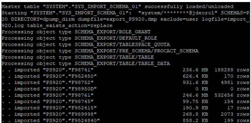

  5. In the command window, navigate to your scripts folder and run ORCL_IMPORT.bat.
    The script runs and creates logs in the dump directory. Verify that all the generated log files are successfully completed.
