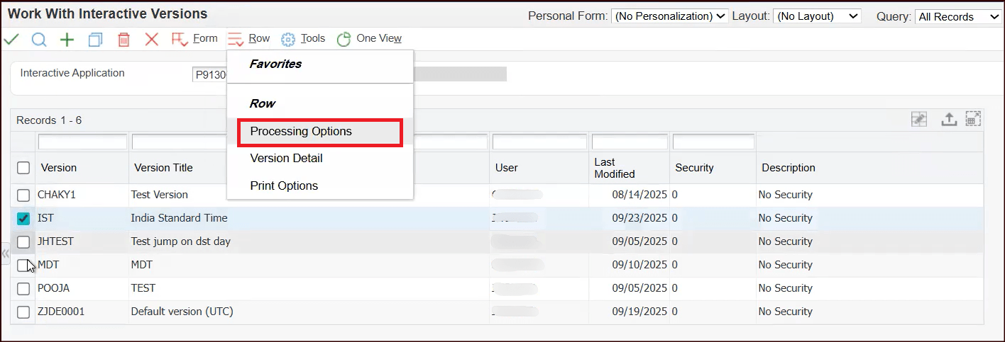

Create an Interactive Version of P91300W
For the purpose of this OBE, you will create a version of Webify Scheduler (P91300W) named IST (Indian Standard Time) using time zone 14 and no daylight saving to reflect IST:
- Enter
IV
in the Fast Path to access the Work With Interactive Versions form. - Enter
P91300W
in the Interactive Application field and click Find. - Click Add to create a new version.
- On the Add Interactive Application Version form, add the
Version as
IST
and Version Title asIndian Standard Time
and click OK. For more information on the fields in this form, see Creating (Adding) an Interactive Version. - On the Work With Interactive Versions form, select IST in the grid and then select Processing Options from the Row menu.
- On the Display tab, set View Local Time value to
2
and set the Local Time Zone value to14
for IST. - Set up the other processing options as required. For more information, see Setting Processing Options for the Job Scheduler.

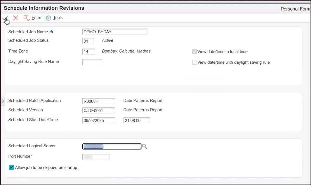

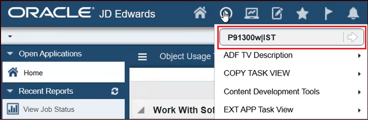

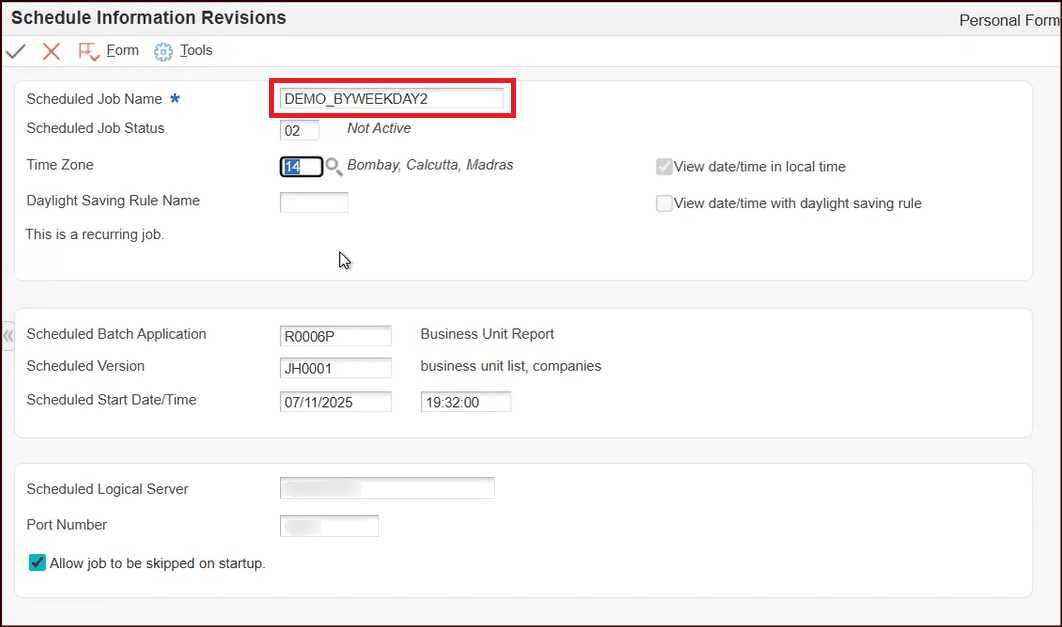

- Enter
P91300W|IST
in the Fast Path to access the web version of the Work With Scheduled Jobs form for the Indian Standard Time (IST) timezone.Fast Path to P91300W - On the Work With Schedule Jobs form, click Add.

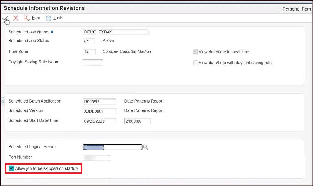

Work With Scheduled Jobs Form - On the Schedule Information Revisions form, in the Scheduled
Job Name field, enter
DEMO_BYDAY
.Note:
Enter a name that uniquely identifies to the system and the user of a scheduled job. Use this name to indicate the job function, such as Monthly Close or Nightly BackUp.Schedule Information Revisions Form - In the Scheduled Job Status field, select the status of
the scheduled job.
As long as the status is Active, the Scheduler determines if the job should be submitted to the server for processing. When the scheduled end date for the job is reached, no more occurrences are created in the Job Schedule table (F91320). The job header in F91300 remains in the active status and can be edited to add more occurrences.To stop the Scheduler from running the job, you can change the status to Inactive at any time prior to the end date. You can reactivate the job if you want the Scheduler to include the job again.
- If the job is not set to skip jobs on reactivation, all previous missed instances will be run.
- If the job is set to skip jobs on reactivation, the scheduler will run only the most recent pending instance and skip the others. It will then continue scheduling future jobs if the job has not past its end date (if an end date is defined).
- In the Scheduled Batch Application field, specify the object name of the report that the Scheduler submits to the server.
- In the Scheduled Version field, specify the version of the report that is scheduled to run. A version identifies a specific set of data selections and sequencing settings that the batch job uses.
- In the Scheduled Start Date/Time field, determine the next date on which the Scheduler submits the scheduled job to the server for execution.
- In the Scheduler Logical Server field, select the logical data source of the server where the scheduler kernel submits the job. This server may not be the server running the scheduler kernel.
- Enter the Port Number.

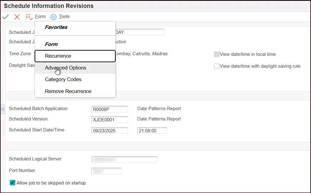

- Select the Allow job to be skipped on startup checkbox to skip missed instances of the job.

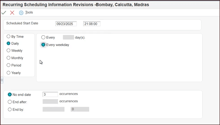

- Select Recurrence from the Form menu.
- In the Recurring Scheduling Information Revisions form,
set the Scheduled Start Date and the frequency of the schedule.
Recurring Scheduling Information Revisions Form - Click OK.
- On the Schedule Information Revisions form, click OK to schedule the job.

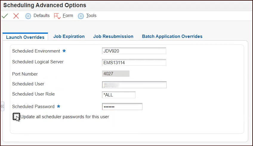

Task 2: Updating All Scheduler Passwords for the User
When setting up or changing the job schedule password for a user, you can enable the option to simultaneously update all associated job passwords for that user in the scheduler table. This option makes it easier for you to manage job passwords when using external login security such as LDAP.

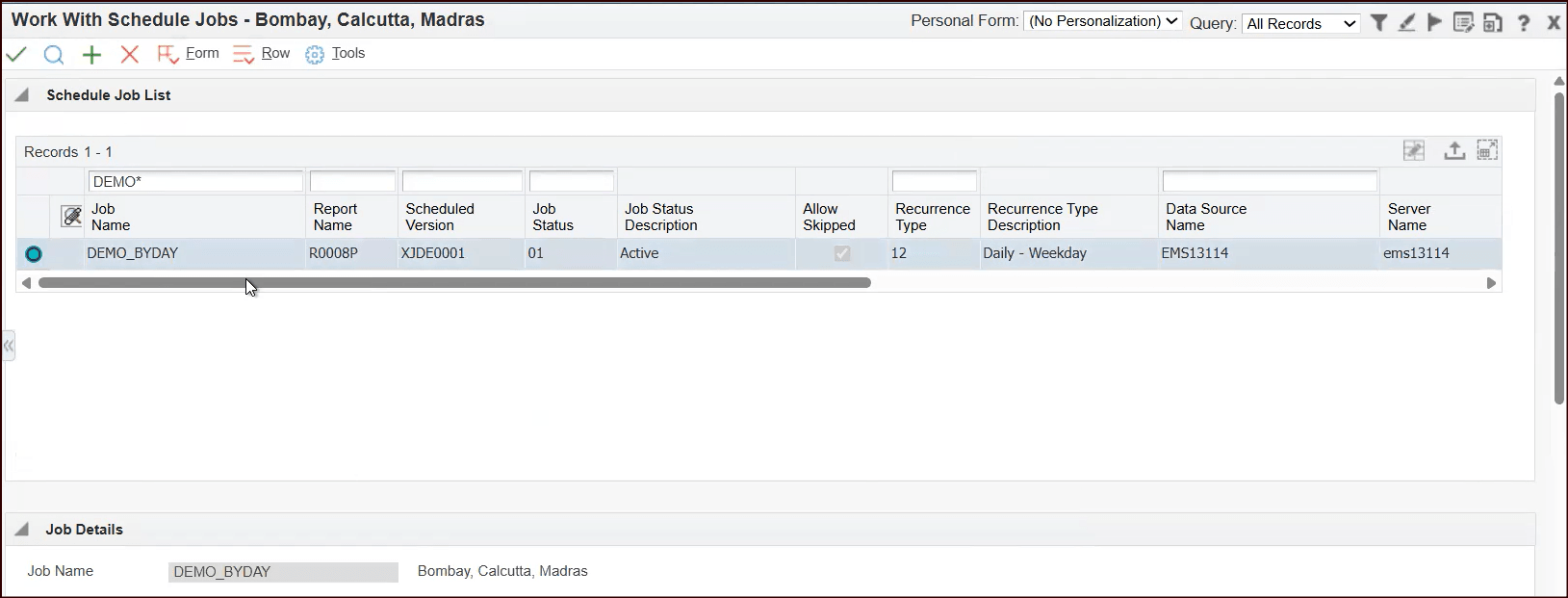

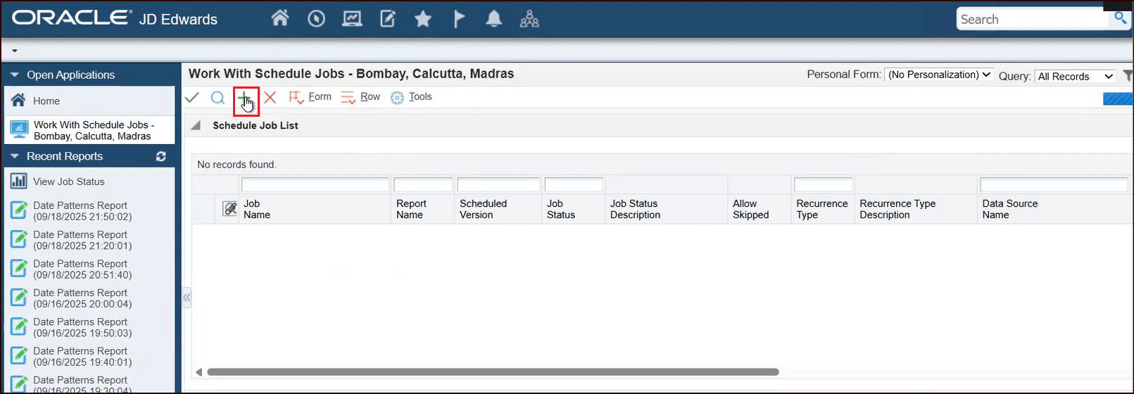

- Access the Work With Schedule Jobs form.
- On the Work With Schedule Jobs form, select the job
schedule you created
DEMO_BYDAY
and click OK.Work With Schedule Jobs Form - On the Schedule Information Revisions form, select Advanced
Schedule Information Revisions Form - Advanced Options - On the Scheduling Advanced Options form, select the Launch Overrides tab.
- Select the Launch Overrides tab.
- Select the Update all scheduler passwords for this user checkbox.
Scheduling Advanced Options Form - Launch Overrides Tab - Click OK.

and click OK.Work With Schedule Jobs Form - On the Schedule Information Revisions form, select the Allow
job to be skipped at startup checkbox.

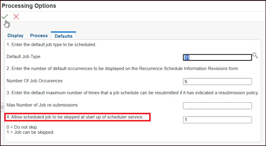

- In the processing options for Webify Scheduler (P91300W),
go to Defaults tab.
Work With Interactive Versions Form - Set the value for Allow scheduled job to be skipped at start
up of scheduler service to
1
.P91300W Processing Options - Defaults Tab

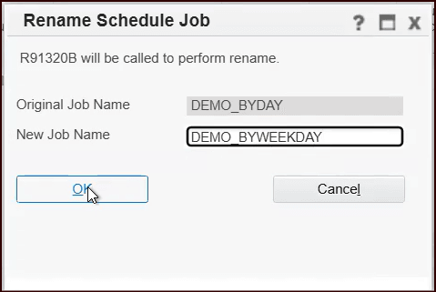

Task 4: Renaming the Scheduled Job
In the renaming process, the system first changes the status of the
job in the Schedule Job Master table (F91300) to 03
(Rename job is processing) and then renames the job records in the
Schedule Job Master table (F91300), Scheduled Job Parameters table
(F91310), Job Schedule table (F91320), and the Scheduled Job
Override Print Info table (F91330).

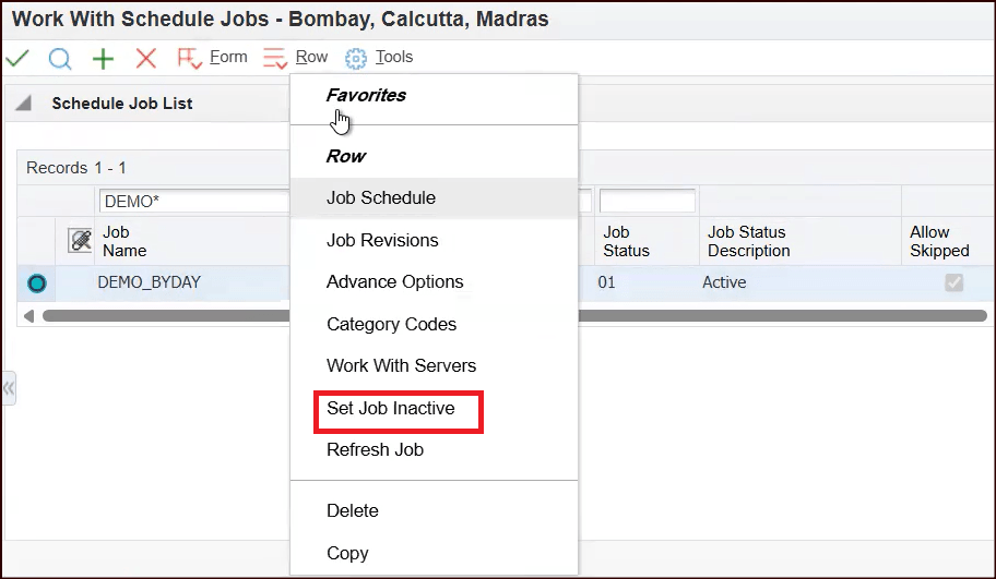

Work With Schedule Jobs Form - Select the job from the grid and select Set Job Inactive
from the Row menu.

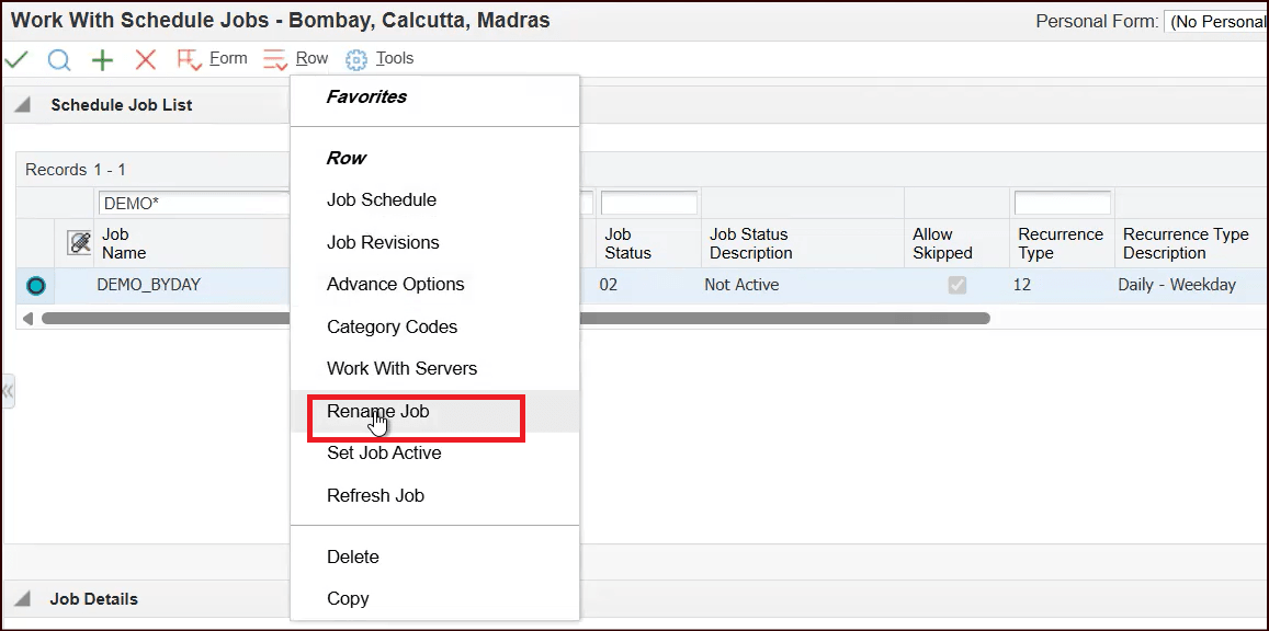

Work With Schedule Jobs Form - Set Job Inactive - Select Rename Job from the Row menu.
Work With Schedule Jobs Form - Rename Job - On the Rename Schedule Job form, enter the new job name
DEMO_BYWEEKDAY
.Rename Schedule Job Form - Click OK. The job is renamed and the status of the job
is set back to
02

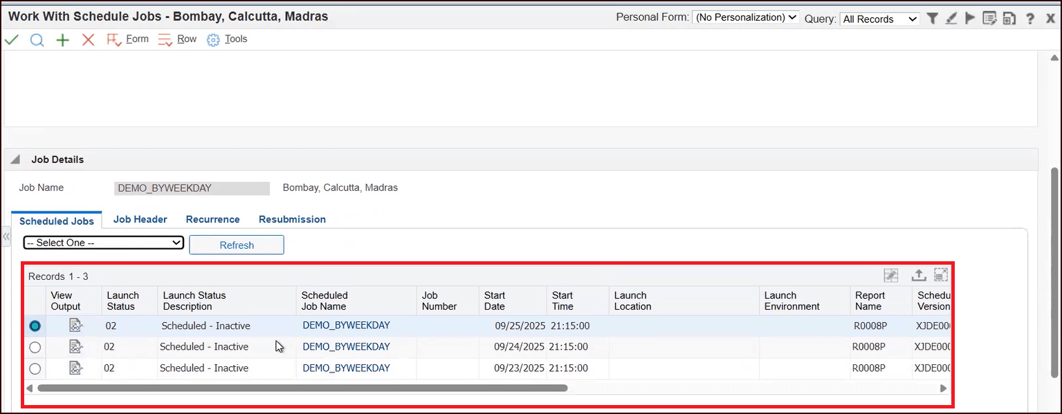

(Scheduled - Inactive). - On the Work With Schedule Jobs form, review the
scheduled jobs for the renamed job in the Scheduled Jobs
tab of the Job Details pane.
Work With Schedule Jobs - Renamed Schedules Jobs

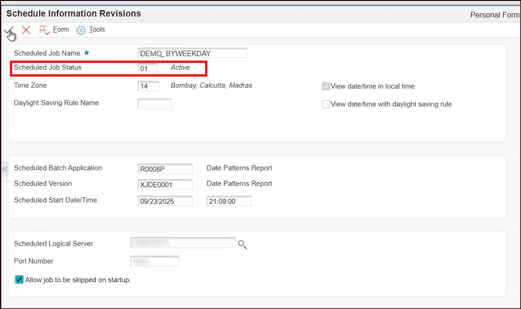

Task 5: Revising the Status of the Scheduled Job
You can change the status of a scheduled job to inactive if you do
not want the job to be processed.
DEMO_BYWEEKDAY
, and then select Job Revisions from the Row menu.
- On the Schedule Information Revisions form, modify the Scheduled
Job Status as necessary.
Schedule Information Revisions Form - Click OK.
These advanced job schedule statuses in the help in improving the performance of the Scheduler Kernel.02
– Scheduled – Inactive (inactive jobs with scheduled instances)19
– Job terminated by user31
– Skipped on scheduler startup32
– Job not found by monitor33
– Skipped on job activation (If a job is set status33
, the most recent of the scheduled job occurrences run immediately while the others are set to status31
or32
.)34
– Orphaned (jobs without a matching P91300 record)

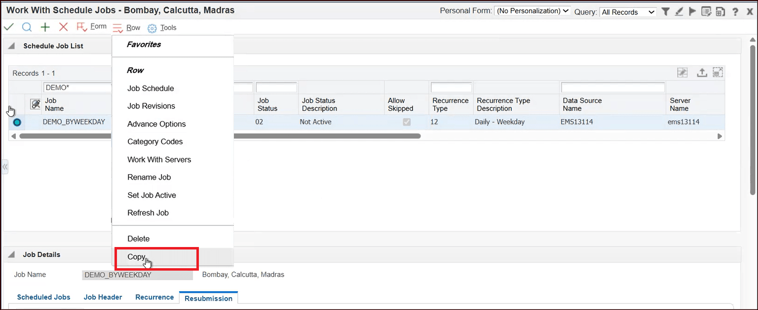

Task 6: Copying the Scheduled Job
To copy the job DEMO_BYWEEKDAY
you created and create
a new job schedule with the same time and occurrence information:
DEMO_BYWEEKDAY
, and then select Copy from the Row menu. The system creates a new job schedule using the information fromDEMO_BYWEEKDAY
.Work With Schedule Jobs Form - On the Schedule Information Revisions form, enter the
Scheduled Job Name and revise the job schedule as required.
Schedule Information Revisions Form - Modify other characteristics of the job being copied, such as Scheduler Batch Application, as desired.
- Click OK.

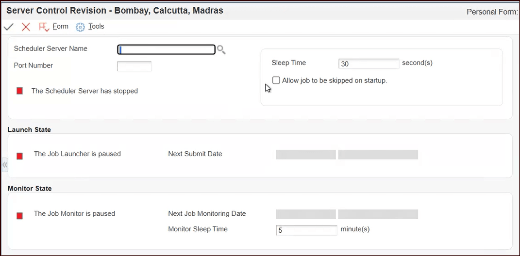

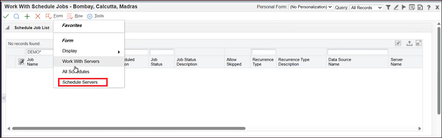

Task 7: Managing the Scheduler Servers

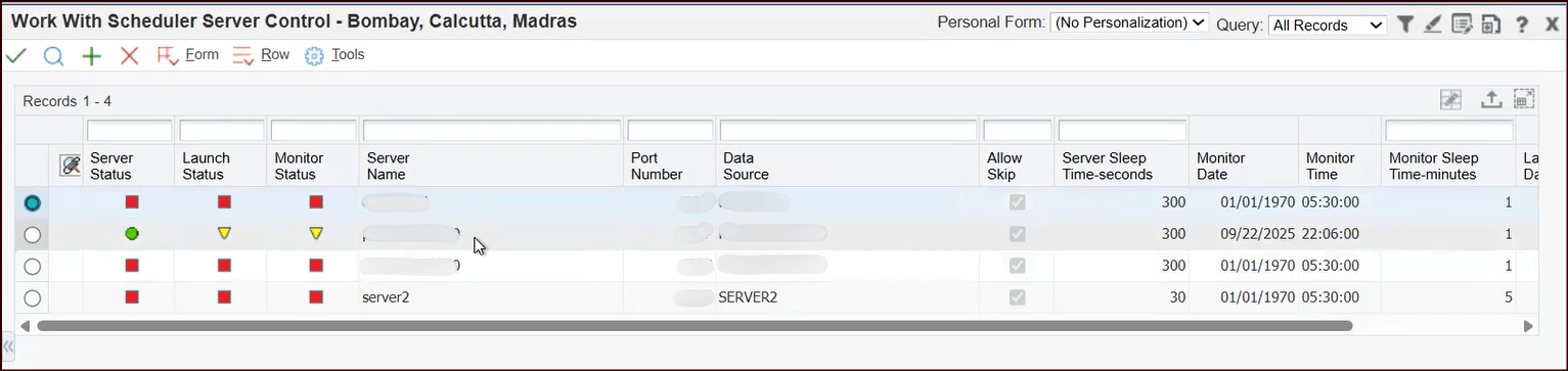

You can view all the server and port number combinations on the web-based Work With Scheduler Server Control form (P91301W). The multi-foundation scheduler kernel allows to have multiple servers on the same port and multiple instances of ports on the same machine.
- On the Work With Schedule Jobs form, select Schedule
Servers from the Row menu to access the Work With
Work With Schedule Jobs Form - Click Find on the Work With Scheduler Server Control
form, to view all the server and port number combinations.
Work With Scheduler Server Control Form - To start a server, select the server on the grid and then select Start Scheduler from the Row menu.
- To stop a server, select the server on the grid and then select Stop Scheduler from the Row menu.
- To add a new server, click Add on the Work With Scheduler Server Control form.
- On the Server Control Revisions form, enter the Scheduler
Server Name and Port Number details and click OK.
