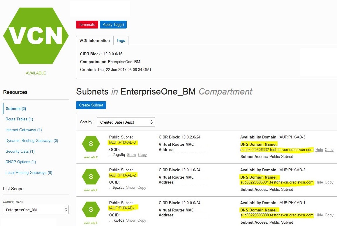

Edit the resolv.conf File to Specify the DNS Domain Name
You must ensure that the search setting in the /etc/resolv.conf file specifies the DNS domain name of the Availability Domain to which all JD Edwards EnterpriseOne servers belong. While logged in as the root user (the owner of the resolv.conf file), you must add a line with the following syntax to the resolv.conf file:
$ vi /etc/resolv.conf
search <DNS_Domain_Name> <subnet1> <subnet2> <subnet3>.<DNS_Domain_Name>
Generally each Availability Domain contains at least three subnets. You must include an exact search string for each of those subnets.
For example, your subnets can look like this:
Using the above example, assuming that your JD Edwards EnterpriseOne Servers are running in the Phoenix Availability Domain, you would edit your /etc/resolve.conf file to add a line with a search setting similar to the setting provided below to include all the three domains:
search testdnsvcn.oraclevcn.com sub06220506330.testdnsvcn.oraclevcn.com sub06220506331.testdnsvcn.oraclevcn.com sub06220506332.testdnsvcn.oraclevcn.com
