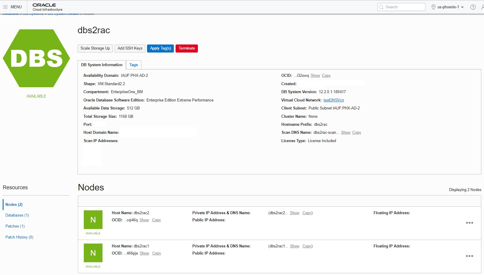

To view details of the Secondary Node in RAC:
  1. On the Oracle Cloud Infrastructure Console Home page, click the Navigation Menu in the upper-left corner.
    navigation_menu
  2. From the Navigation Menu, in the Database section, click to select Bare Metal, VM, and Exadata.
  3. In the left panel ensure that DB Systems is selected, and that under List Scope that the applicable COMPARTMENT is selected which contains the DB System with RAC that you created.
  4. Click the link for your DB System with RAC.
  5. In the Resources section in the left pane, click Nodes.
    Details for two Nodes are displayed as shown below:
    nodes_detail
