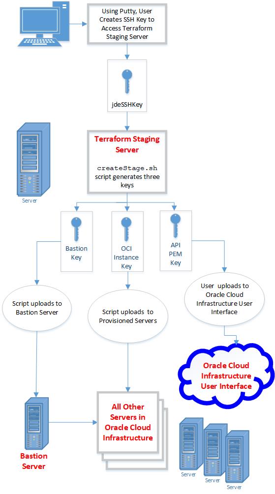

The following diagram illustrates the security key architecture used by JD Edwards Infrastructure Provisioning.
architecture

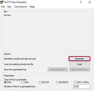

    1. On the PuTTY Key Generator window, accept the default key type, SSH-2 RSA, and in the Number of bits in a generated key: field, ensure that the value is set to 2048.
    2. Click the Generate button.
      generateputty

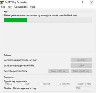

    3. After you click the Generate button, move your mouse around the blank area to generate randomness for the SSH key pair you generate.
      sshkey

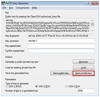

    1. In the PuTTY Key Generator dialog box, click the Save private key button to save your private key to the system.
      saveprivatekey

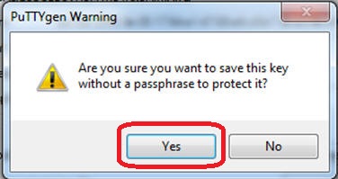

    2. On the PuTTYgen Warning dialog box, click the Yes button to confirm that you want to create the private key without a passphrase.
      puttygenwarning

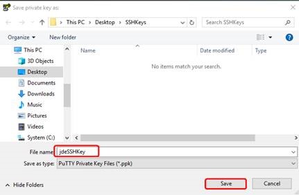

      Important: When you save this key to the local file system, you should give it a significant name such as like jdeSSHKey.ppk. It is also important that you ensure that this key has a .ppk extension.
      saveppk
