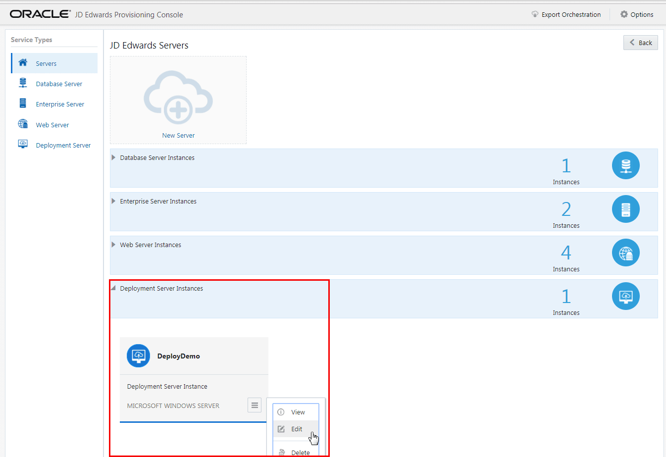

  5. Deployment Server
    A single Deployment Server can be created and all the pathcodes can be selected regardless of the pathcodes selected for your runtime servers.
    For any orchestration created or modified using the Advanced Mode Deployment Plan, you can click the Options function from the menu bar to change your global settings or to reset your settings (that is, to delete your configuration details, global settings, and orchestration data).

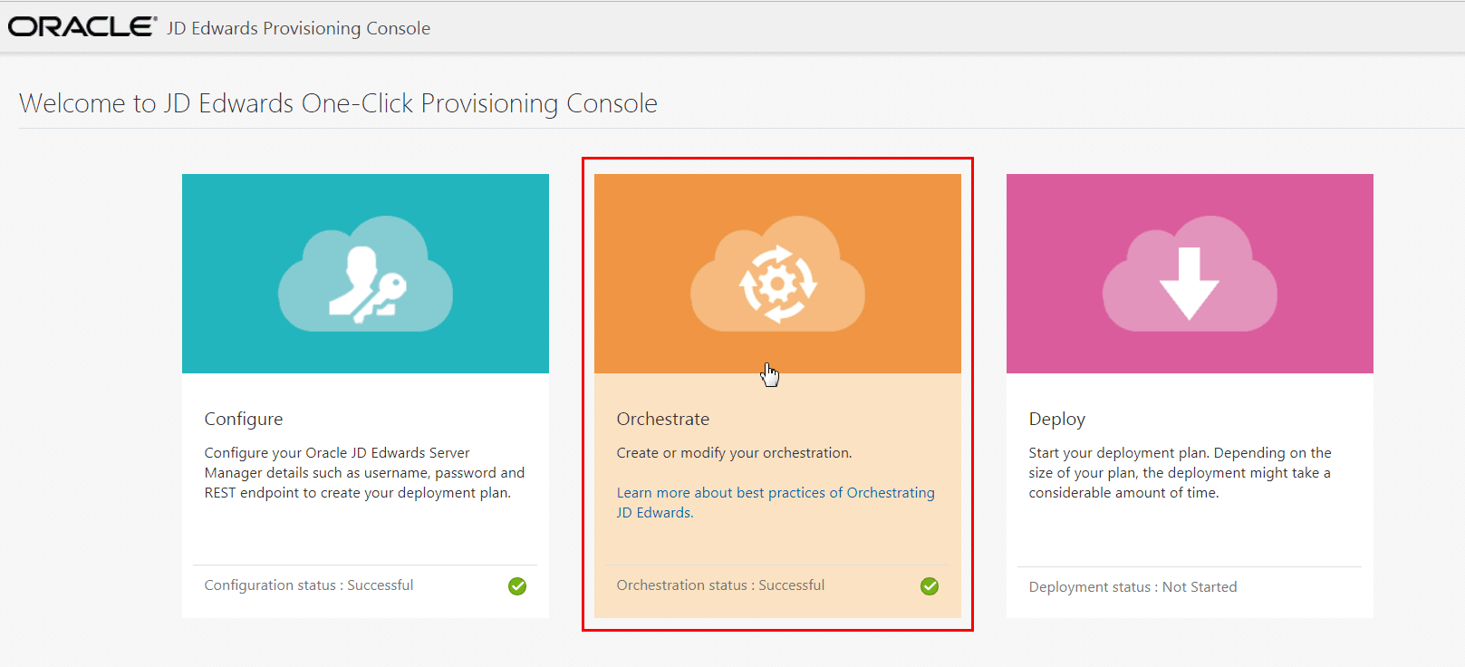

  1. On the JD Edwards Provisioning Console page, click the Orchestrate icon.
    This image shows the Orchestrate tile in the JD Edwards Provisioning Console.

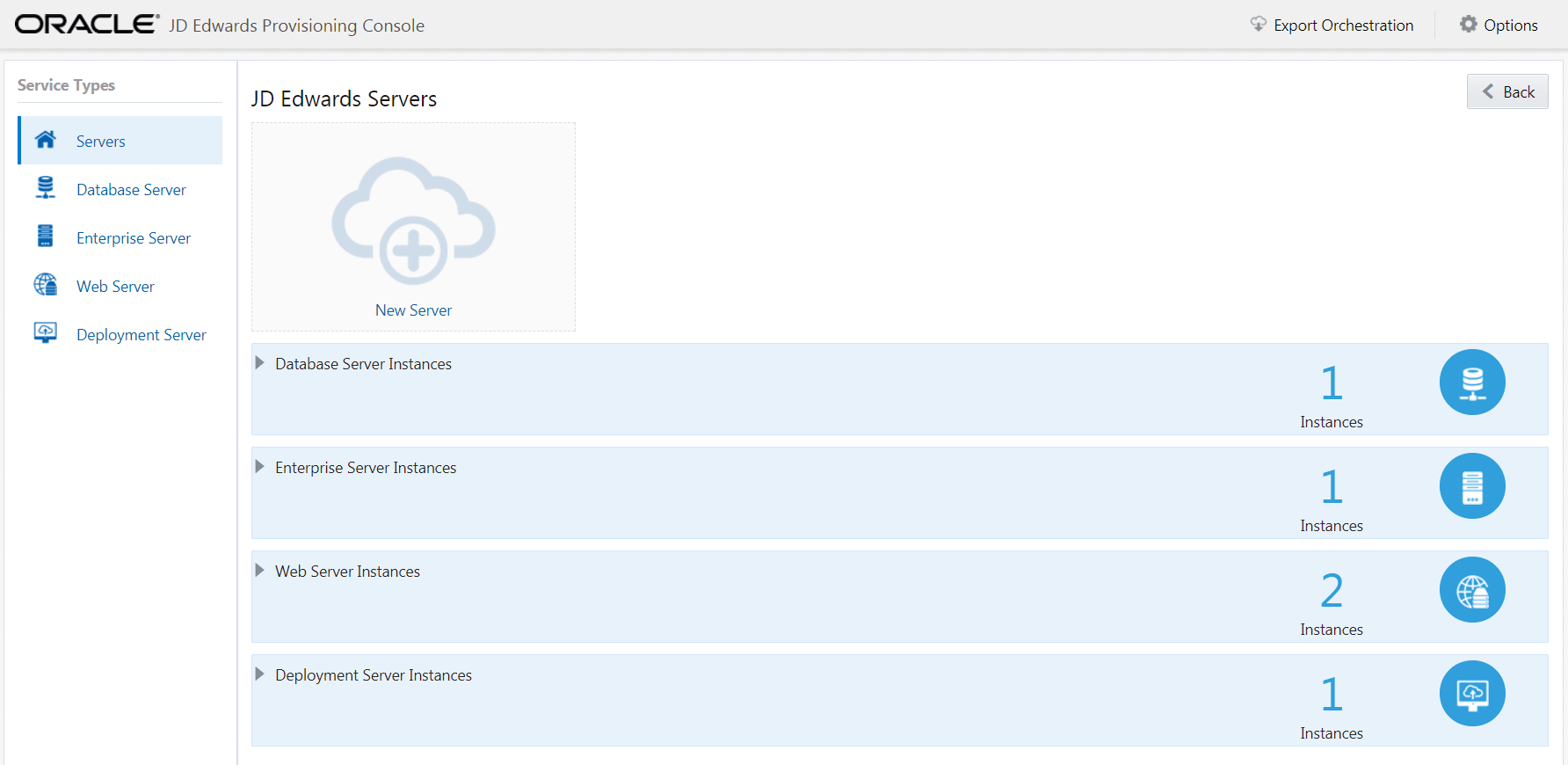

  2. On the JD Edwards Servers page, click the instance of an existing server, or click the New Server icon to add a new JD Edwards service. Alternatively, you can select the desired server from Service Types on the left tab, and then click New Server to add a new server.
    This image shows the JD Edwards Servers pages that contains the details of the Enterprise Servers you provisioned.
    The remainder of this procedure includes steps to either add (where allowed) or modify (existing) these instances:

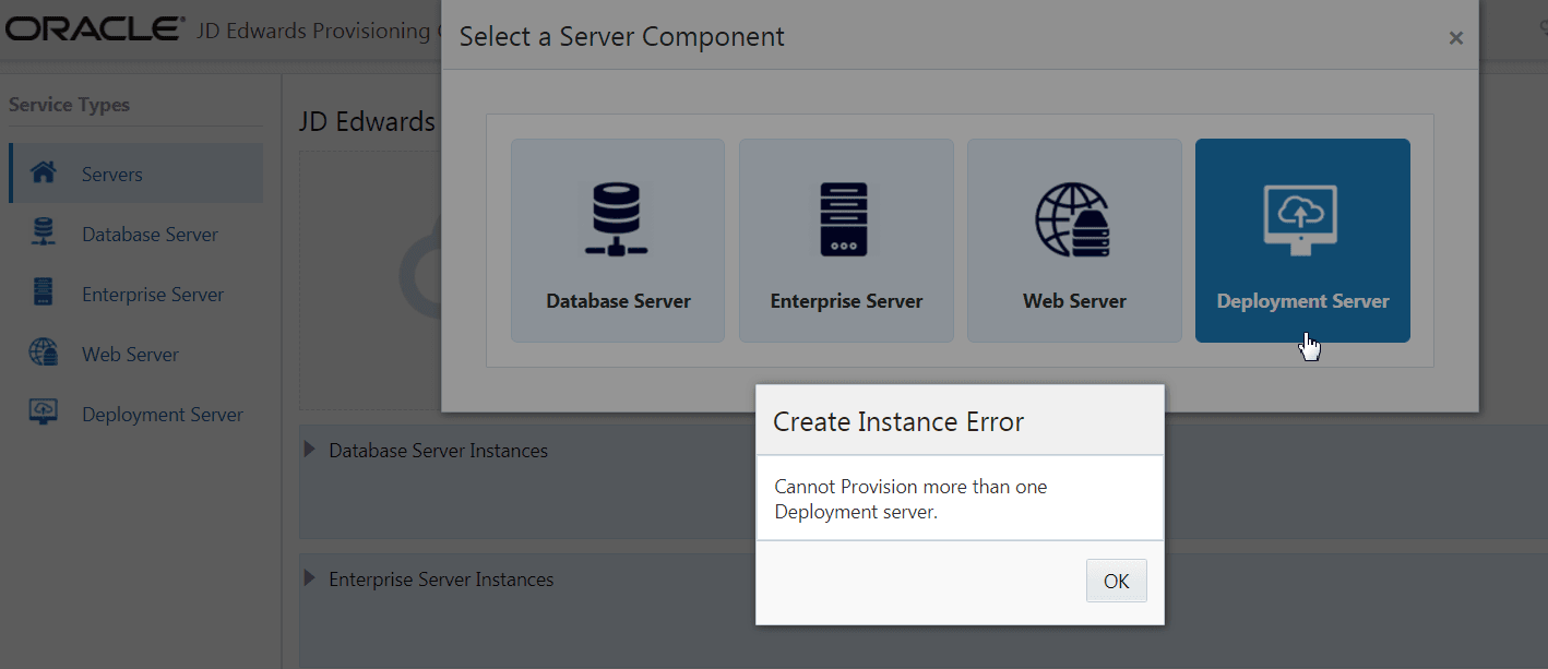

    • Deployment Server*
    * The Provisioning Console will not allow you to add more than one of these server types because only one server of this type is supported per deployment.

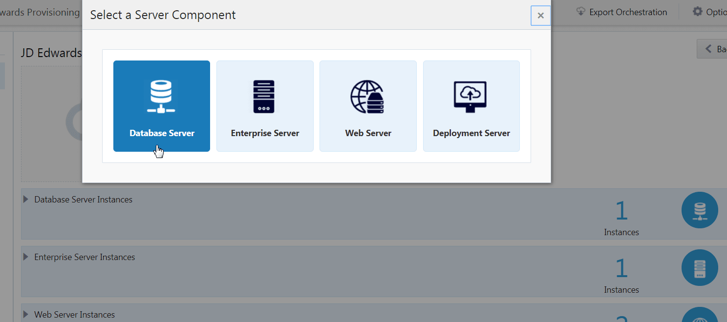

To add a Database Server instance:
  1. Click the New Server icon and select Database Server from the Select a Server Component window.This image shows the Select a Server Component window, and the Database Server icon is selected.
  2. On Database Server Instance page, complete the following fields to create and configure the Database Server instance.

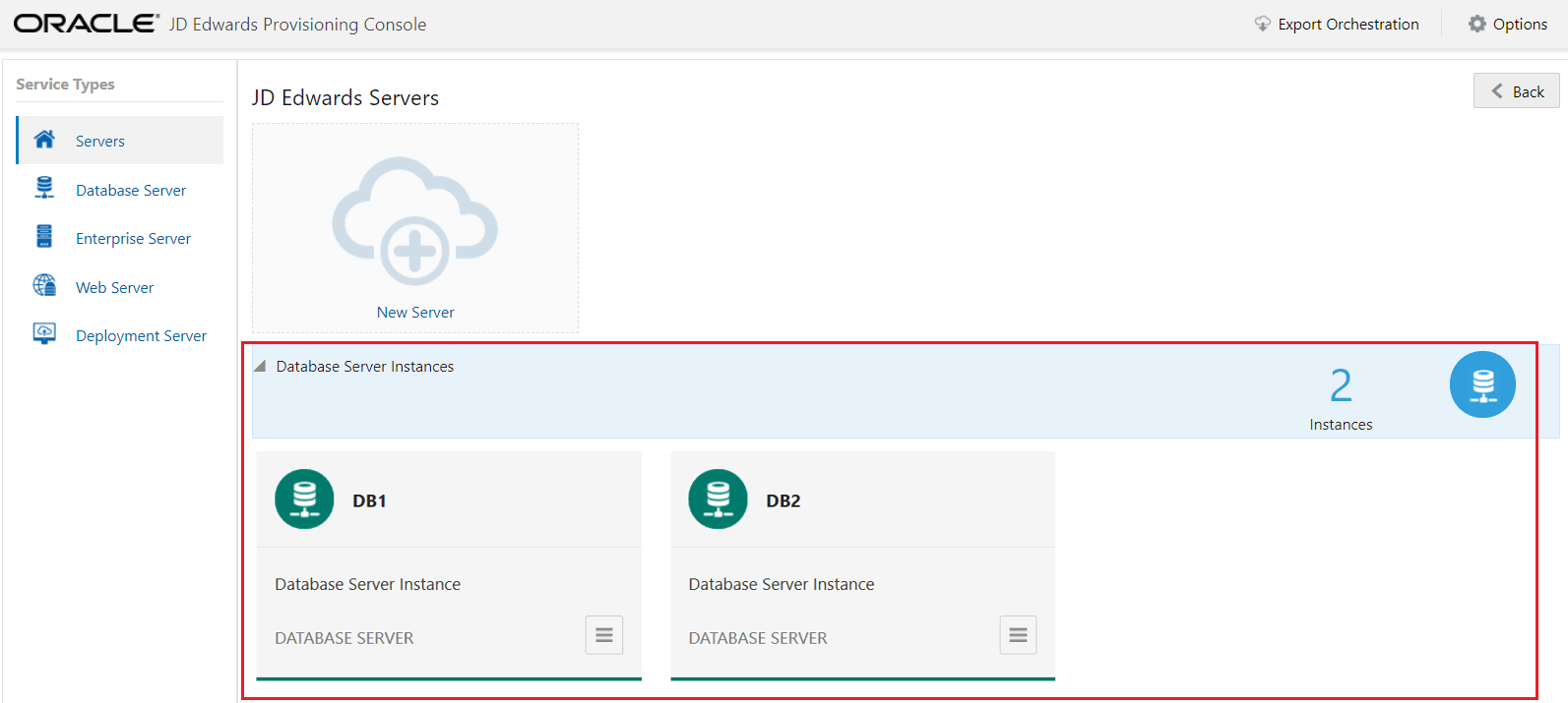

      This image shows Database Server Instance window.
    You should now be able to view multiple instances of the Database Server.This image shows multiple instances of the database servers.

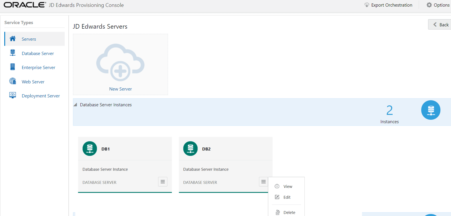

  3. Click View from the Application Options menu to view the existing configuration for the Database Server. To modify the instance configuration, select the Edit option from use the Application Options menu and choose.
    Important:
    The Provisioning Console for One-Click Provisioning allows you to edit the schemas and demo data settings for an existing Database Server post-deployment.
    This image shows the View, Edit, and Delete options of the newly created instance.
  4. To delete the instance, select the Delete option from the Application Options menu.

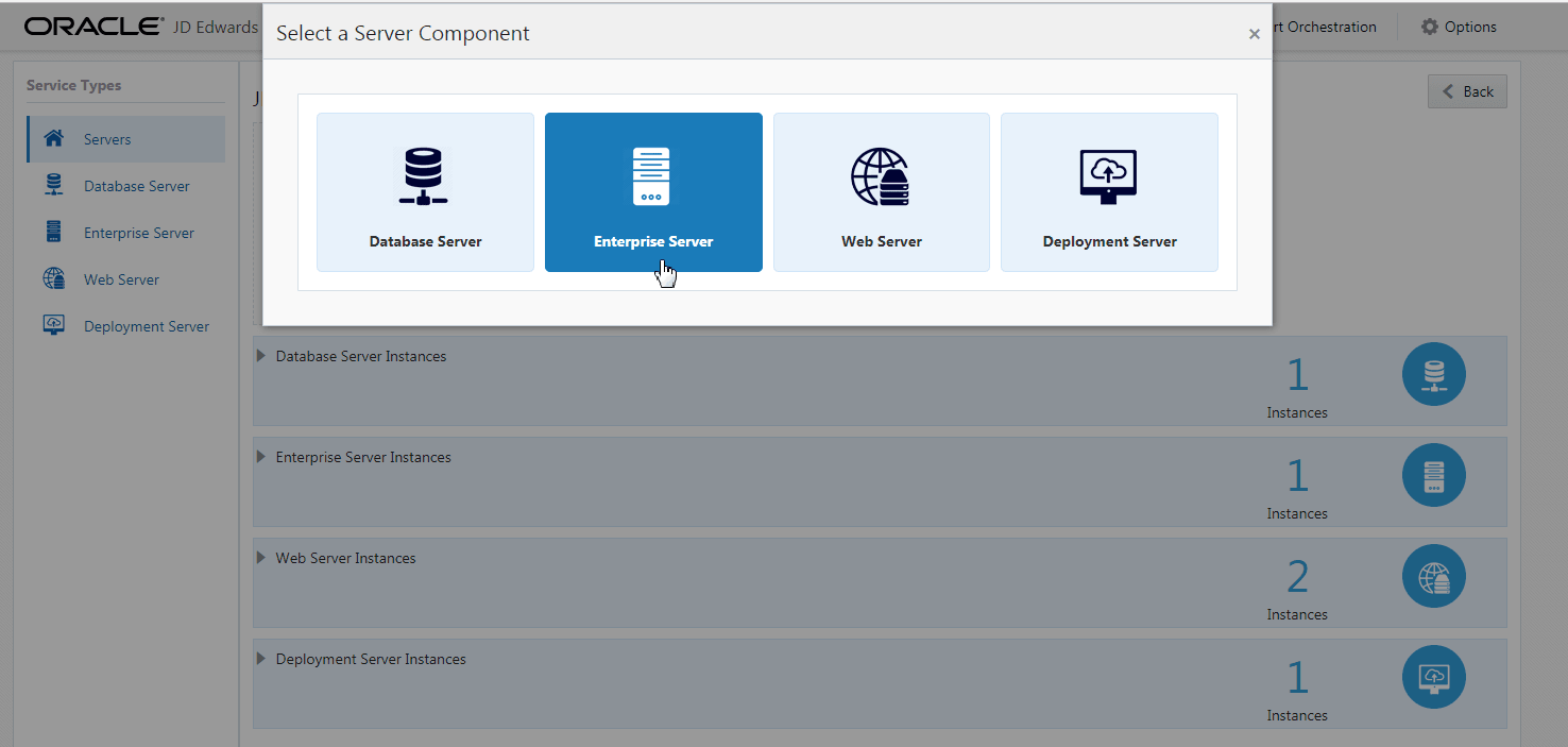

  1. Click the New Server icon and select Enterprise Server from the Select a Component window.This image shows the Select a Component window. The Enterprise Server icon is highlighted.
  2. On Enterprise Server Instance page, complete these fields to create and configure the Enterprise Server instance.

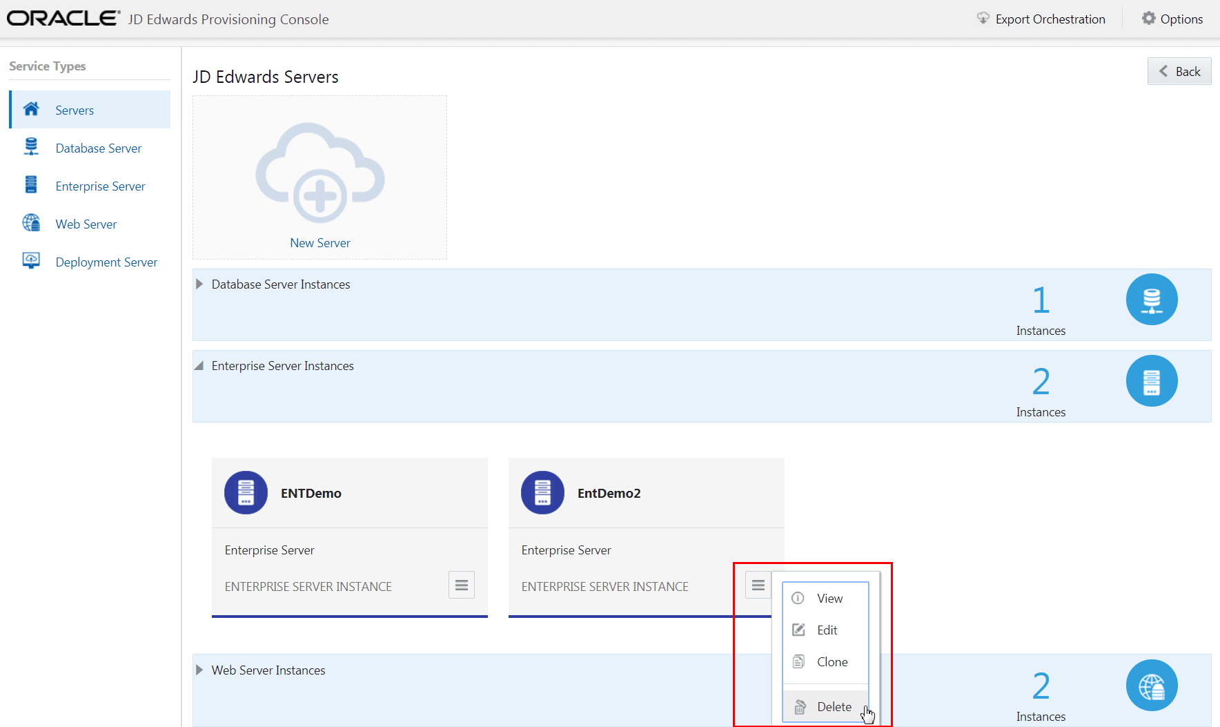

  3. You should now be able to view multiple instances of the Enterprise Server.This image shows the newly created Enterprise Server instance on JD Edwards Servers window.
  4. If an Enterprise Server exists, click View from the Application Options menu to view the existing configuration for the Enterprise Server. the instance configuration, select the Edit option from the action menu. Use the Clone option to clone the Enterprise Server instance.This image shows the context menu of the Enterprise Server instance on the JD Edwards Server page. The options availabe in the context menu are: View, Edit, Clone, and Delete.
  5. To delete the instance, select Delete from the Application Options menu.

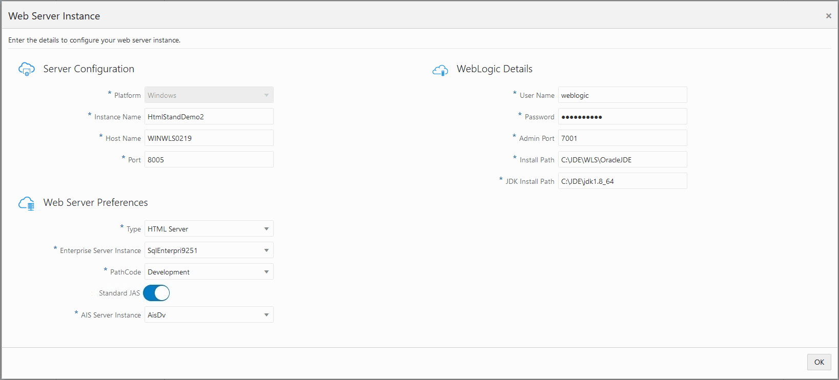

  4. On the JD Edwards HTML Server page, complete these fields to create and configure the HTML Server instance.
    Server Configuration
    • Platform
      This field is disabled and is automatically populated as Windows.
    • Instance Name
      Create the name of the HTML sever instance.
    • Host Name
      Enter the Fully Qualified Domain Name (FQDN) if the DNS service is enabled.
      Otherwise, enter only the host name that is configured in the host machine.
    • Port
      Enter a unique (available) port number for this server which will use an SSL connection. This port number must be between 1024 and 65535. This port number is used by HTTPS to create a container and deploy the web component. For whichever port number you enter here, ensure that the port for one less is also available. This is, if you specify port 8081, you must also ensure that port 8080 is available.
      Important:
      For each SSL port that you open in the firewall, you must also open a companion port for use by non-SSL access required for the Server Manager. The value for the companion port must be a numeric value that is one less than that specified for the SSL port. For example, if you specify a port value of 8081 for SSL, in the firewall you must also open a port one less than that value; For example, if you specify a port value of 8081 for SSL, in the firewall you must also open the port 8080. For more information, refer to the section "Enable Inbound Ports in the Firewall" of the OBE "Performing Common Setup for All Microsoft Windows Servers" in this Learning Path.
      Web Server Preferences
      • PathCode
        Select the required pathcode from the drop-down menu.
      WebLogic Details
      • User Name
        Enter the user name.
      • Password
        Enter the WebLogic Server password.
      • Admin Port
        Enter the port number to access the WebLogic Administration Console.
      • Install Path
        Enter the installation path of the WebLogic instance.
      • JDK Install Path
        Enter the JDK installation path.
        This image shows the Web server Instance page to create a new HTML Server instance in the Advanced mode.

  8. On the JD Edwards Deployment Server, complete these fields to create and configure your Deployment Server instance.

  10. Verify that the Web Server instances you modified or added are displayed in the JD Edwards Servers window.This image shows the webservers displayed on the JD Edwards Summary page.
  11. To delete any web instance, select Delete from the Application Options menu.
Deployment Server
You can use only one Deployment Server per deployment. If you attempt to add more than one Deployment Server, the Provisioning Console displays an error.This image shows the Create Instance Error window that is displayed while the user attempts to create more than one Deployment Server per disployment.
  1. On the JD Edwards Servers page, click the existing Deployment Server instance, click the Application Options icon, and select Edit from the Application Options menu.This image shows the details of the Deployment Server instances.
  2. On the JD Edwards Deployment Server, complete these fields to create and configure your Deployment Server instance.
    • Instance Name
      Create an instance name for the Deployment Server instance. The conditions to set the instance name are displayed in the tool tip when you click the field.
    • Host Name
      Enter the host name.
    • Deployment Server Preferences
      • Location
        Enter the location.
        This value is the base location for your JD Edwards EnterpriseOne machines. For example, typical values might be a city name (such as Denver or Austin), a geographical region name (such as US or India), or a general location name (such as Corporate).
      • Installation Drive
        Enter the drive for the installation.
      • Pathcodes
        This field is automatically populated.
      This image shows the JD Edwards Deployment Server page. It shows the example values to create and configure the Deployment Server instance.
  3. Click the Finish button. A success message is displayed.
  4. Verify that the Deployment Server instance you modified is displayed in the JD Edwards Servers window.
  5. You can select the Delete option in the Application Options menu to delete the Deployment Server instance. After you delete the existing Deployment Server instance, you can click the New Server icon, and then select Deployment Server from the Select a Component page to add a new Deployment Server instance.
