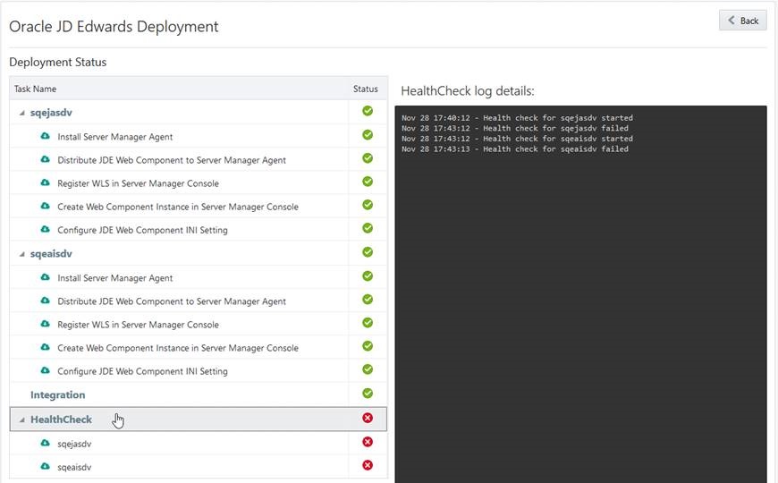

Enterprise Server Provisioning Fails - Health Check Fails
| Symptom: | PORTTEST runs remotely, but fails. |
| Cause: | The kernels are not starting up fast enough to run a PORTTEST successfully possibly because of a timing issue. |
| Resolution: | Rerun the deployment. It should quickly skip to the Ent Health Check and pass. |

Health Checks Fails During Final Step in One-Click Provisioning
