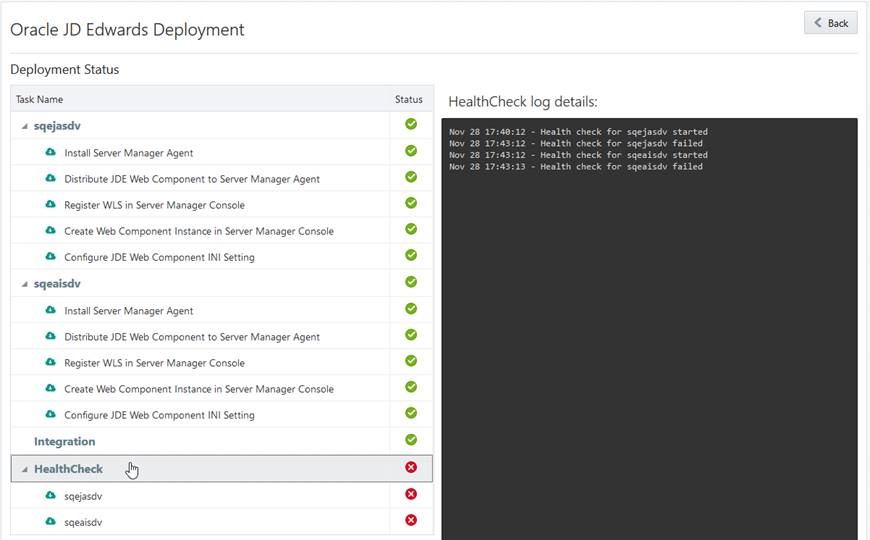

Health Checks Fail as Final Step in OCI Provisioning
If the health checks fail during the final step in OCI Provisioning (as shown in the example below), it is likely because the predefined ports for the Enterprise Server are either not enabled or not properly defined in the VCN.
health_checks_fail
