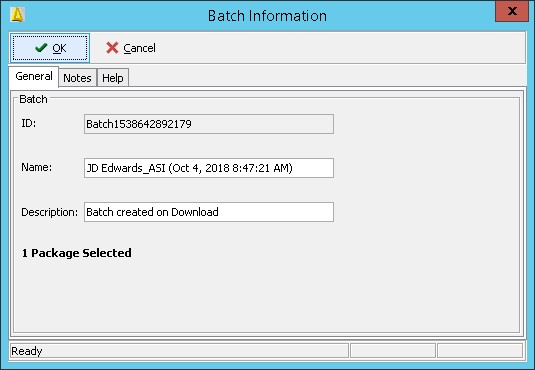

  6. Click Deploy on the Work with Packages toolbar to start the ASI.Batch Information

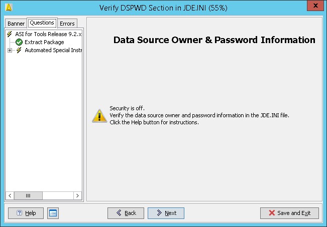

  7. Click OK to continue.Data Source Owner
    Note: If you have changed the password for any table owners created during the Platform Pack installation, they must be defined in the jde.ini file. The ASI assumes that the table owner's password is the same as the table owner, unless it finds overrides in the jde.ini file on the Deployment Server.

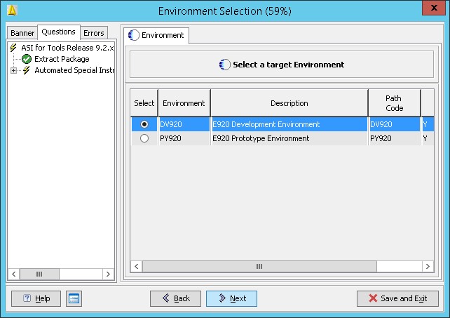

  10. Select the target environment and click Next.Environment Selection

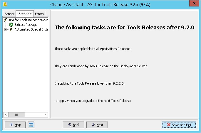

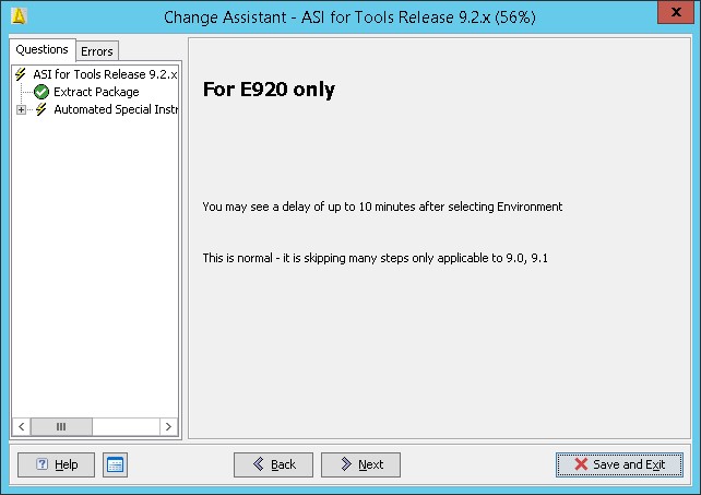

  13. Click Next to continue.Tools Release 9.2.0 Tasks

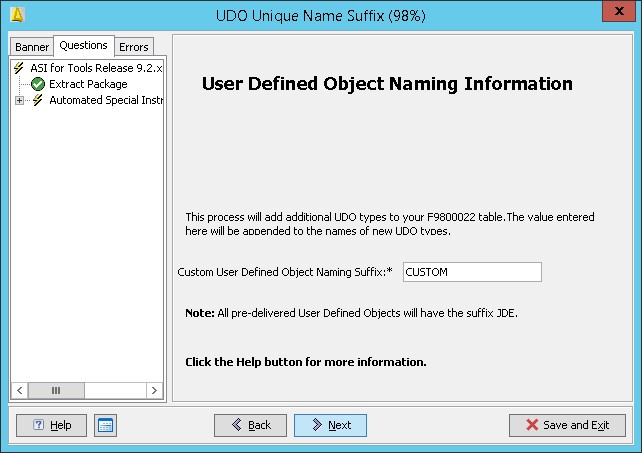

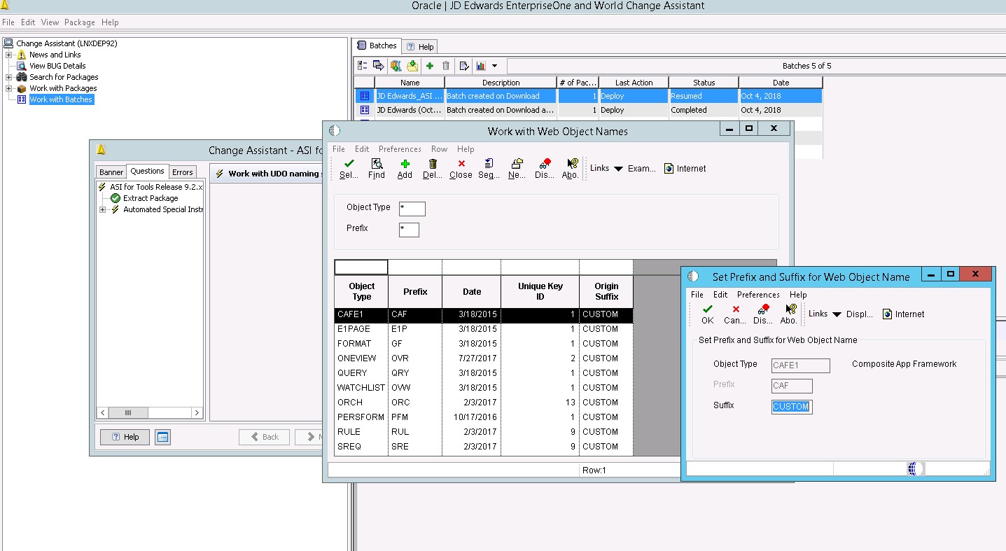

  14. Enter a UDO suffix and click Next.User Defined Object Suffix

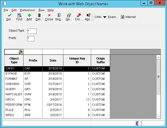

  15. On the Work with Web Object Names select a new UDO type.Work with Web Object Names Suffix
  16. Update the Suffix and click OK.Set Prefix and Suffix for Web Object Name

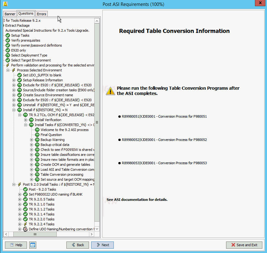

  17. Execute table conversions manually.
    The ASI will only prompt you to run the table conversions if it has detected data in F980052 in the System - xxx data source and no data in F980052 in the associated Control Tables data source.Required Table Conversion
    The dialog above appears only if F980051, F980052, and F980053 tables are in the incorrect format and have records in the F980052 table.
    Note: The following information assumes the ASI has been applied to target environment DV9X,X which has an associated WAN environment of JDV9XX. The associated WAN environment is to be used as the source environment for the table conversions.
    Verify whether there are any records in your version of these three tables in System - xxx. You won't be able to use Universal Table Browser, you will need to use sqlplus / strsql or other database tool. If there are no records, no action is required. The ASI will have generated the tables for you into the Control Tables – xxx data source for your target environment.
    The ASI applied the correct .par file to your Deployment Server.
    The ASI reset the OCM for these 3 tables to point to Control Tables – xxx for the environment you applied the ASI to, plus any other environments that share the same path code.
    Your source and target environment for the table conversion must be different. The ASI sets the OCM for these three tables to System - xxx for the WAN environment (JDV9XX) associated with the environment you ran the ASI against.
    Sign in to JDEPLAN and run the table conversions one at a time and submit from Batch Versions. Click on Properties and change the source environment to JDV9XX and the target environment to DV9XX.
    Once the table conversions have run, reset the OCM in JDEPLAN for the source environment to point to the Control Tables - xxx again.
    If you have multiple environments with different Control Tables associated with this path code, copy the output table from the table conversion to each of the environments' Control Tables. For example:
    • You have DV920 JDV920 DV920XX DV920YY and DV920XX where YY have their own unique Control Tables.
    • Run the table conversion against JDV920 DV920, and then copy the F980051, 52, 53 from Control Tables - Test to the Control Tables for DV920XX and DV920YY.

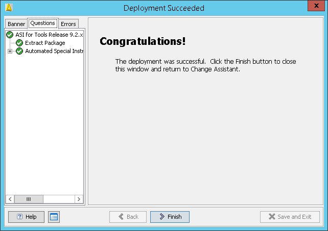

  21. Click Finish.Deployment Succeeded
