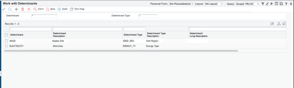

1: Setting Up Determinants
For energy consumed in the manufacturing process, the type of energy and grid region are key in determining the emission factor. For this example, we will configure Electricity (Energy Type) and Alaska (Grid Region) as determinants.
  1. Sign in to the EnterpriseOne web client.
  2. From the EnterpriseOne Menus, select Sustainability Framework Setup (G20S41), and then select Determinants (P20S05).
  3. On the Work with Determinants form, click Add to open the Determinants Revision form (W20S05C).
  4. For each field, enter the following values:
  5. Determinant ELECTRICITY
    Determinant Description Electricity
    Determinant Type ENERGY _TY
    Determinant AKGD
    Determinant Description Alaska Grid
    Determinant Type GRID_REG
  6. Click OK to save the determinants.
  7. Description of sample-image-1.png follows

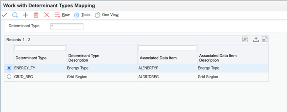

2: Mapping Determinant Type
To save the determinants in the Sustainability Activity Ledger table (F20S11), map each determinant type to the associated column using the Determinant Type Mapping program (P20S09).
  1. From the EnterpriseOne Menus, select Sustainability Framework Setup (G20S41), and then select Determinant Types Mapping (P20S09).
  2. On the Work with Determinant Types Mapping form, click Add to open the Determinant Types Mapping Revision form (W20S09B).
  3. Enter the following mappings for the determinant types:
  4. Determinant Type ENERGY_TY
    Associated Data Item ALENERTYP
    Associated Data Item ALGRIDREG
  5. Click OK to save the changes.
  6. Description of sample-image-1.png follows

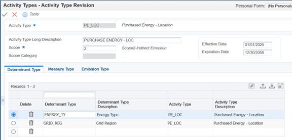

3: Defining Activity Type for Purchased Energy
The electricity consumed at this facility is purchased from the power grid, so it is classified as a Purchased Energy activity.
  1. From the EnterpriseOne Menus, select Sustainability Framework Setup (G20S41), and then select Activity Types (P20S01).
  2. On the Work with Activity Types form, click Add to open the Activity Type Revision form (W20S01D).
  3. Enter the following values:
    • Activity Type: PE_LOC
    • Activity Type Description: Purchased Energy - Location
    • Scope: 2
    • On the Determinant Types tab, create two rows, one each for determinant types ENERGY_TY and GRID_REG.
    Determinant Type tab

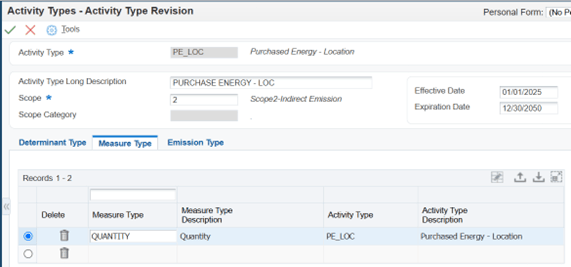

    • On the Measure Type tab, enter measure type QUANTITY in the Measure Type field.
    Measure Type tab

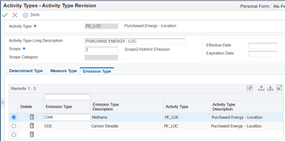

    • (Optional) On the Emission Types tab, enter these in the Emission Type field: CH4, CO2
    Emission Type tab

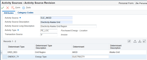

4: Defining Activity Source Energy
The manufacturing facility consumes electricity from the Alaska grid, so we will designate ELE_AKGD (Electricity Alaska Grid) as the activity source for the Purchased Energy activity type.
  1. From the EnterpriseOne Menus, select Sustainability Framework Setup (G20S41), and then select Activity Source (P20S07).
  2. On the Work with Activity Source form, click Add to open the Activity Source Revision form (W20S07C).
  4. Activity Source ELE_AKGD
    Activity Source Description Electricity Alaska Grid
    Activity Source Long Description Electricity Alaska Grid Region
    Activity Type PE_LOC
    Transaction Source V(to specify the source of voucher or invoice)
    Determinant AKGD, ELECTRICITY (for the two determinant type rows)

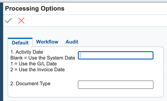

Set up processing options for Sustainability Framework MBF (P20S12):
  1. From the EnterpriseOne Menus, enter IV in the Fast Path, and then enter P20S12 in the Interactive Application field. Open Sustainability Framework MBF and select Processing Options from the Row menu.
  2. Enter processing options on each tab as required:
    • Default tab: Set relevant defaults for sustainability processing.
    • Description of sample-image-1.png follows
      Default tab

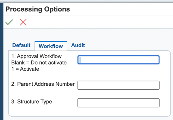

    • Workflow tab: Configure workflow options (if applicable).
      Workflow tab
    • Audit tab: Enter 1 to activate the audit history for compliance and reporting requirements. You can leave this field blank if you do not want to activate the audit history. To complete the steps in this OBE, enter the value 1.
      Audit tab

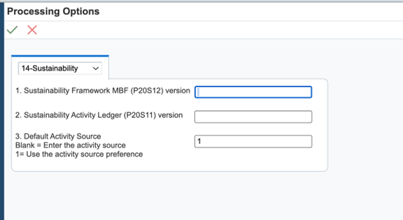

Set up processing options for Standard Voucher Entry (P0411):
  1. From the EnterpriseOne Menus, select Sustainability Framework Processing (G20S10), then right-click the Standard Voucher Entry (P20S11IZJDE0001), and select Processing Options.
  2. Select the Sustainability tab, and then enter value for Version processing option. You can leave it blank for the system to consider ZJDE0001.
  3. If you specify 1 for the Default Activity Source processing option, the system retrieves the activity source in the transaction automatically, based on the preference setup in the Activity Source Preference program (P20S21). You can then verify the activity source and modify it, if required.
  4. Description of sample-image-1.png follows
    Sustainability tab

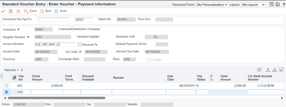

Entering the Voucher Using the Standard Voucher Entry program (P0411)
  1. From the EnterpriseOne Menus, select Sustainability Framework Processing (G20S10), and then select Standard Voucher Entry (P0411|ZJDE0019).
  2. Click Add on the Supplier Ledger Inquiry form.
  3. On the Enter Voucher - Payment Information form, enter the following information:
  4. Company 00001
    Supplier Number 4343
    G/L Date 06/08/2025
    Gross Amount 2000
    Enter Voucher-Payment Information form
  5. Click OK to save the record.

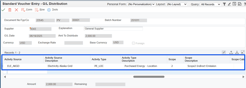

  6. On the G/L Distribution form, enter these GL distribution details and the sustainability information in the form:
  7. Account Number 1.8330
    Resource Quantity 50
    Resource UoM KW
    (Optional) Consumption Start Date 1/5/2025
    (Optional) Consumption End Date 05/31/2025
    (Optional) Total Co2e Emissions 2.36
    (Optional) Total Co2e Emissions UoM KG
    (Optional) Co2 Emissions 1.27
    (Optional) Co2 Emissions UoM KG
    (Optional) Energy 0.56
    (Optional) Energy UoM MJ

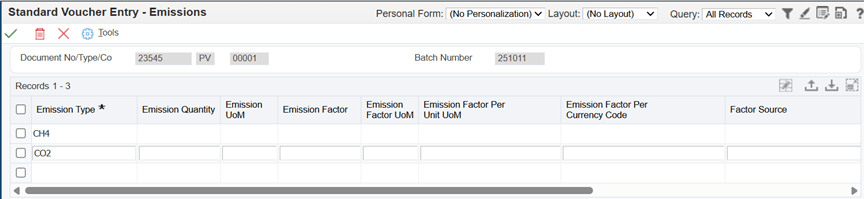

  8. (Optional) If you have the segregated details of total emissions, you can select the record and select Emissions from the Row menu to enter these details.
  9. NOTE: These Emission Type will display by default based on the setup on the Emission Type tab of the Activity Type (P20S01) program.
    Emissions form
