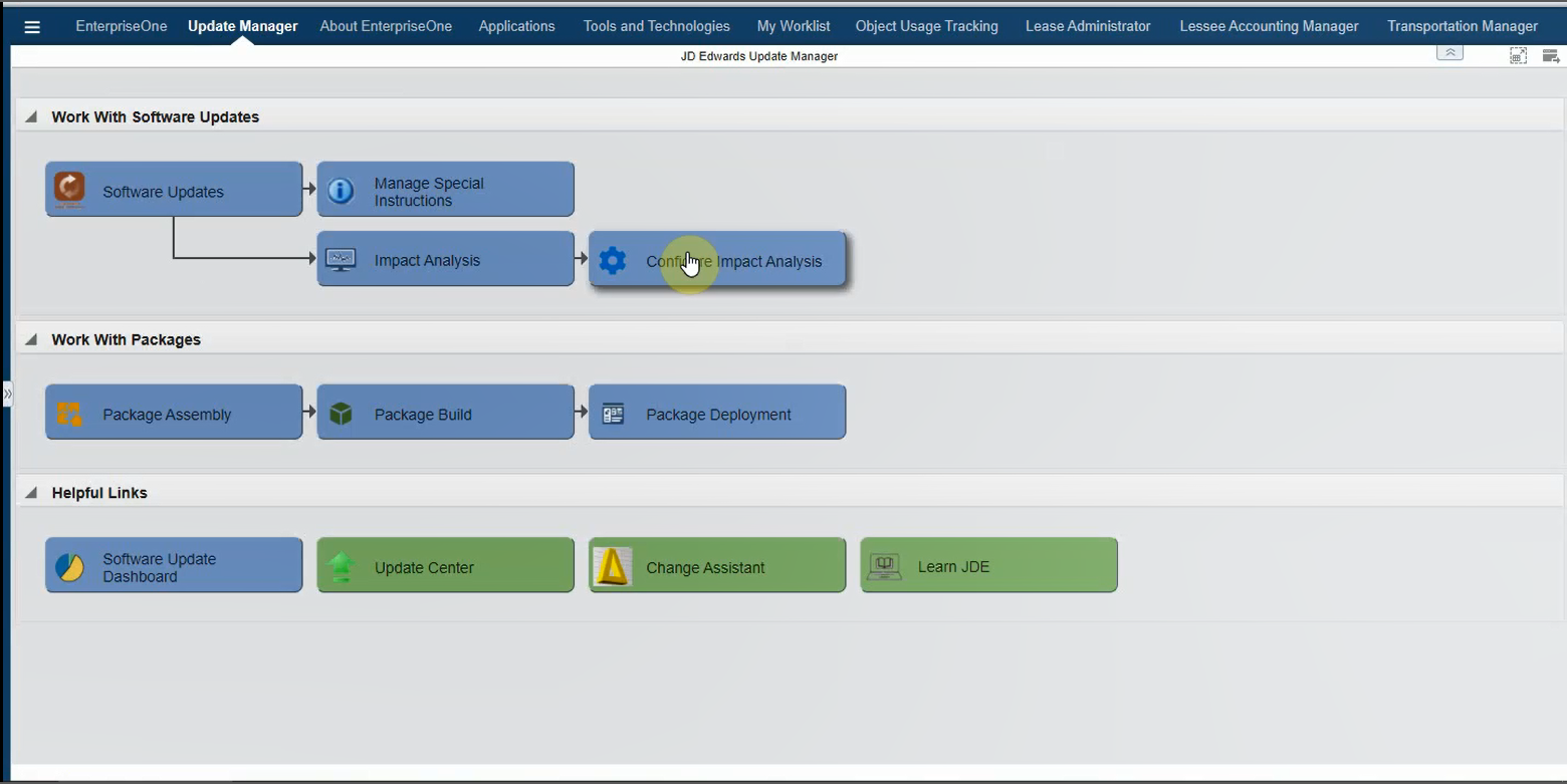

To configure the impact analysis environment:

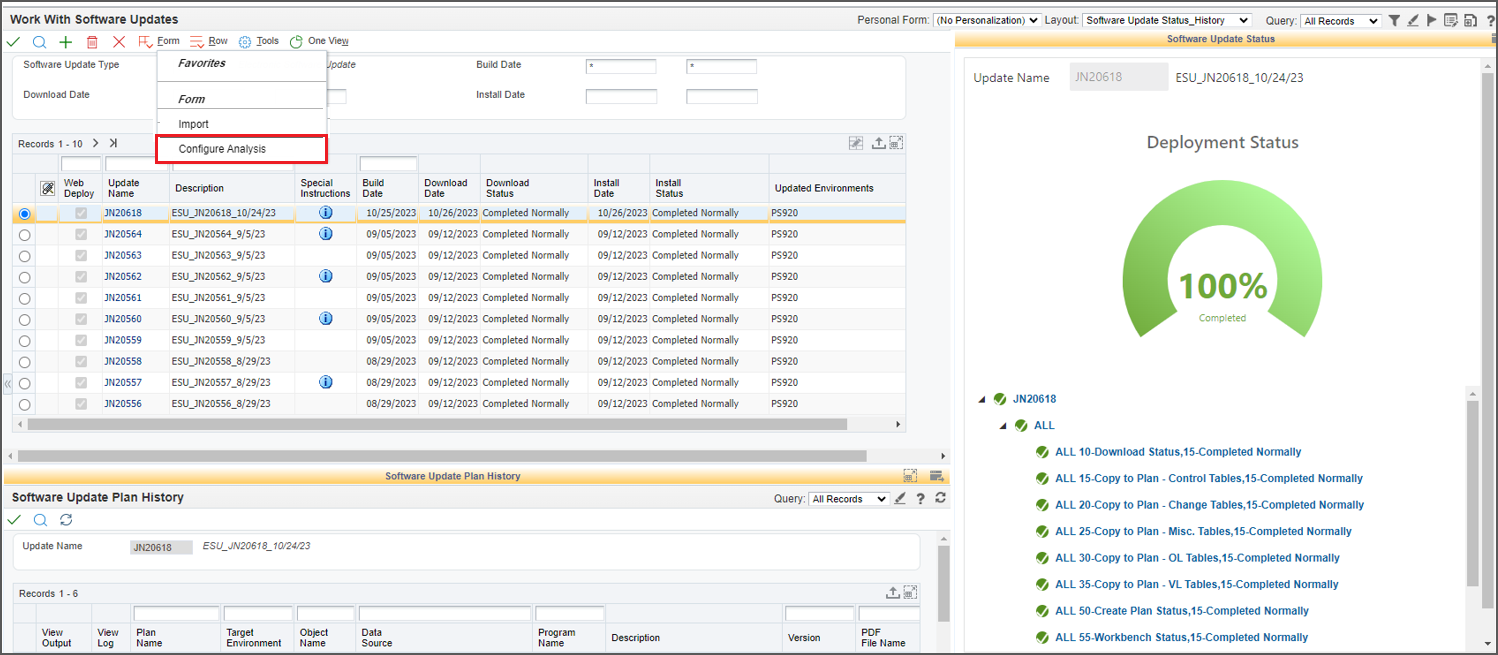

- Sign in to EnterpriseOne on the web client.
- Select Configure Impact Analysis from the
Update Manager Process page.
OR
Update Manager Process Page -
From the Software Updates menu (GH9612), select Work With Software Updates (P96470W) and select the ESU from the grid.
- Select Form Exit, and then click Configure
Analysis.

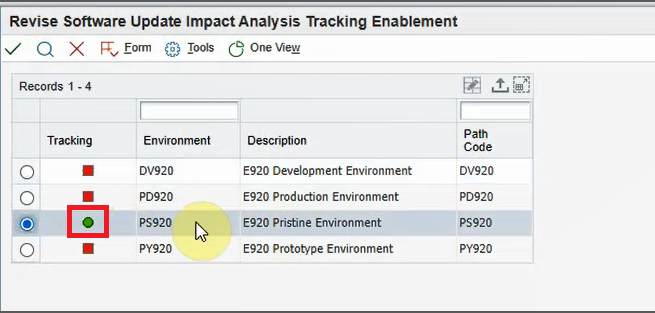

Work With Software Updates Form - Configure Analysis Option - In the Revise Software Update Impact Analysis Tracking
Enablement form, select the target environment.
Note: The green circle in the Tracking column indicates impact analysis tracking is enabled for the environment and that the impact analysis will automatically run when you import or add the ESU to this environment. The red square indicates impact analysis tracking is disabled for the environment.
Important: The Software Update Impact Analysis application (P96710W) performs impact analysis tracking only for ESUs and not for ASUs.
Revise Software Update Impact Analysis Tracking Enablement Form - Click OK.
When an ESU is imported into the repository, the system uses this configuration to automatically set up the data for impact analysis.

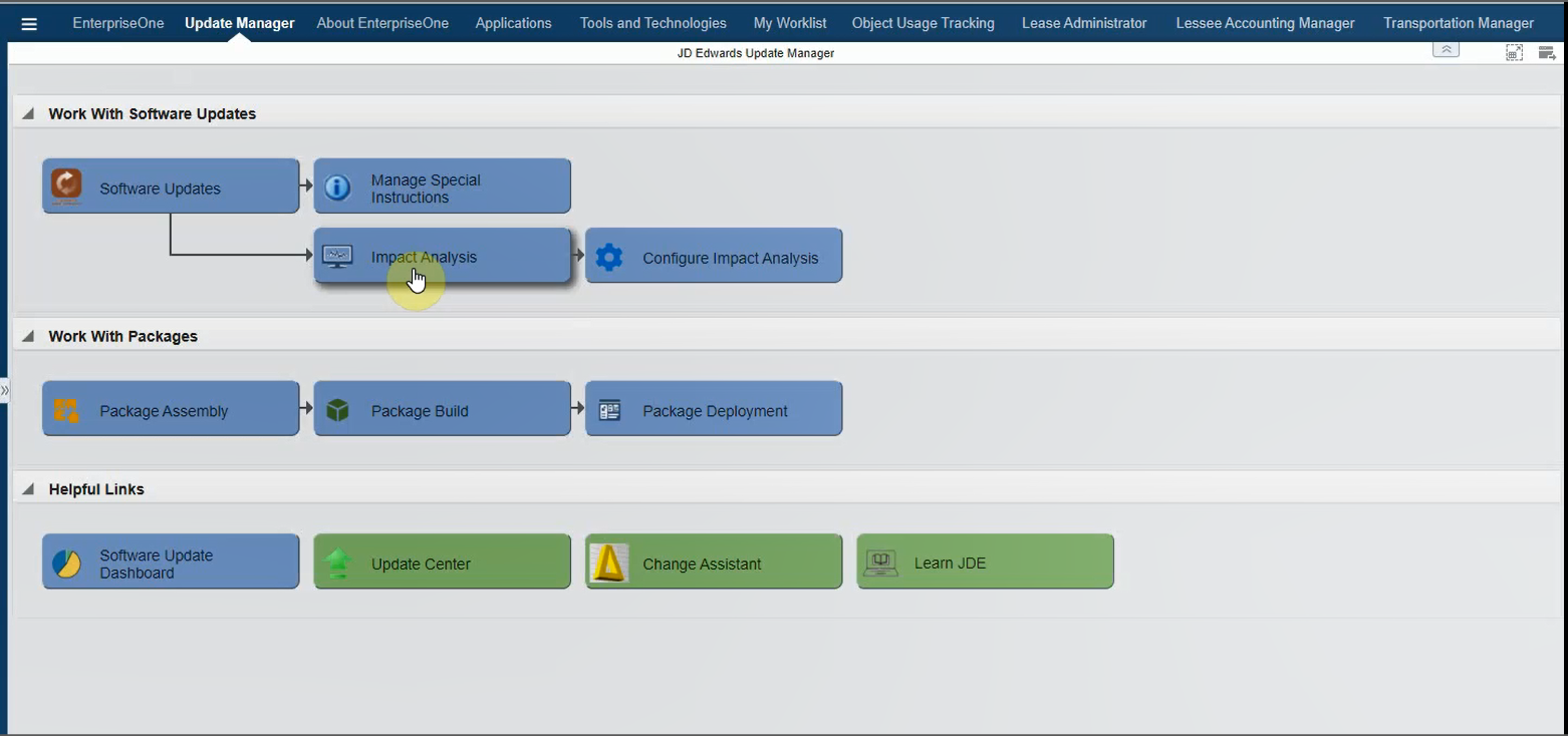

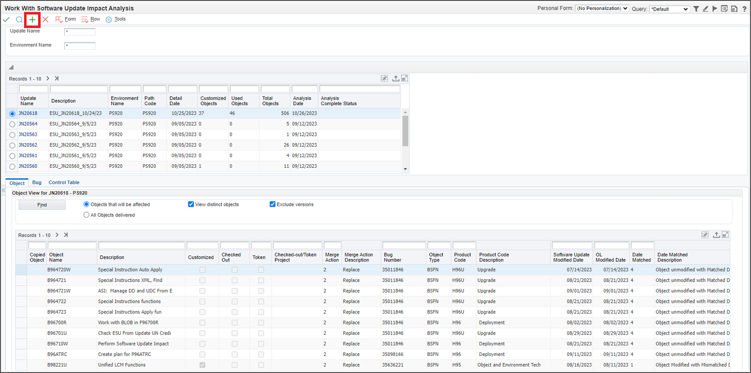

- From the Software Updates menu (GH9612), select Software
Update Impact Analysis (P96710W) OR in the Update
Manager Process page, click Impact Analysis.
Update Manager Process Page - Impact Analysis Option - In the Work With Software Update Impact Analysis form, click
Add. The Impact Analysis Setup form is
displayed.

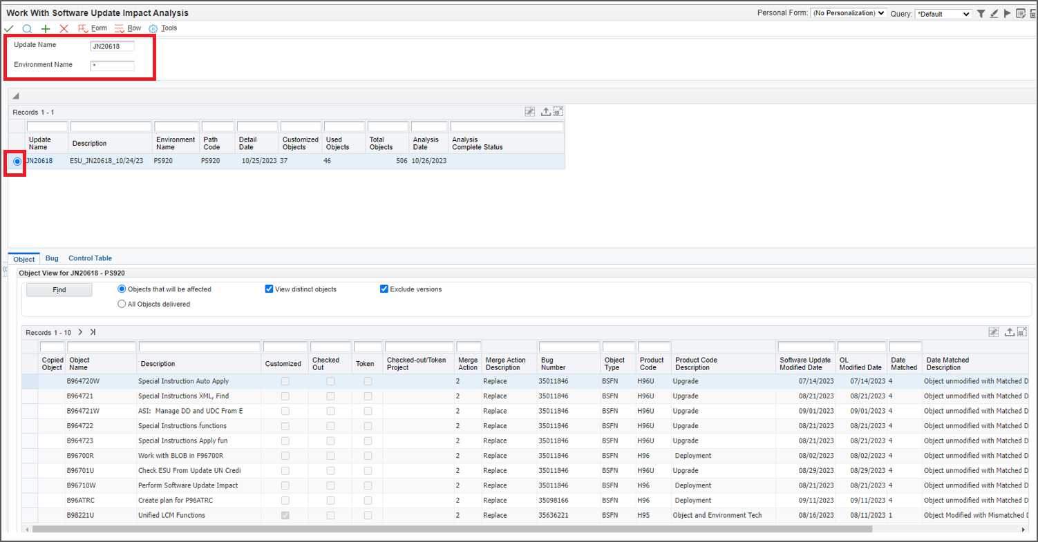

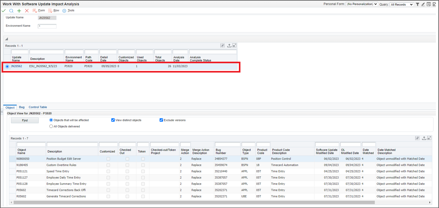

Work With Software Update Impact Analysis Form - Add Option - Enter the Software Update Name (for
example
JN20562), and the Environment Name (for examplePS920).

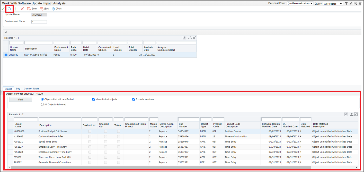

Impact Analysis Setup Form - Click OK. The impact analysis record is
created and loaded in the Work With Software Update Impact
Analysis form and the analysis process begins in the
background.
Work With Software Update Impact Analysis Form - Analysis Record - Click Find to refresh the page. The
analysis results are displayed in the lower pane of the Work
With Software Update Impact Analysis form. A list of all the
affected objects, delivered bugs, and applied control tables
is displayed.
Work With Software Update Impact Analysis Form - List of Affected Objects, Bugs, and Control Tables

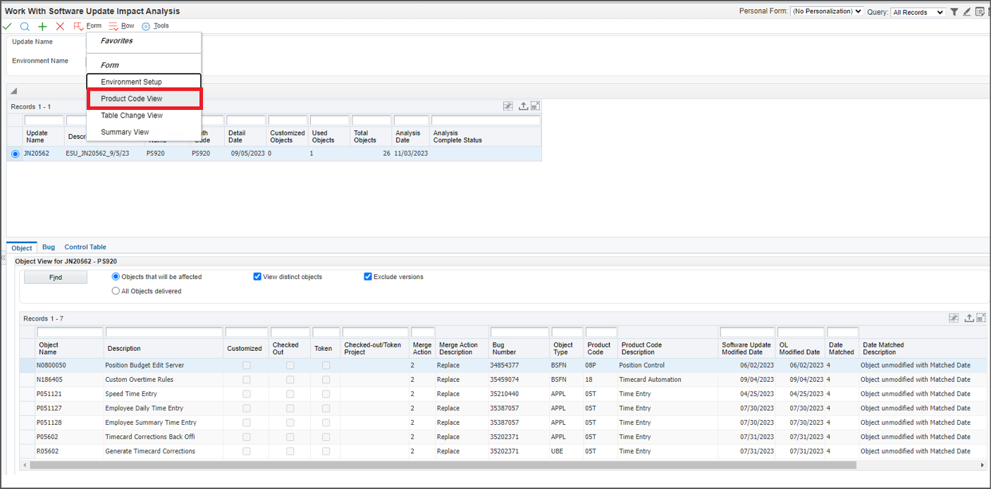

- In
Form Exit and select Product
Code View.
Work With Software Update Impact Analysis Form - Product Code View Menu Option

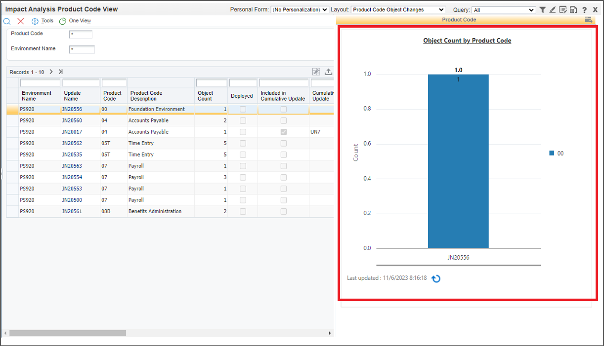

The Impact Analysis Product Code View form is displayed.

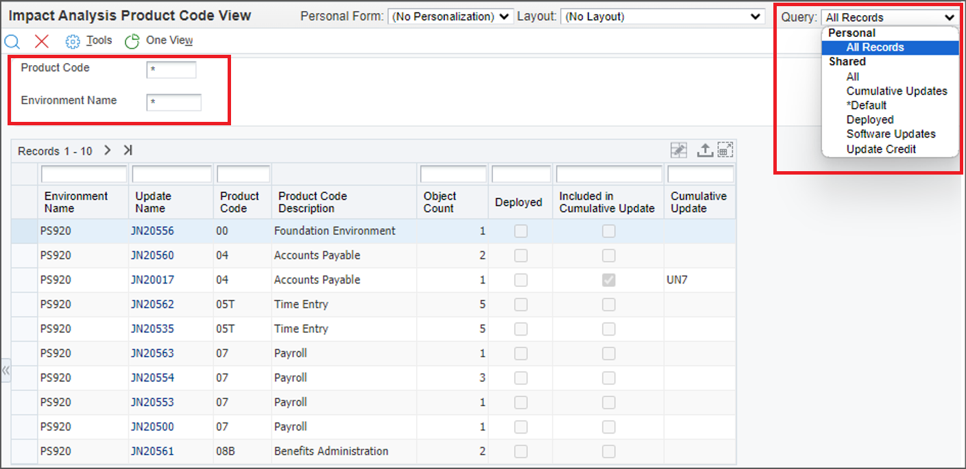

- You
can filter the count of objects affected by the software
update, by Product Code, Environment
Name, or by setting the query in the Query
field.
Impact Analysis Product Code View Form A graphical representation of the object count analysis is displayed in the right pane of the form.
Impact Analysis Product Code View Form - Object Count by Product Code Chart
- Click
Close to exit.

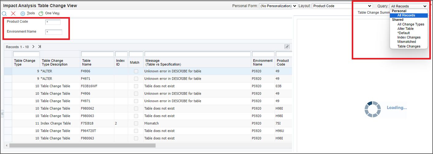

Form Exit and select Table

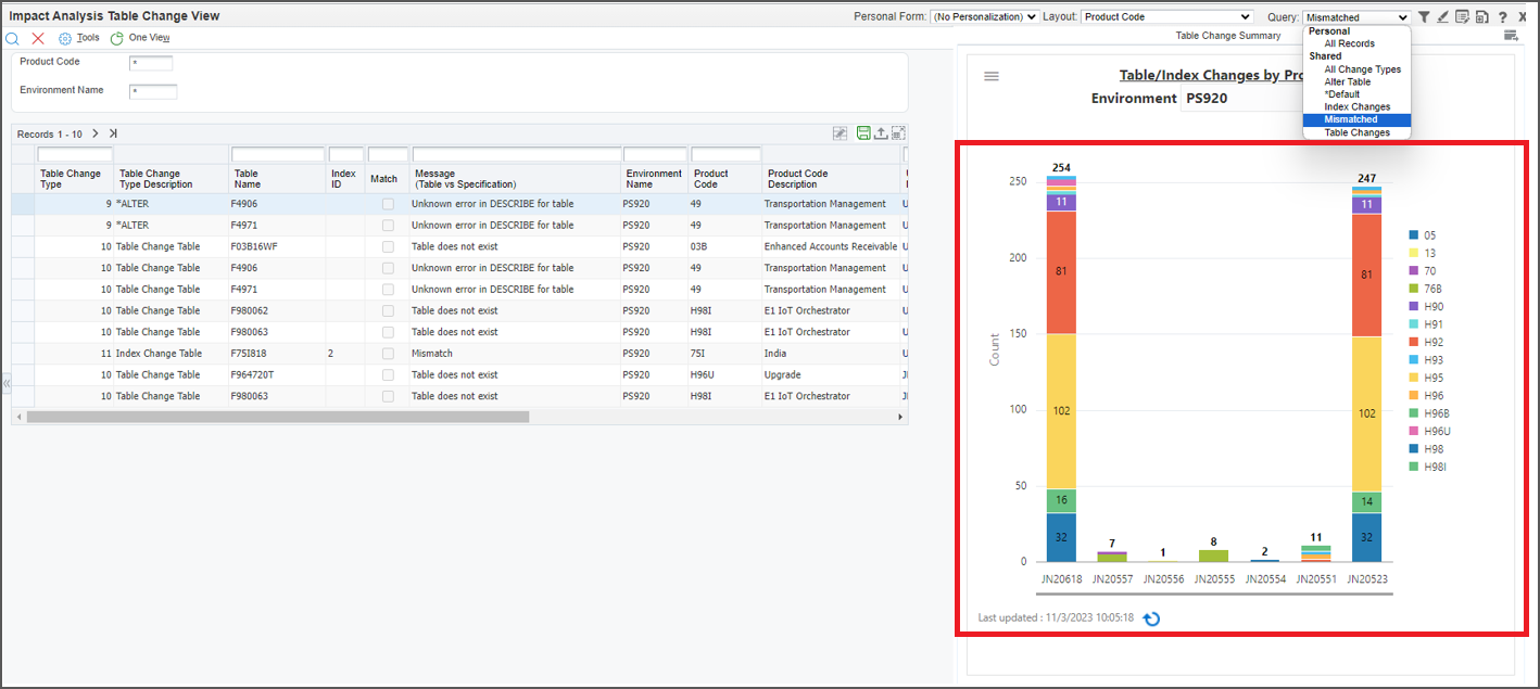

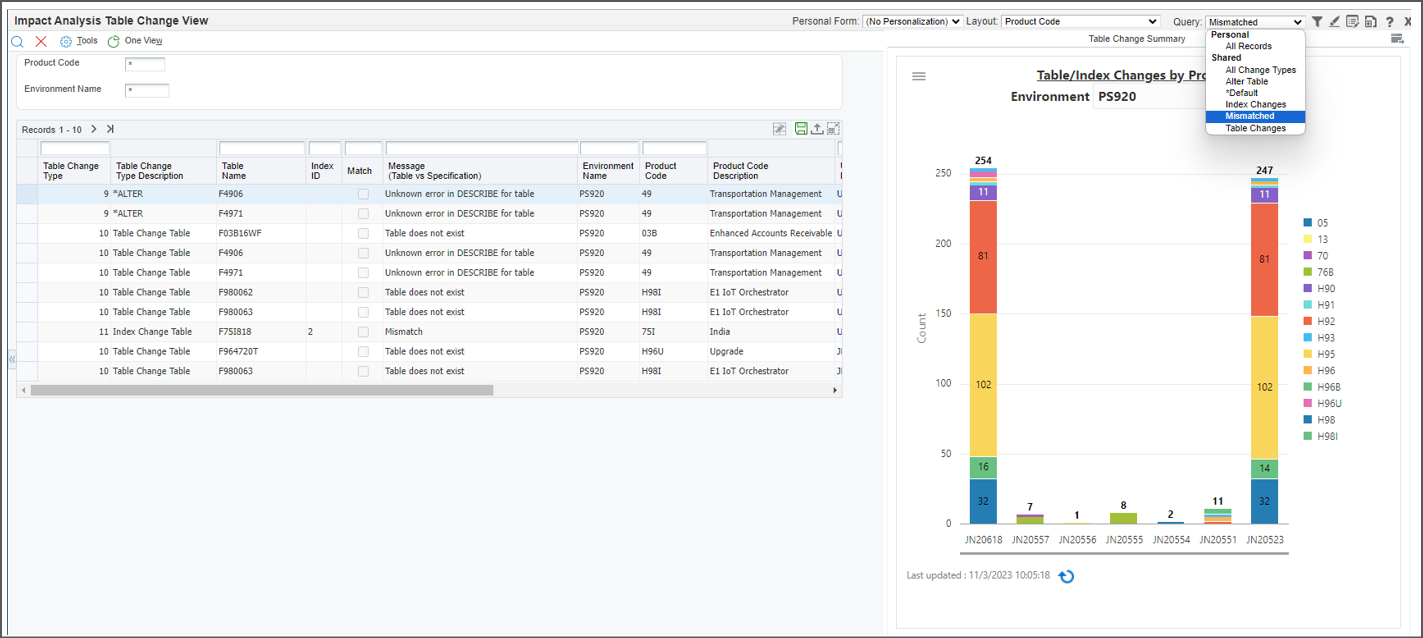

Change View. The Impact Analysis Table Change
Work With Software Update Impact Analysis Form - Table Change View Menu Option - You
can filter the table and index changes by Product
Code, Environment Name, or
by setting the query in the Query field.
Impact Analysis Table Change View Form - Filter Criteria
A graphical representation of the Table and Index change analysis is displayed in the right pane of the form.
Impact Analysis Table Change View Form -Table/Index Changes by Product Code Chart
- Click
Close to exit.

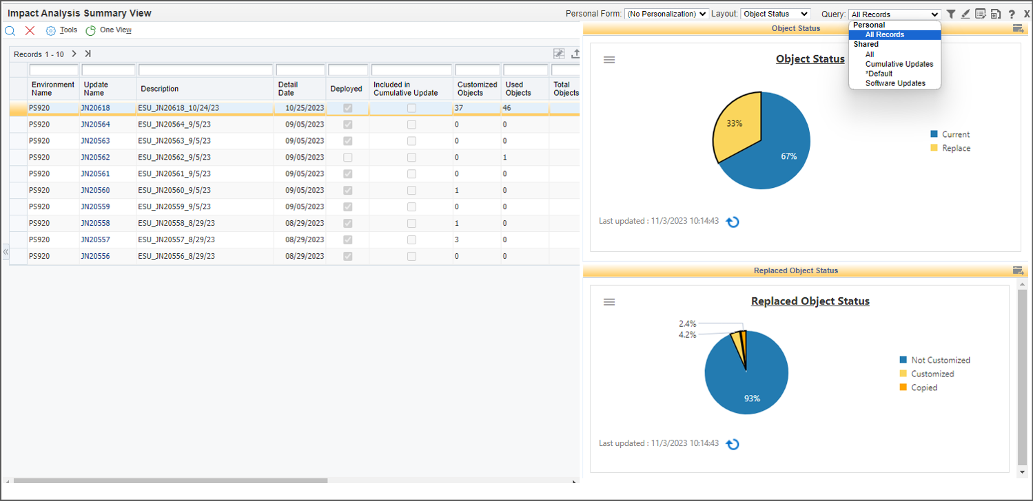

- In
(P96710W), click Form Exit and select Summary
View. The Impact Analysis Summary View form is
displayed.

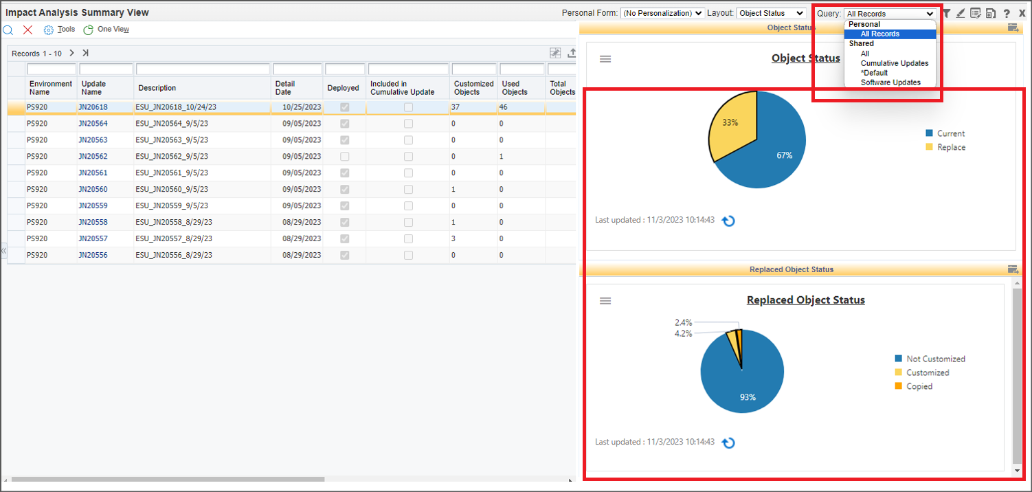

Work With Software Update Impact Analysis Form - Summary View Menu Option - You
can filter the view by setting the query in the Query
field and review the graphical summary of the
affected and replaced objects.
Impact Analysis Summary View Form - Object Status and Replaced Object Status Charts
- Click Close to exit.

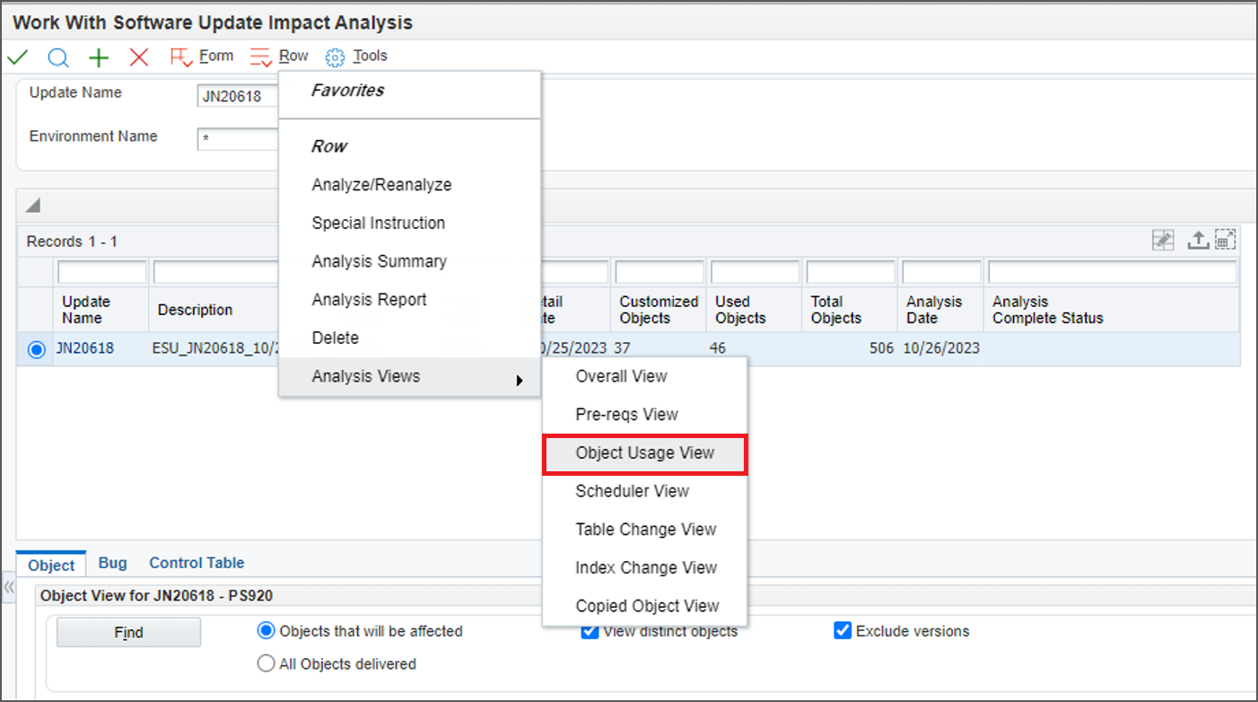

- In
Row Exit and select Analysis
Views and then select Object Usage
View. The Impact Analysis - Object Usage View
form is displayed.
Work With Software Update Impact Analysis Form - Object Usage View Menu Option - In
the Object Usage View, filter the records and review the
usage of all objects for the selected ESU. You can review
object usage details such as whether the object is
customized, whether it is used, and the usage count of the
object if the object usage tracking is turned on.
Impact Analysis - Object Usage View Form - Click Close to exit.

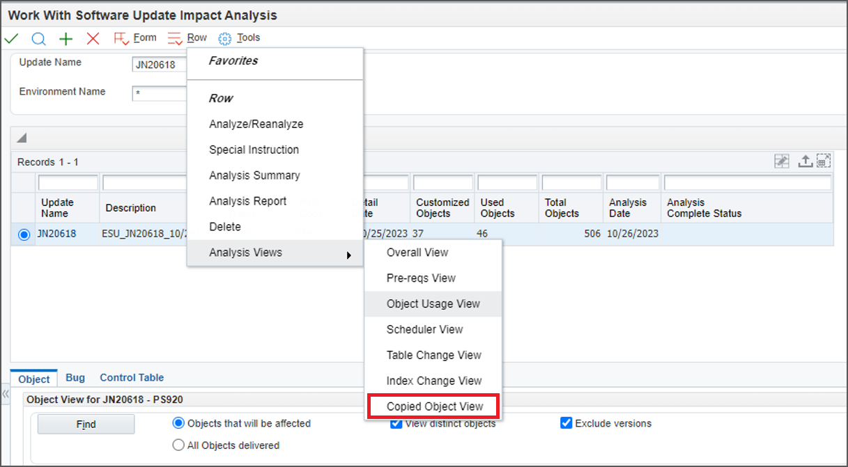

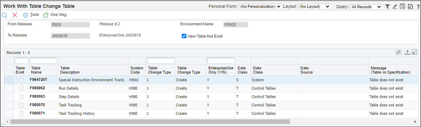

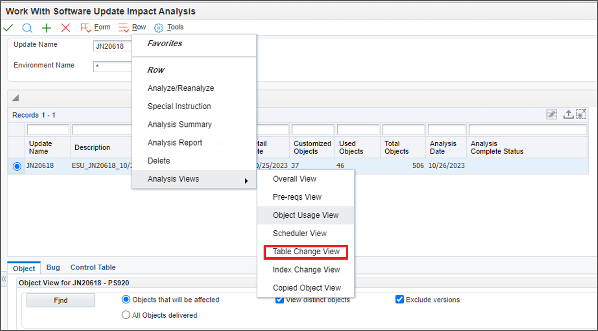

- In
(P96710W), click Row exit, select Analysis
Views and then select Table Change
View. The Work With Table Change Table form is
displayed.
Work With Software Update Impact Analysis Form - Table Change View Menu Option - In
the Work With Table Change Table view, filter the table
change records and review the table changes for the
selected ESU.
Work With Table Change Table Form - Click Close to exit.

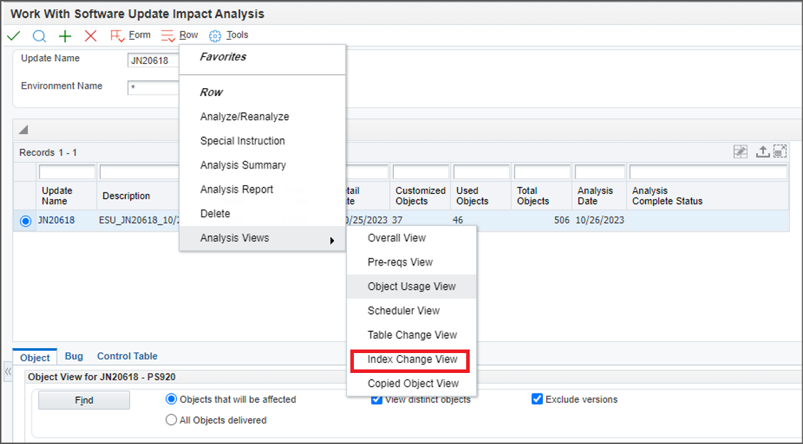

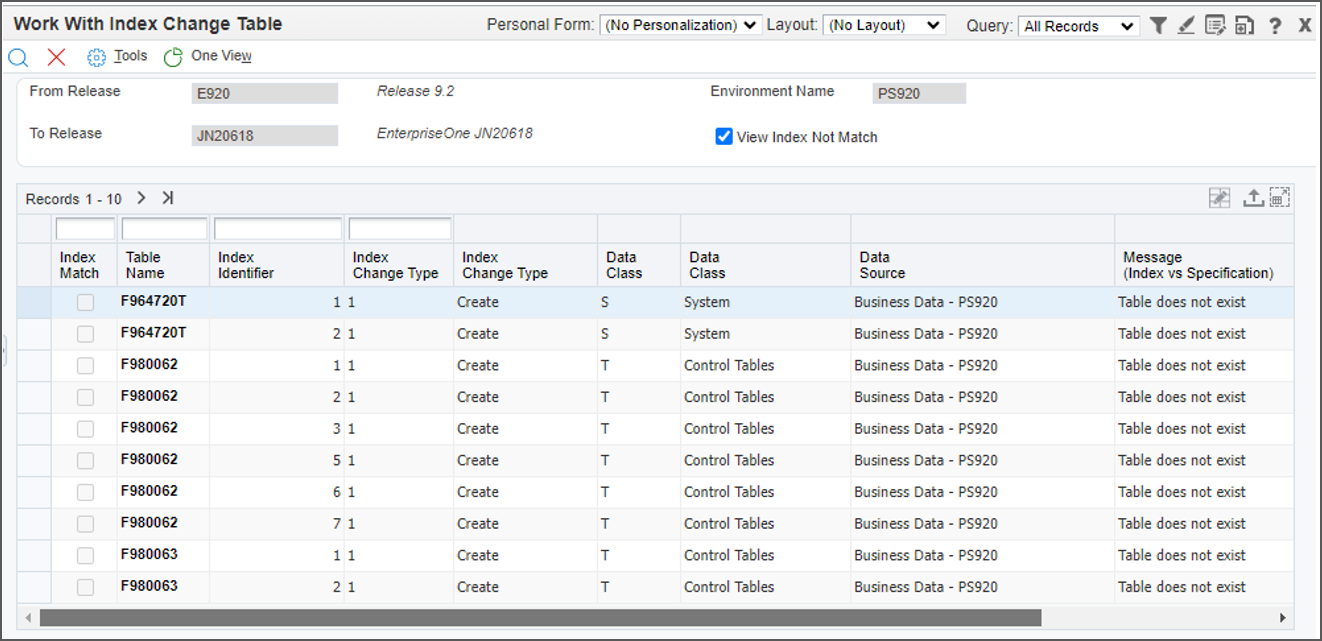

- In
Views and then select Index Change
View. The Work With Index Change Table form is
displayed.
Work With Software Update Impact Analysis Form - Index Change View Menu Option - In
the Work With Index Change Table form, filter the index
change records and review the index changes for the
selected ESU.
Work With Index Change Form - Click Close to exit.

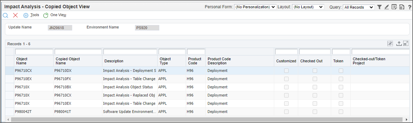

- In
Views and then select Copied Object
View. The Impact Analysis - Copied Object View
form is displayed.
Work With Software Update Impact Analysis Form - Copied Object View Menu Option - Use
the Copied Object View to filter and review all the copied
Impact Analysis - Copied Object View Form - Click Close to exit.
- In the Work With Software Update Impact Analysis form, click Close to exit.

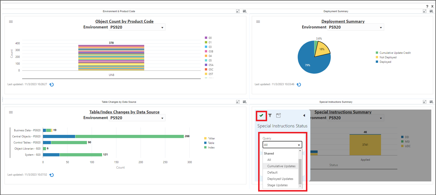

Reviewing
the Impact Analysis Views on the Software Update Dashboard

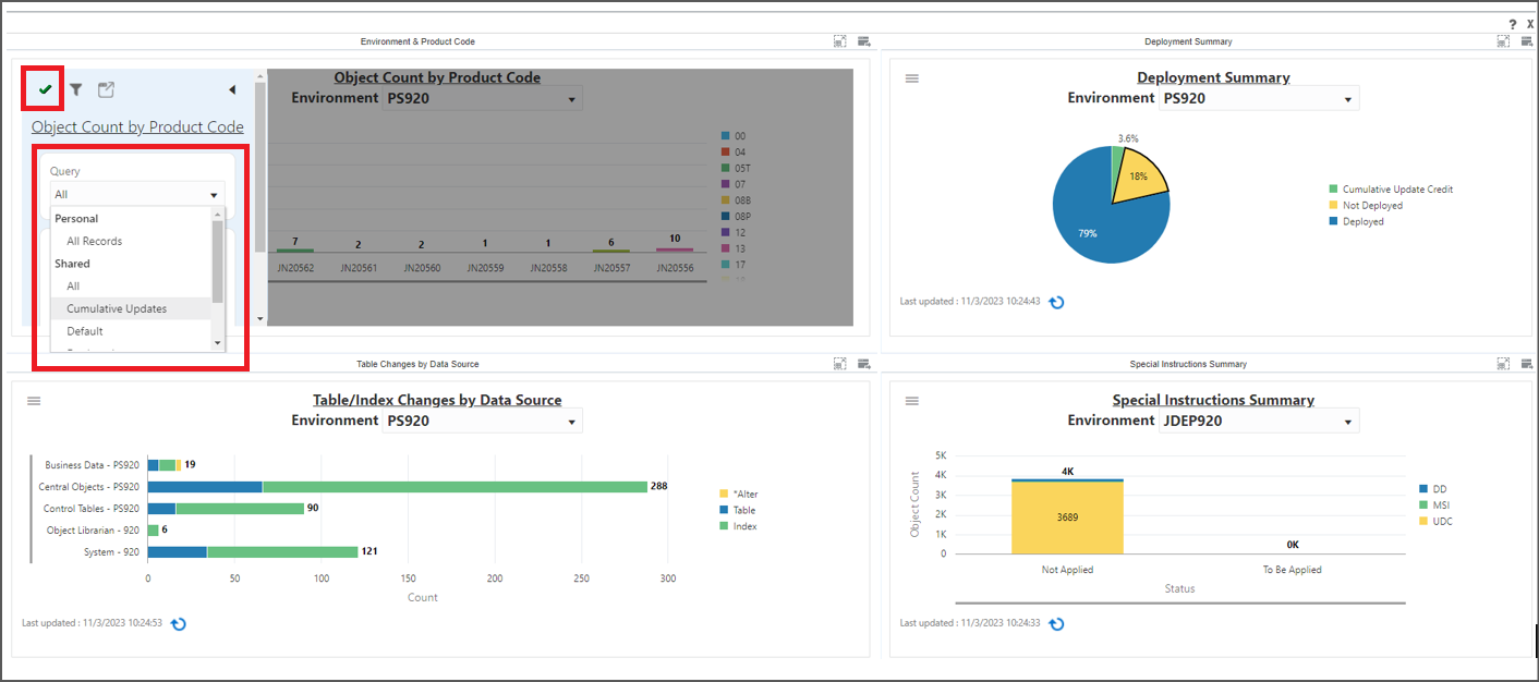

The Software Update Dashboard provides a comprehensive
interface to visualize the objects and business processes that
are updated when a patch is applied to your system.
The data displayed in the Software Update Dashboard is based on
the impact analysis configuration setup and the impact analysis
results.

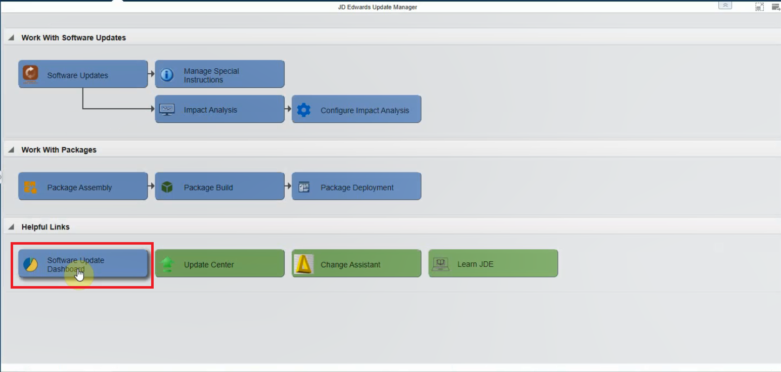

- On the Update Manager Process Flow page, Click Software
Update Dashboard.
Update Manager Process Page - Software Update Dashboard Option

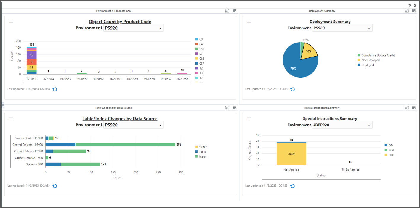

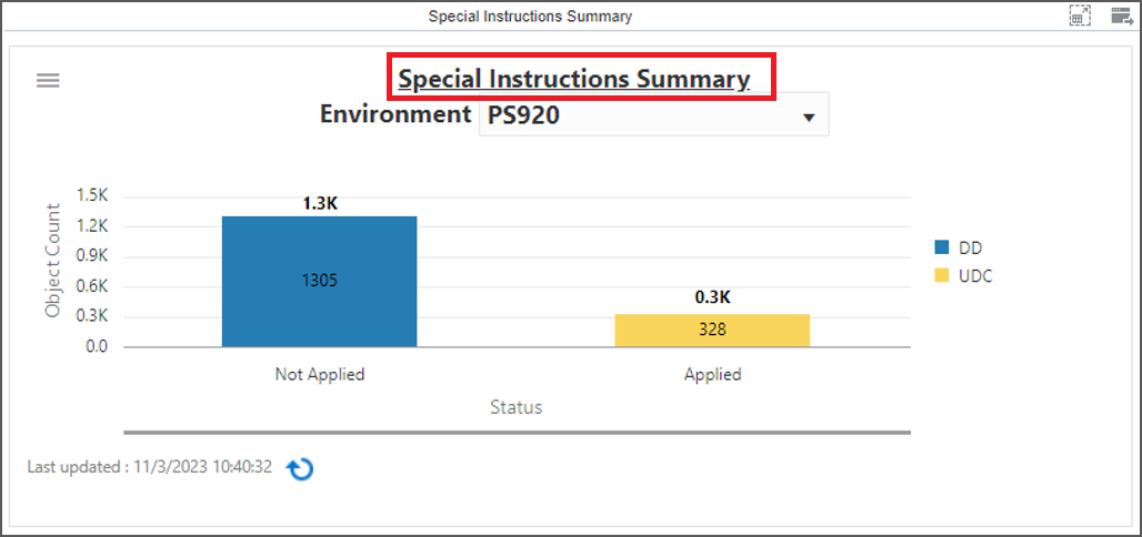

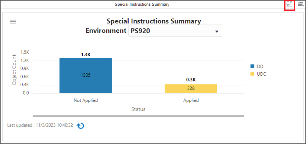

The Software Update Dashboard comprises of four components:
- Deployment Summary
- Table/Index Changes by Data Source
- Special Instructions Summary
Software Update Dashboard Components

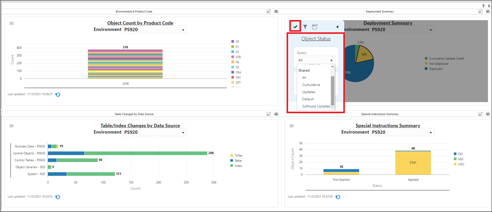

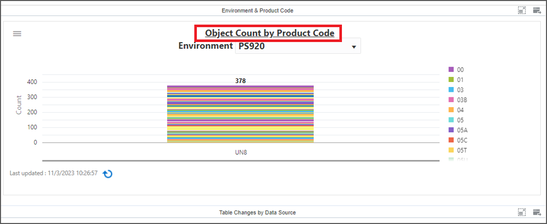

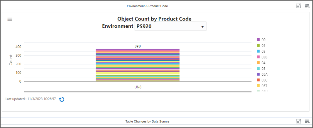

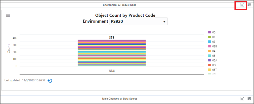

- To review object usage totals by product code for the
specified environment, use the Object Count by Product Code
chart:
- In the Object Count by Product Code tray, click the Menu option to open the pane with filter criteria.
- Set
the Query to
Alland click OK.
Object Count by Product Code - Filter Criteria
- The
Object Count by Product Code tray displays a graphical
chart that summarizes the view.
- Click
the export icon to export the data in tabular form for
external consumption.
Object Count by Product Code - Export Data Option
- Click
the component heading Object Count by Product
Code to drill down to the Impact Analysis
Product Code View application.
Object Count by Product Code - Link to the Application

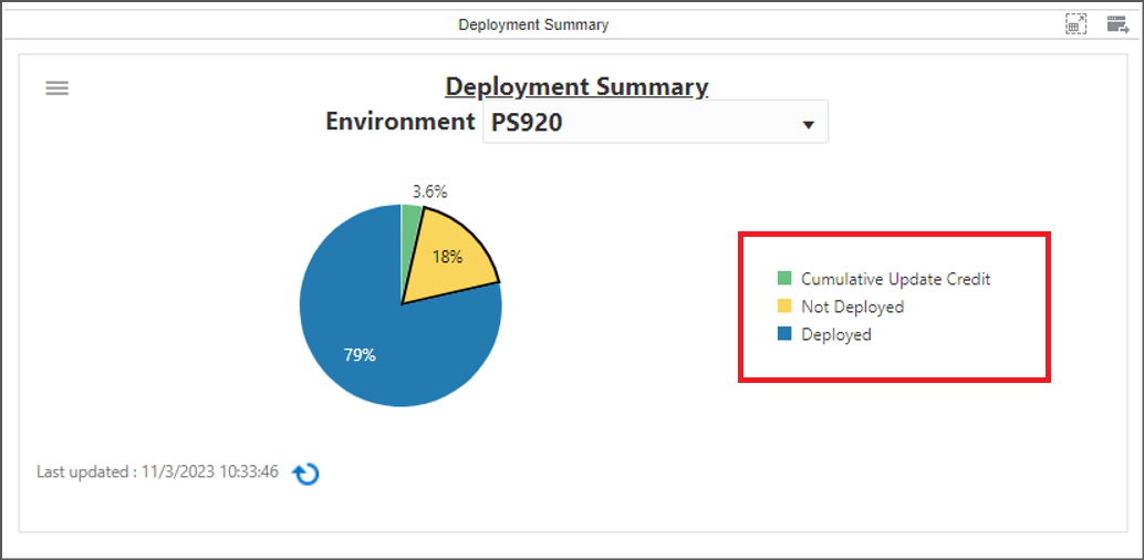

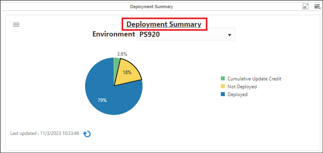

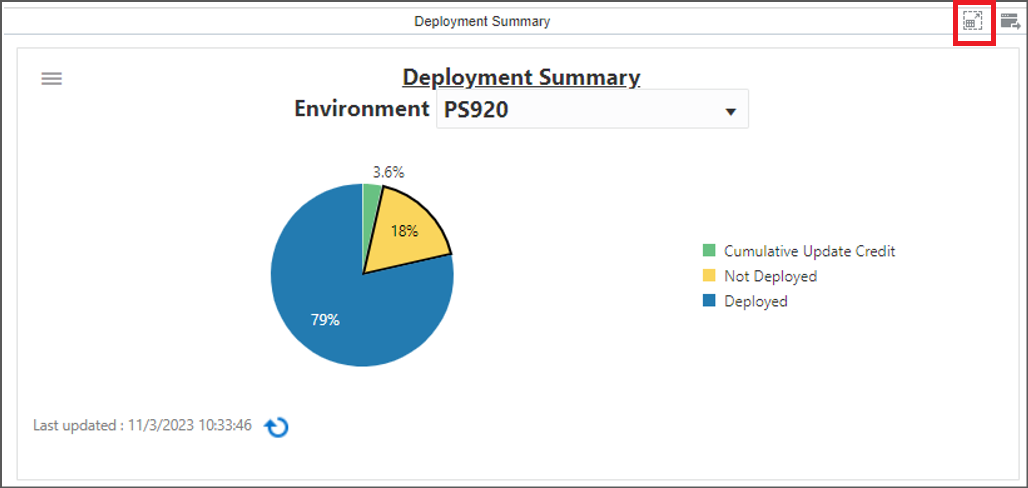

- To review deployment summary for the specified environment
PS920, use the Deployment Summary chart:- In the Deployment Summary tray, click the Menu option to open the pane with filter criteria.
- Set
the Query to
Alland click OK.
Deployment Summary - Filter Criteria
- The
Deployment Summary tray displays a graphical summary of
the deployment status.
Deployment Summary Chart
- Click
Deployment Summary - Export Data
- Click
the component heading Deployment Summary
to drill down to the Impact Analysis Summary View
application.
Deployment Summary - Link to the Application

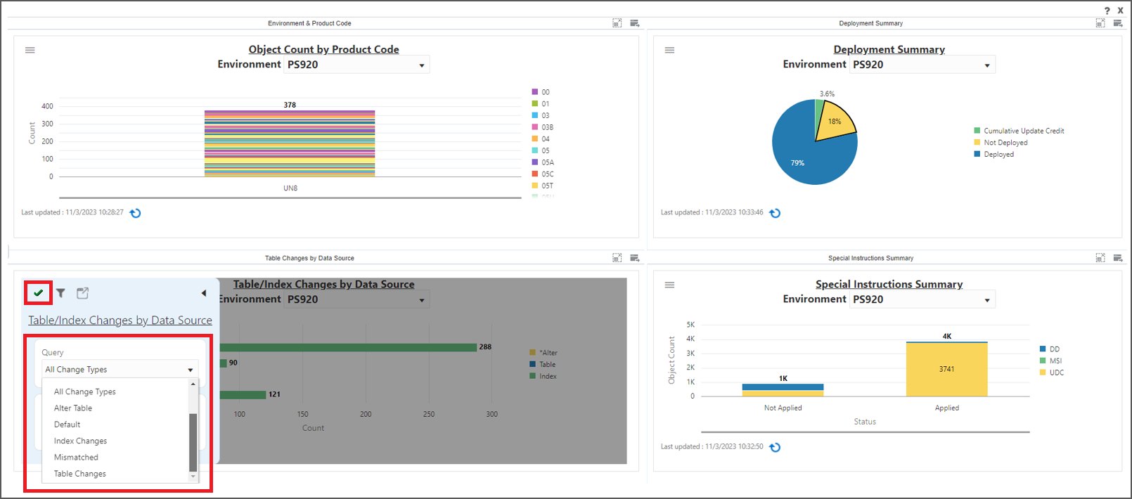

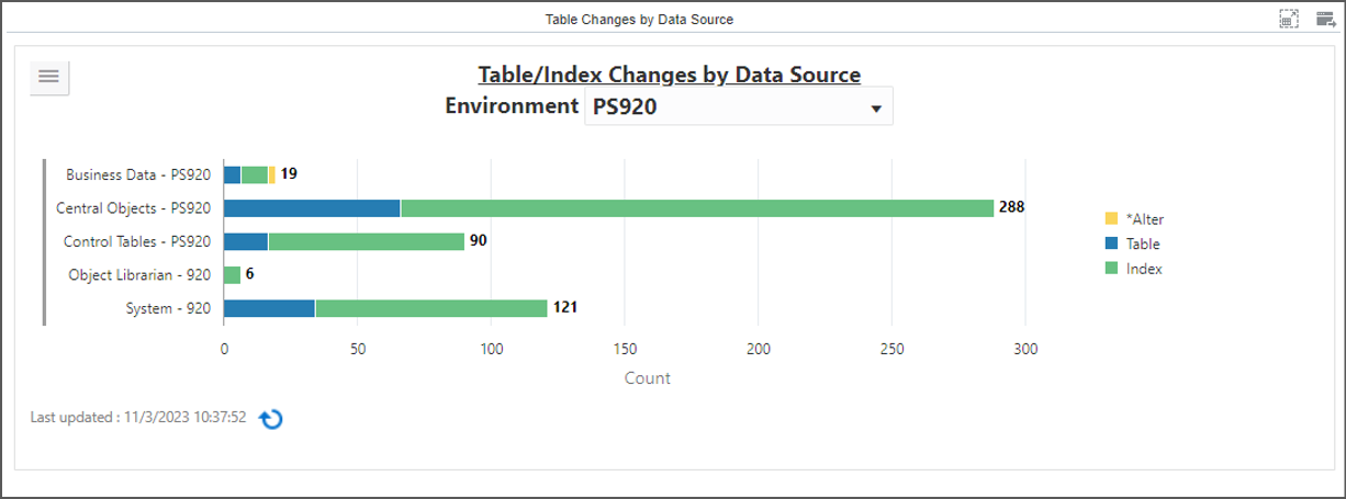

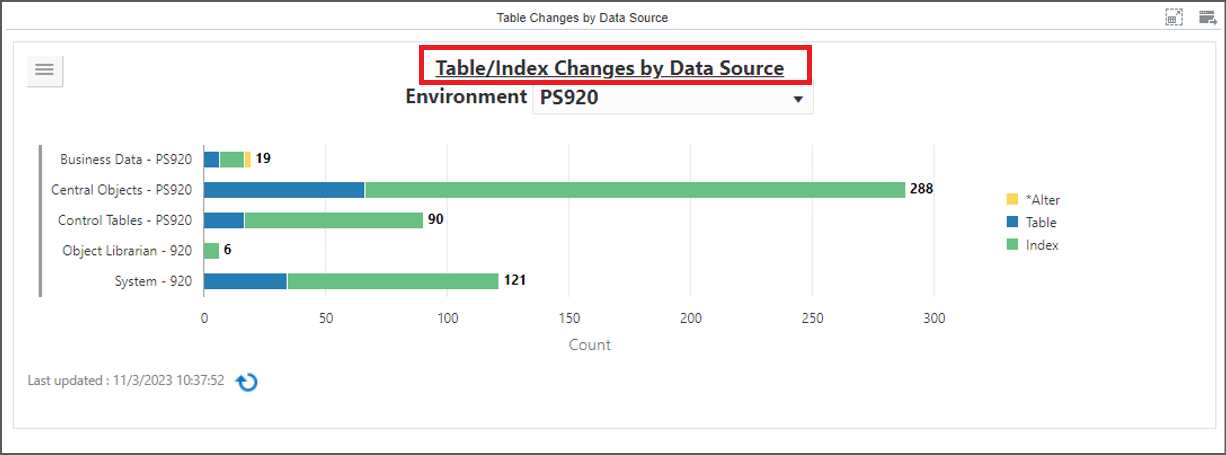

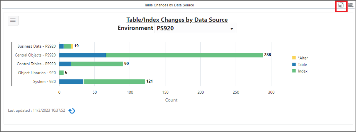

- To review table and index changes by product code for the
specified environment, use the Table Changes by Data Source
chart:
- In the Table Changes by Data Source tray, click the Menu option to open the pane with filter criteria.
- Set
the Query to
Alland click OK.
Table Changes by Data Source - Filter Criteria
- The
Table/Index Changes by Data Source tray displays a
graphical chart that summarizes the view.
Table Changes by Data Source Chart
- Click
Table Changes by Data Source - Export Data Option
- Click
the component heading Table/Index Changes by Data
Source to drill down to the Impact Analysis
Table Change View application.
Table Changes by Data Source - Link to the Application

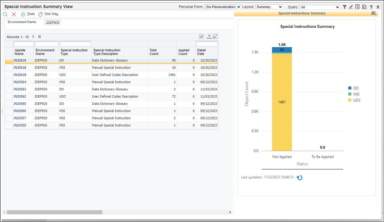

- To review special instructions for the specified
environment, use the Special Instructions Summary chart:
- In the Special Instructions Summary tray, click the Menu option to open the pane with filter criteria.
- Set
the Query to
Alland click OK.
Special Instructions Summary - Filter Criteria
- The
Special Instructions Summary component displays a
Special Instructions Summary Chart
- Click
Special Instructions Summary - Export Data Option
- Click
the component heading Special Instructions
Summary to drill down to the Special
Instructions Summary View application.
Special Instructions Summary Link to the Special Instructions Summary View Form
