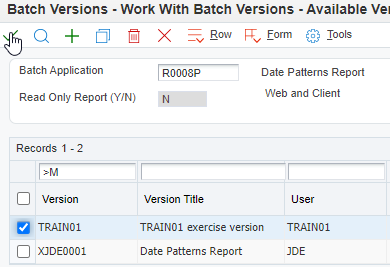

  1. From the Batch Versions – Work with Batch Versions – Available Versions form, select the version you created in the previous OBE and click OK to submit the job.
  2. Batch Versions – Work with Batch Versions – Available Versions Form

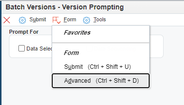

  4. On the Batch Versions – Version Prompting form, select Advanced from the Form menu.
  5. Batch Versions – Version Prompting Form

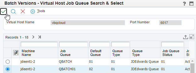

  9. Choose QBatch 01 as the override Queue from the list of all queues on all hosts that are part of the virtual host and click OK.
  10. Batch Versions - Virtual Host Job Queue Search & Select
    Note that when you override the queue for a VBQ host, you are only picking a queue name, and not that specific server. The server part of the line is not used by the submission process except to ensure you see all possible available places the job could run.

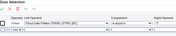

  11. Set your Data Selection as follows:
    • Left Operand = Fiscal Date Pattern (F0008) (DTPN) [BC]
    • Comparison = is equal to
    • Right Operand = Select Literal from the dropdown, enter J as the literal value, and click OK.
  12. Data Selection
    Data Selection

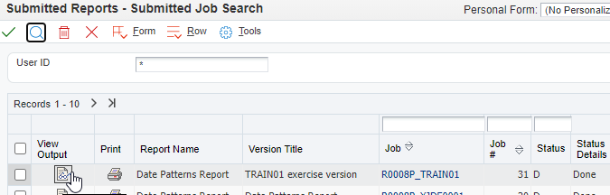

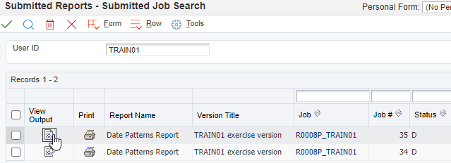

  17. Click View Output in the grid row for the job you have submitted.
  18. Submitted Reports - Submitted Job Search Form
    The system will download the report and can open it in your system PDF viewer.

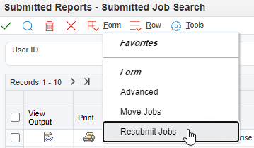

  1. From the Work With Server Jobs form, select Resubmit Jobs from the Form menu.
  2. Form Menu
    Form Menu

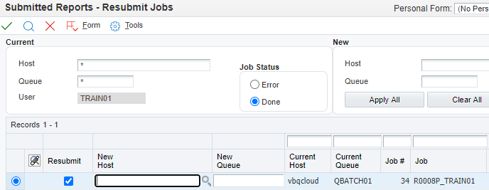

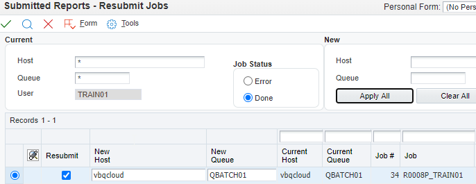

  3. On the Submitted Reports – Resubmit Jobs form, select Done in the Job Status section and then click Search.

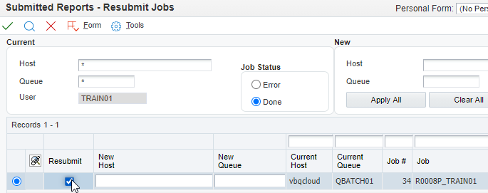

  4. To resubmit a job to a virtual server, click the Resubmit checkbox corresponding to the job you want to resubmit.
  5. Submit Reports - Resubmit Jobs Form
  6. To change the server, click the New Host field and either type or use the QBE to select a different server. For this task, as the job is being run on the same host, press the Tab key to skip the New Host field.
  7. Submit Reports - Resubmit Jobs Form
  8. To change the queue, click the New Queue field and either type or use the QBE to select a different queue. For this task, as the job is being run on the same queue, press the TAB key to skip the New Queue field.
  9. Submit Reports - Resubmit Jobs Form
  10. Click OK to resubmit the job.

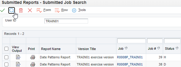

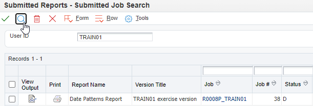

  11. Click Search in the Submitted Reports application to see the newly resubmitted job.
  12. Submitted Reprots - Submitted Job Search Form
    Note that the Host and Actual Host columns are updated. Verify whether your resubmitted job was processed on the same or a different actual host. Repeat the resubmission process (steps 1–6) one or more times if you want to process the job on a different host.
    Host and Actual Hosts Columns
    Host and Actual Host Columns

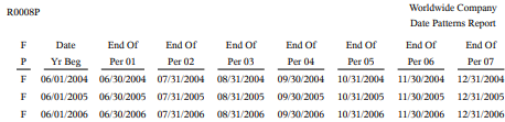

  13. Click View Output in the grid row for the resubmitted report.
  14. Submitted Reprots - Submitted Job Search Form
  15. View the PDF file and note that the resubmission preserved the Data Selection from the previous run:
  16. Submitted Report
    Submitted Report

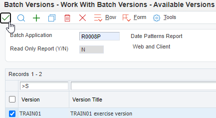

  1. From the Fast Path, run application BV – Batch Versions.
  2. From the Batch Versions – Work with Batch Versions – Available Versions form, select the version you created in the previous exercise and click OK to submit the job.
  3. Batch Versions – Work with Batch Versions – Available Versions Form

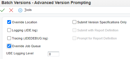

  6. On the Batch Versions – Advanced Version Prompting form, select the following check boxes and then click OK.
    • Override Location
    • Override Job Queue
  7. Batch Versions – Advanced Version Prompting Form

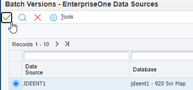

  8. Click Submit.
  9. Select jdeent1 as the override location and click OK.
  10. Batch Versions – EnterpriseOne Data Sources Form

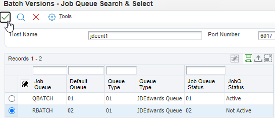

  11. On the Batch Versions – Job Queue Search & Select form, select RBATCH (note that this job queue is not active) and click OK.
  12. Batch Versions – Job Queue Search & Select Form

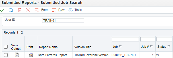

  14. Navigate to the shortcut wsj.

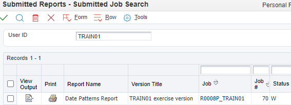

  15. Note that the status of the job you submitted is W (Waiting).
  16. Scroll to the right of the Submitted Reports – Submitted Job Search page and find the Host and Actual Host columns.
  17. Note that the server is jdeent1 and the actual host has not been assigned yet, as the job is waiting.

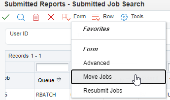

  18. Now, to move the job to the vbqcloud server, select Move Jobs from the Form menu.
  19. Form Menu
    Form Menu

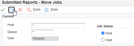

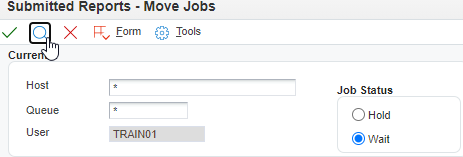

  20. On the Submitted Reports - Move Jobs form, select Wait from the Job Status section and click Find.
  21. Submit Reports - Move Jobs Form

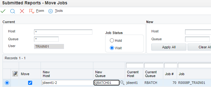

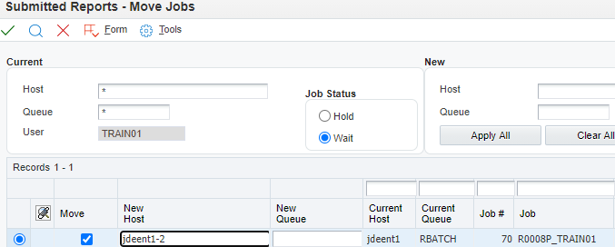

  22. To move a job to the virtual server, select the check box in the Move column next to the job you want to move.
  23. Submit Reports - Move Jobs Form
  24. To move the job to a different server, click the New Host field and type or use the Visual Assist to select jdeent1-2 or jdeent1-3 as the server.
  25. Submit Reports - Move Jobs Form
  26. To change the queue, click the New Queue field and type or use the Visual Assist to select your custom queue and then click OK to move the job.
  27. Submit Reports - Move Jobs Form
  28. Select Find to view newly moved jobs.

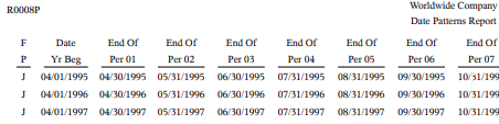

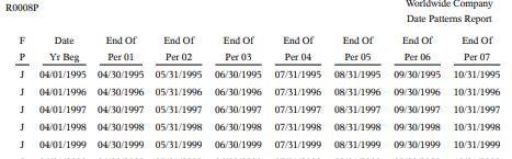

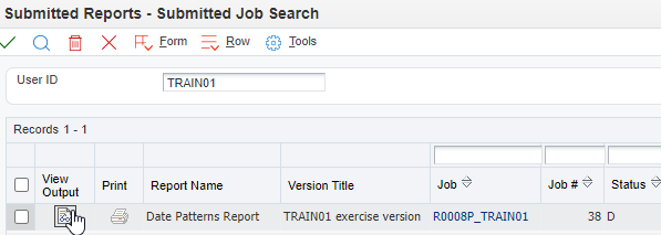

  30. Click View Output to view the report of the moved job.
  31. Submitted Reprots - Submitted Job Search Form
    The report should look like this:
    Submitted Report
    Submitted Report

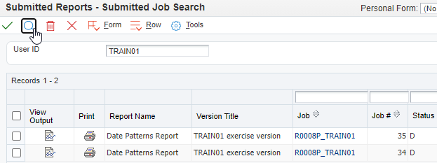

  32. Repeat the above steps to submit another R0008P with the version TRAIN01. Remember to use the Advanced option in the Form menu to be able to override the server to jdeent1 and job queue to RBATCH to get another job on jdeent1 in the waiting status.
  33. Submitted Reprots - Submitted Job Search Form
    Submitted Reports – Submitted Job Search Form

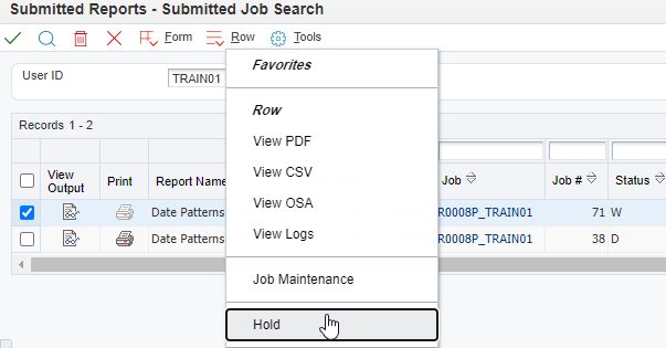

  34. On the Submitted Reports – Submitted Job Search form, select the job that is in the waiting status and then from the Row exit select Hold to move the job to a held status.
  35. Form Menu - Hold
    Form Menu - Hold

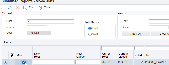

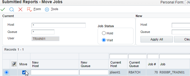

  39. On the Submitted Reports - Move Jobs form, note that the Hold check box is already selected. Click Search.
  40. Submit Reports - Move Jobs Form

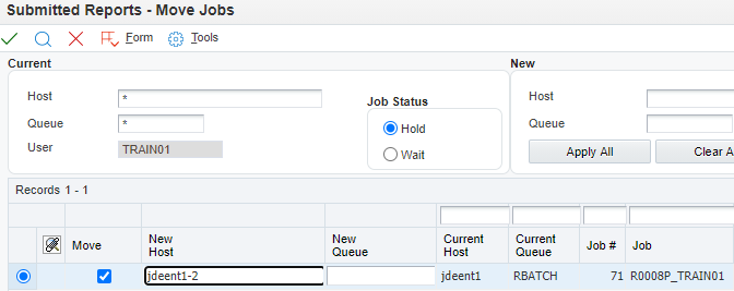

  41. To move a job to the virtual server, first select the check box in the Move column next to the job that you want to resubmit.
  42. Submit Reports - Move Jobs Form
  43. To move the job to a different server, click the New Host field and type or use the Visual Assist to select jdeent1-2 or jdeent1-3 as the server.
  44. Submit Reports - Move Jobs Form

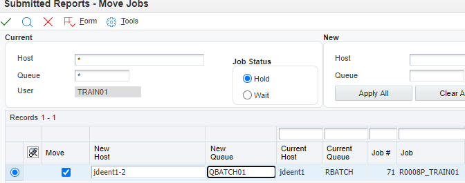

  45. To change the queue, click the New Queue field and type or use the Visual Assist to select your custom queue. Then, click Ok to move the job.
  46. Submit Reports - Move Jobs Form
  47. Click Search now that you are back in the Submitted Reports application to see the newly moved (and still held) job.
  48. Submitted Reprots - Submitted Job Search Form

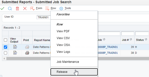

  49. On the Submitted Reports – Submitted Job Search form, select the job that is in the waiting status and then click the Row exit and select Release to release the job from the W (waiting) status.
  50. Form Menu
    Form Menu
