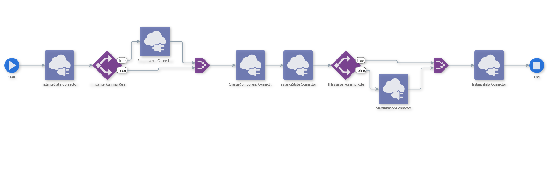

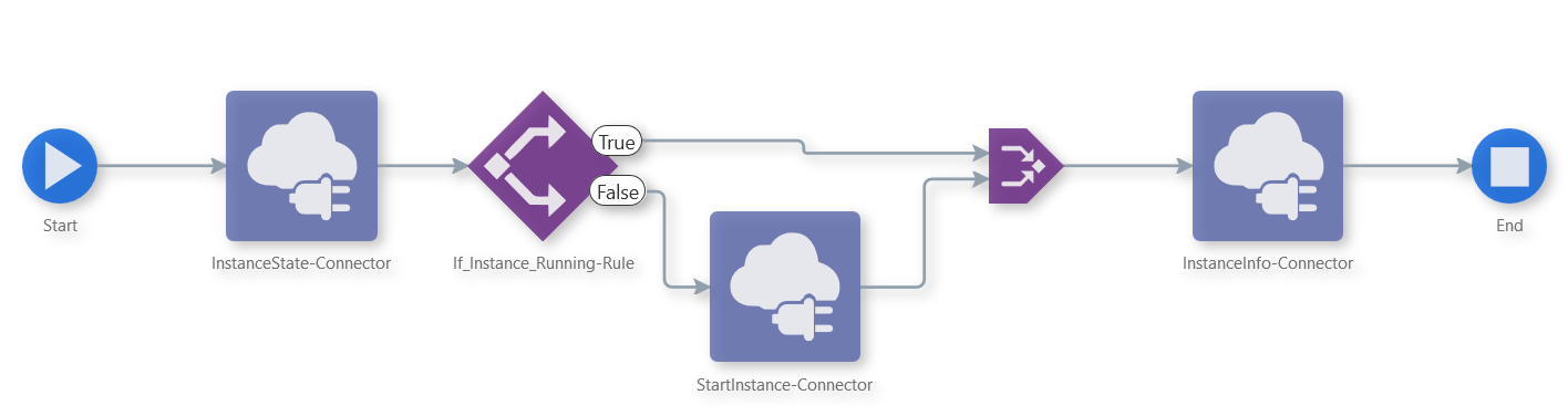

For this tutorial, the administrative orchestration, StartInstance-Orchestration, will be used to bring up the EnterpriseOne HTML and Enterprise Servers:
The administrative orchestration, ChangeComponent-Connector, will be used to update the EnterpriseOne HTML Server component:

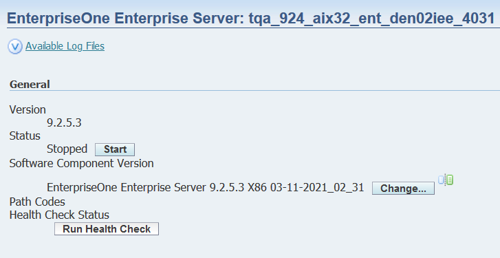

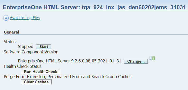

- Log in to Server Manager Console as the jde_admin user, if
you are not already logged in, and verify that the
EnterpriseOne HTML and Enterprise Servers are in the Stopped
state.
HTML server in Stopped state
Enterprise server in Stopped state - Log in to the JD Edwards EnterpriseOne Orchestrator Studio as the jde_admin user.

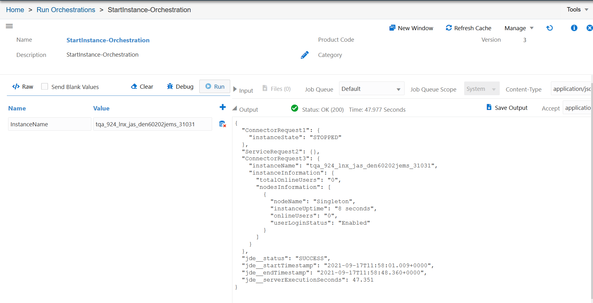

- On the Orchestrator Studio Home page, click the Run Orchestrations icon.
- On the Run Orchestrations page, search for the StartInstance-Orchestration orchestration, and then select the orchestration. This orchestration will bring up the EnterpriseOne HTML server.
- Enter the orchestration input values. In the Value
field for the InstanceName input, for this
tutorial, enter the HTML server instance name, for example,
tqa_924_lnx_jas_den60202jems_31031. - Click Run.
The Run Orchestrations page displays a green check mark to indicate that the orchestration completed successfully.
The Run Orchestrations page should look like this:

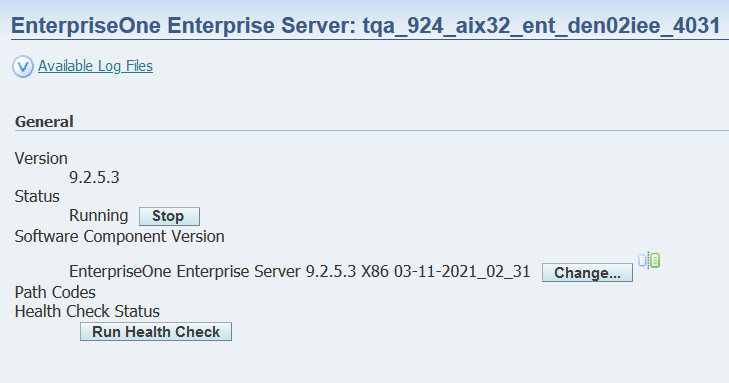

StartInstance-Orchestration orchestration output - Click the Run Orchestrations link and repeat Steps 4 through 6 to bring up the EnterpriseOne Enterprise Server.
- Log in to the Server Manager Console as the jde_admin user,
if you are not already logged in, and verify that the
EnterpriseOne HTML and Enterprise Servers are in the Running
state:
EnterpriseOne HTML server in Running state
EnterpriseOne Enterprise server in Running state

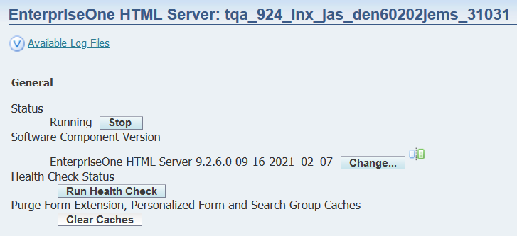

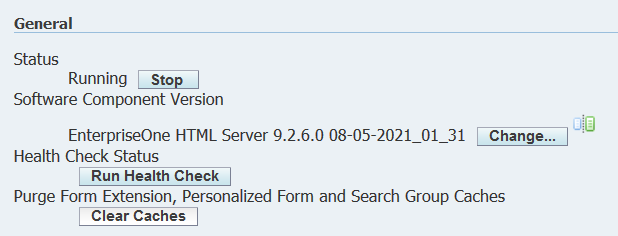

In this task, you will run the system administrative orchestration to update the EnterpriseOne HTML Server component to a later version. For this tutorial, the EnterpriseOne HTML Server component version will be updated from E1_HTMLServer_9.2.6.0_08-05-2021_01_31 to E1_HTMLServer_9.2.6.0_09-16-2021_02_07.
if you are not already logged in, and check the version of the
EnterpriseOne HTML Server component.

ChangeComponent-Connector orchestration output - Log in to the Server Manager Console as the jde_admin user
if you are not already logged in and verify on the
EnterpriseOne HTML Server window that the component change is
successful:
Updated EnterpriseOne HTML Server component version - Log out of the Orchestrator Studio.
