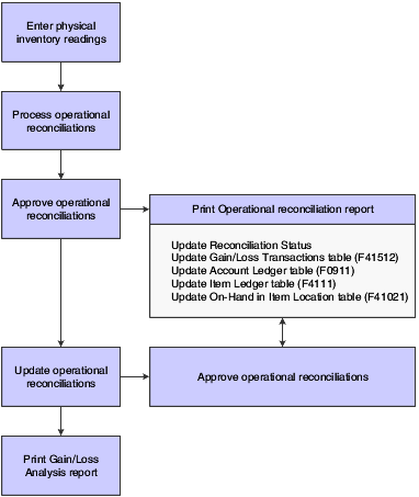

This flowchart illustrates operational reconciliation:
Operational reconciliation
