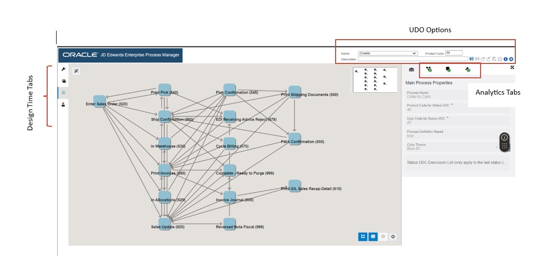

  6. Click OK. The Main Module tab is displayed in the Enterprise Process Manager window, where you can see the automatically generated enterprise process diagram based on the values defined in the Create Process window and the Order Activity Rules that you set.
    Main_Module_tab
    The enterprise process diagram displays nodes and the links between the nodes. The nodes represent the tasks in the process template and the links represent the connection between the nodes.

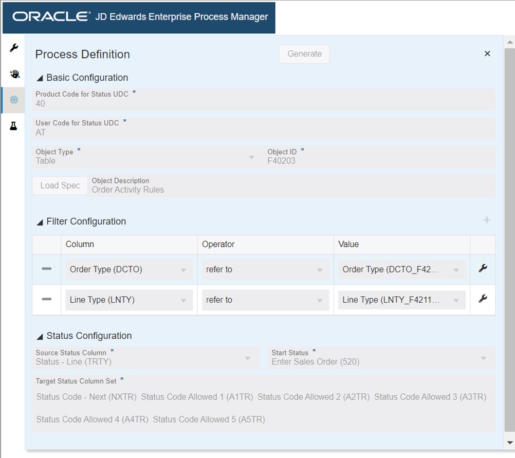

  7. Click the Open Process Definition icon (next to Design Option) to review the settings in the read-only tab with Basic Configuration, Filter Configuration, and Status Configuration details.
    process definition
    The Process Definition window opens. You can view the Basic Configuration, Filter Configuration and Status Configuration details based on the values defined in the Create Process window and the order activity rules that you have set. These configurations are used to build the nodes and links and to automatically generate the process model.
    • The Basic Configuration section displays the UDC - Activity/Status Codes (40/AT) and the table that the system uses to generate the template - Order Activity Rules table (F40203).
    • The Filter Configuration section displays the columns based on which the data is filtered. The system filters the data based on Order Type and Line Type values for the Order to Cash process modeler.
    • The Status Configuration section displays Source Status Column, the Start Status (starting node) and Target Status Column Set. For the Order to Cash process model, the start status is set to Enter Sales Order (520).
