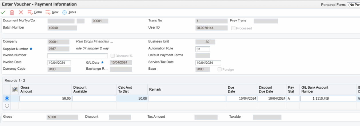

    Let us select this example voucher entry, you can see the following entries in this voucher:
    Company: 0001
    Supplier Number: 9767
    Business Unit: 30
    Automation Rule: 07
    Batch Number: 40940
    Total Taxable Amount: 50

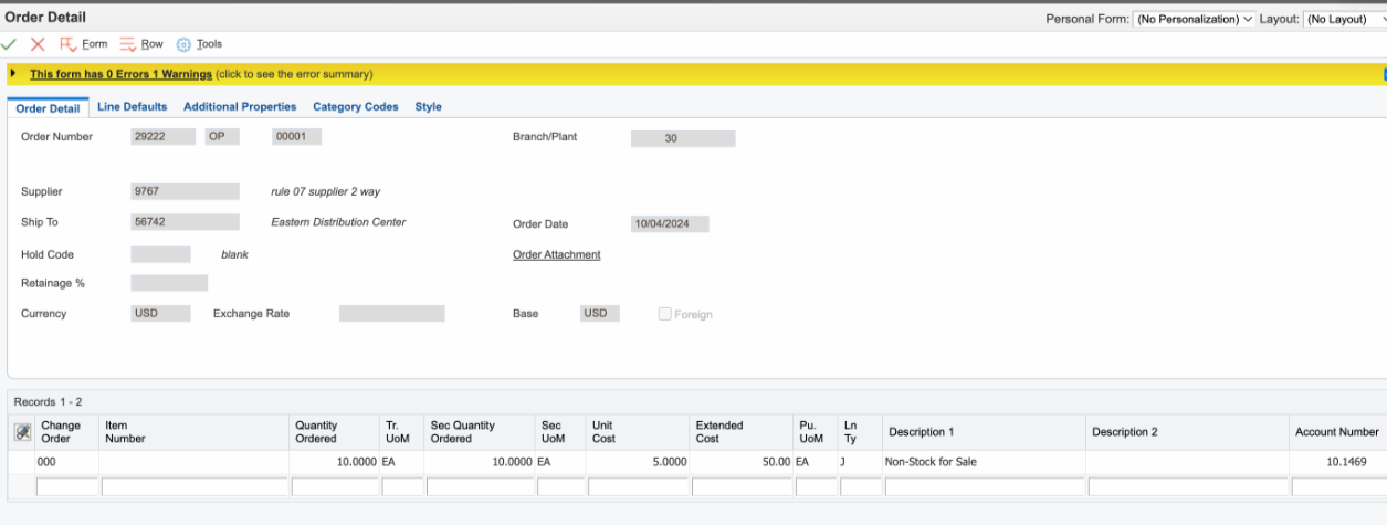

  4. Navigate to EnterpriseOne Menus, Supply Management, Procurement and Subcontract Management, Daily Processing, Stock Based Purchasing, Purchasing Inquiries, Open Orders program.
  5. Search the list of open purchase orders in your system. In the Invoice date column, you can search with current date.
    The system lists all the open purchase orders.
    For this OBE, Order Number 29222 is selected to explain the two-way voucher match automation process.
    Description of sample-image-1.png follows
    Order Detail Application

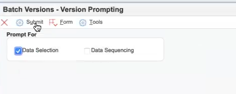

  1. Navigate to EnterpriseOne Menus, Supply Management, Procurement and Subcontract Management, Procurement Advanced and Technical Ops, Automation Voucher Processing, Automated Voucher Match Process – Non logged voucher.
  2. In the Batch Versions - Version Prompting page, select the Data Selection checkbox and click submit.
  3. Description of sample-image-1.png follows

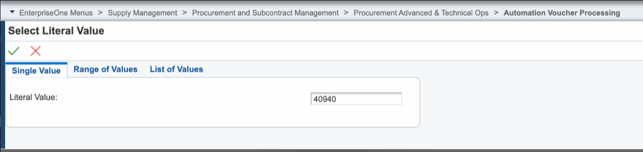

  4. You can provide the criteria for the purchase order data that must be displayed in the report.
    In this example, the data selection criteria are specified to list the purchase orders with the Batch Number as 40940.
    Select Literal Value
  5. Click OK.

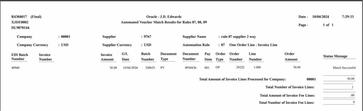

  6. Open the downloaded report from your system.
    R4304017 Report
    The sample report in this example shows the information about the Company, Company Currency, Supplier, Supplier Currency, Supplier Name, Automation Rule, and so on.
    The table in the report displays the Batch Number, Invoice Amount, Matched Order Number, Document Number, and Order Amount. It also shows details such as Status, Total Amount, and the Total Number of Invoice Lines.
    The system uses the Two-Way Automation Rule 07 to perform an exact match of invoice amount to purchase order amount for the specified supplier.
    The Status is printed as “Matched Successful” and the Total Amount and the Total Number of Invoice Lines are also displayed in the report.

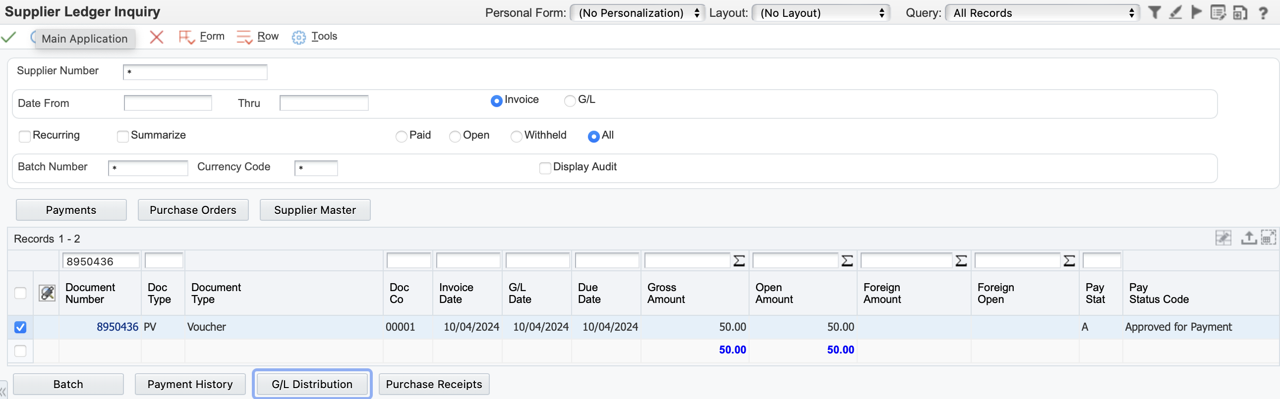

  8. In the Supplier Ledger Inquiry application, enter a document number and click search. For this OBE, Order Number 8950436 is selected to explain the two-way voucher match automation process.
  9. The system displays the record for the document number. Select the record and click G/L Distribution.

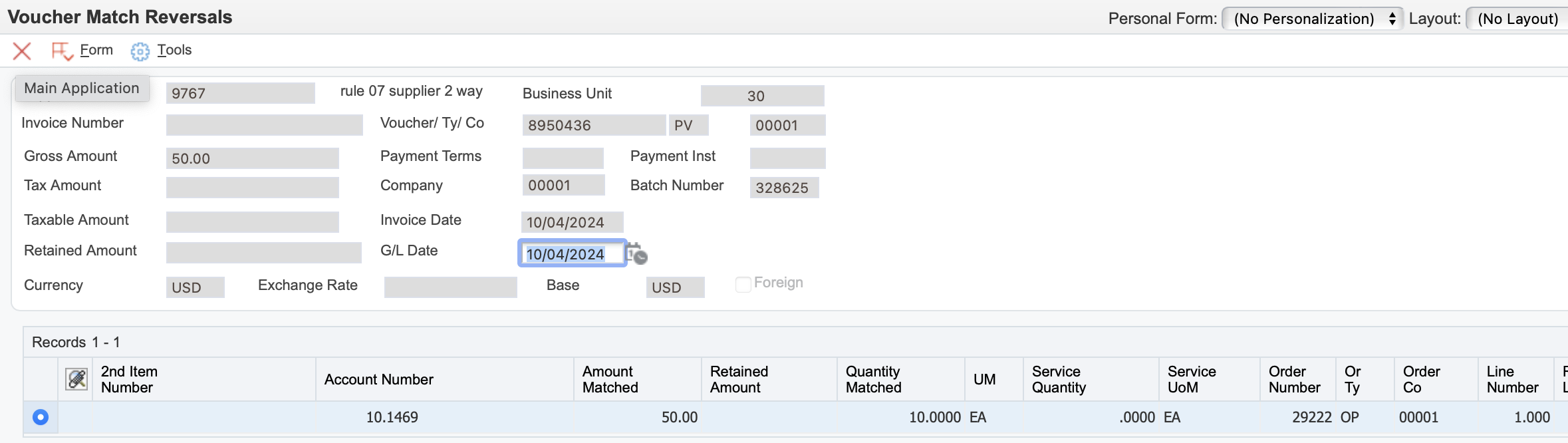

    The Voucher Match Reversal application displayed the voucher created after matching the open order with open receipts using two-way voucher match automation process.

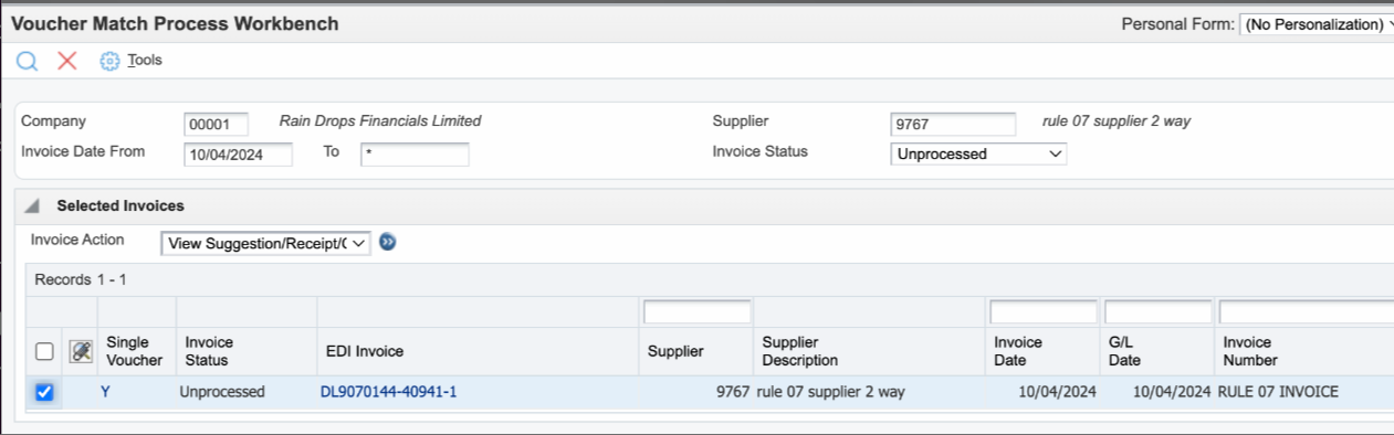

section 3Processing Open Invoices Against Open Purchase Orders in Workbench Application

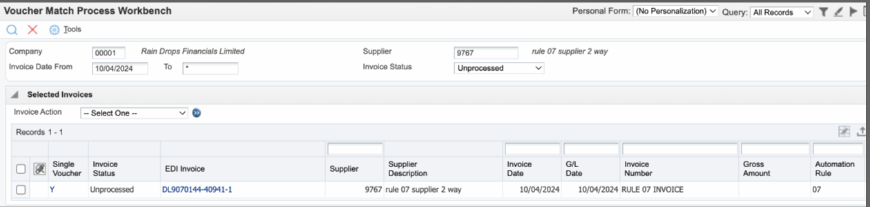

  1. Navigate to EnterpriseOne Menus, Supply Management, Procurement and Subcontract Management, Procurement Advanced and Technical Ops, Automation Voucher Processing, Voucher Match Process Workbench.
    We can review the following details:
    Company: 00001
    Invoice Date: Current Date
    Supplier: 9767
    Invoice Status: Unprocessed

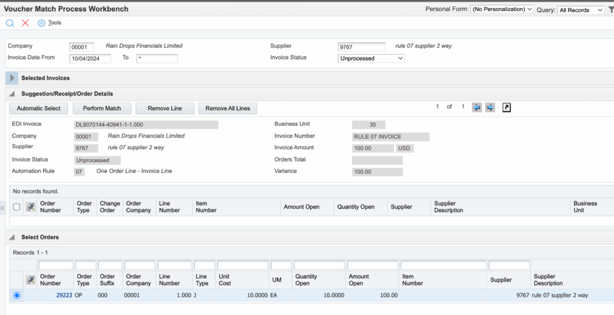

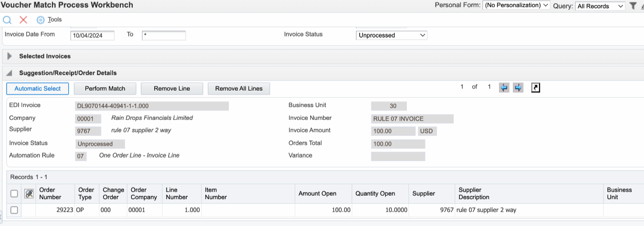

  2. Select View/Suggestion/Receipt/Orders option from the Invoice Action drop-down menu.
    We can review the open purchase orders as in the image below:
    Review open purchase order
  3. Click Automatic Select option. This option automatically selects open purchase orders for the open invoice amount and displays the selected record.

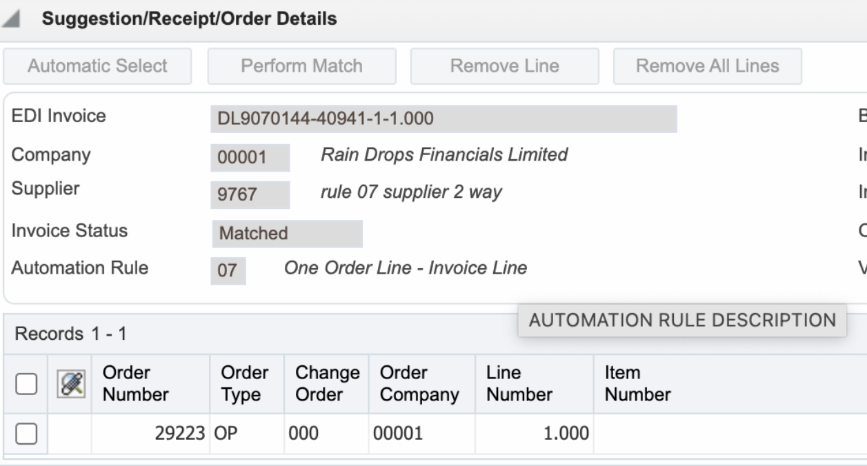

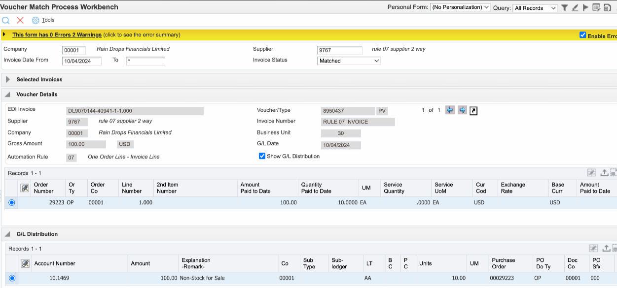

  4. Click Perform Match option to create the voucher.
    Note that the invoice status has changed from unprocessed to Matched.
    Status changed to matched

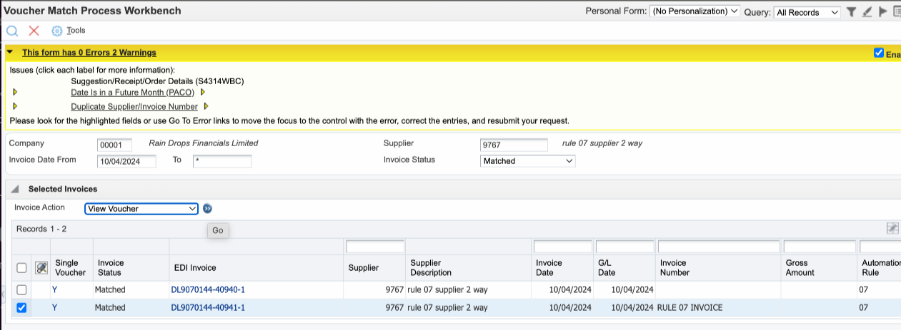

  5. Review matched invoices using View Voucher option in the Invoice Action field for the matched record.
    View Voucher
  6. You can view the voucher and the G/L Distribution details.
