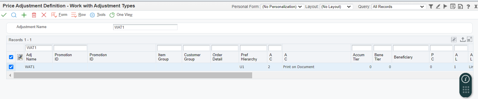

  2. Enter the Adjustment Name as WAT1. Search and select this adjustment from the table and click OK.
    Price Adjustment Definition program

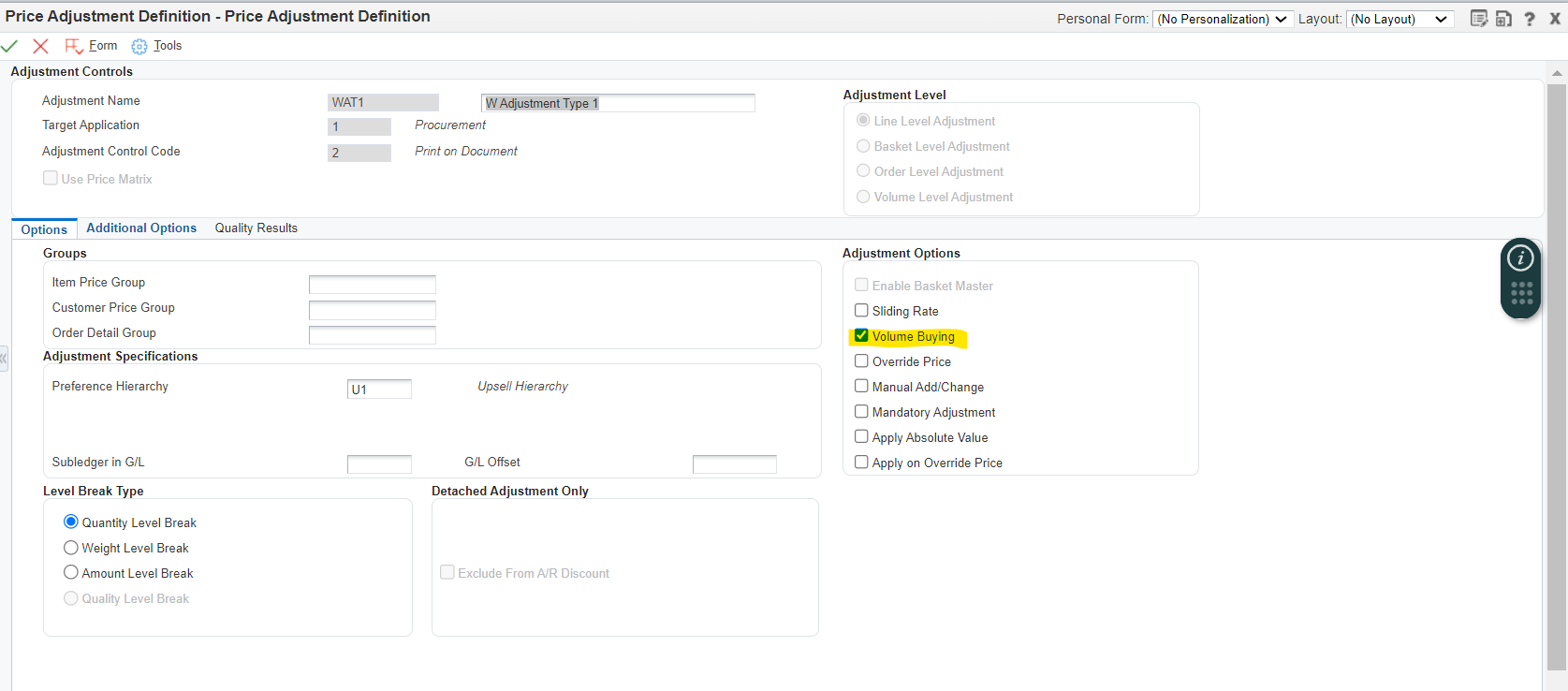

  3. Make sure the Volume Buying check box is selected under the Adjustment Options section in the Price Adjustment Definition program. Close this program.
    Volume Buying check box - Price Adjustment Definition program

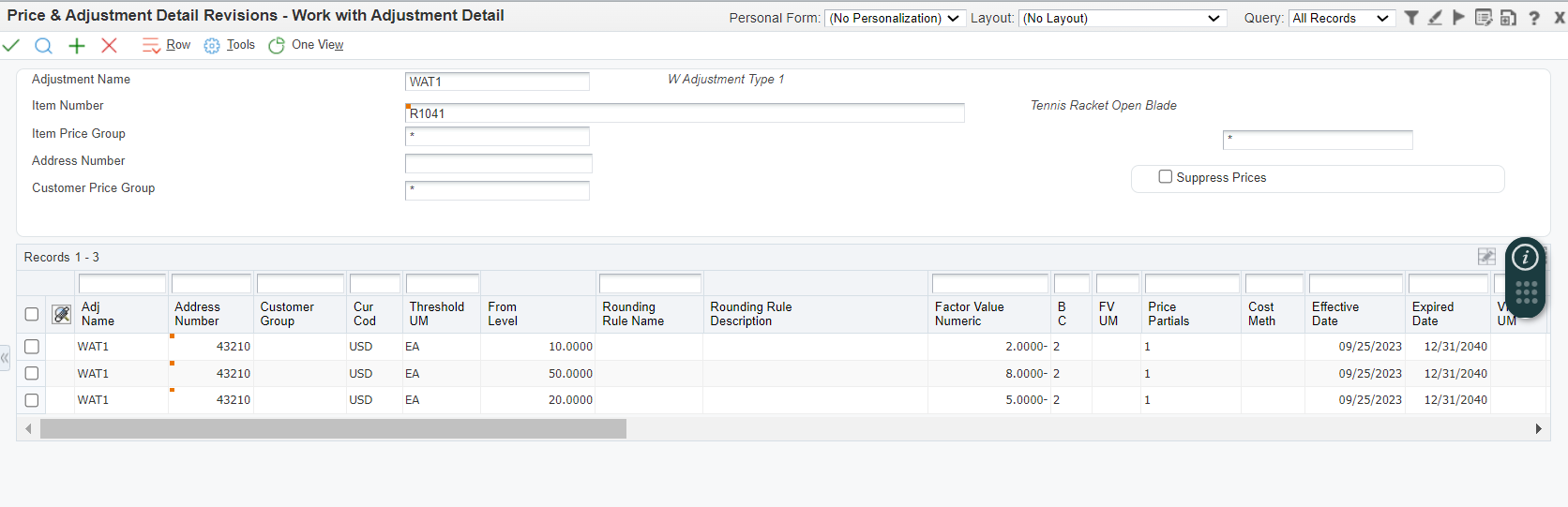

  4. Now, click the Adjustment Setup from the navigation and select Price & Adjustment Detail Revisions program. The Price & Adjustment Detail Revisions program (P4072) is displayed.
  5. Enter values in the adjustment name as WAT1 and item number as R1041 fields and click find icon.
    Price and Adjustment Detail Revisions program
    The Adjustment list is displayed in the table.
  6. Select an adjustment and click OK.
    You have now set the adjustments for the purchase order item.

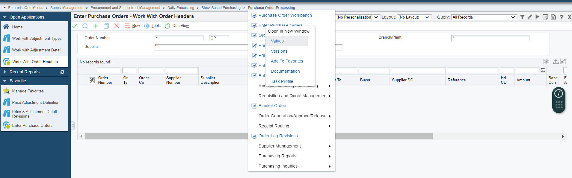

  1. Navigate to EnterpriseOne Menus, Supply Management, Procurement and Subcontract Management, Daily Processing, Stock Based Purchasing, Purchase Order Processing, and Enter Purchase Order.
    The Enter Purchase Orders - Work With Order Headers (P4310) is displayed.
  2. Click the Purchase Order Processing option from the navigation menu. Right-click to open the Enter Purchase Order from the drop-down list and click Values.
    Enter Purchase Order -Values

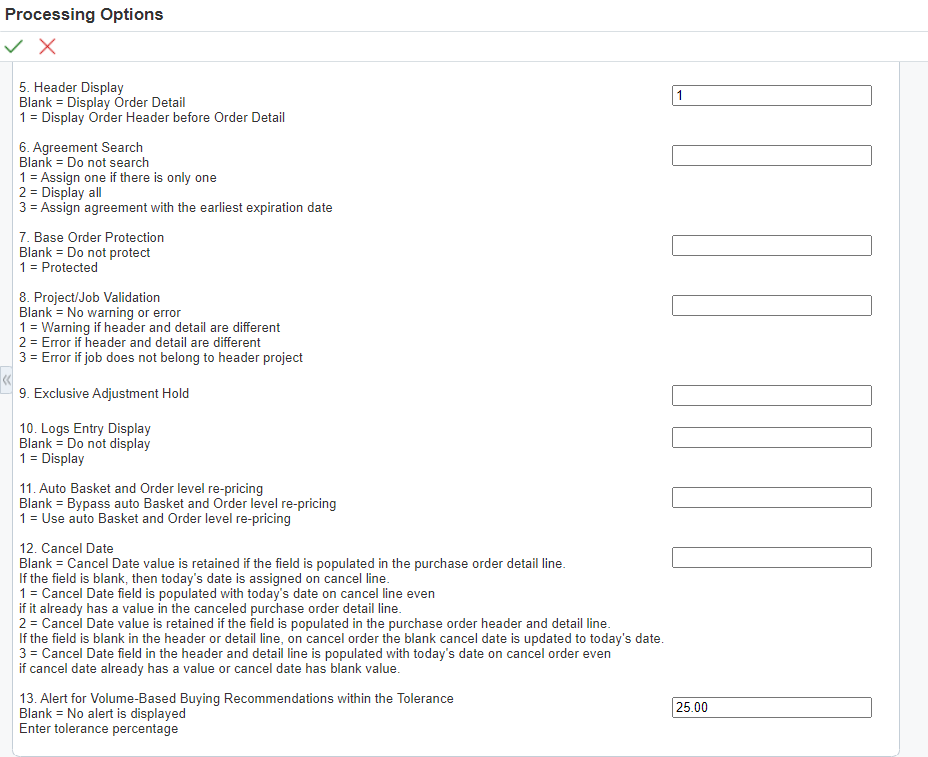

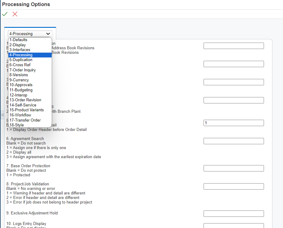

  3. Select the Processing tab from the processing option drop-down menu. Set the tolerance percentage for volume-based buying recommendation in the alert for volume-based buying recommendation processing option.
    Processing Tab
    Processing Tab
  4. Enter the tolerance percentage value in the Alert for Volume-Based Buying Recommendations within the Tolerance processing option. If you leave this field blank, no alert is displayed. In this example, set the tolerance value to 25.
    This tolerance percentage specifies how sensitive the system is when displaying the recommendation. The system checks for buying opportunities by increasing the order quantity on the purchase order line by the tolerance percentage that you specify, and then it determines whether another quantity break is available using the larger quantity.

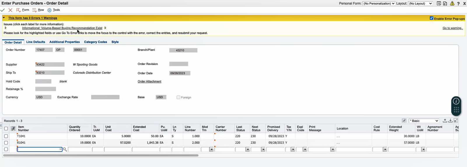

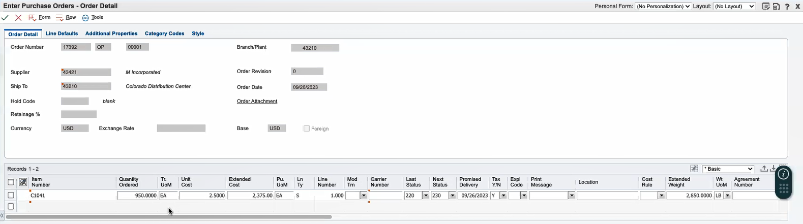

  5. In the Enter Purchase Order program, create new entries by adding the Item Number and Quantity Ordered under the Order Detail tab.
    You can see that the system auto-populates the values for other fields for this item, including Unit Cost, Extended Cost, and so on.

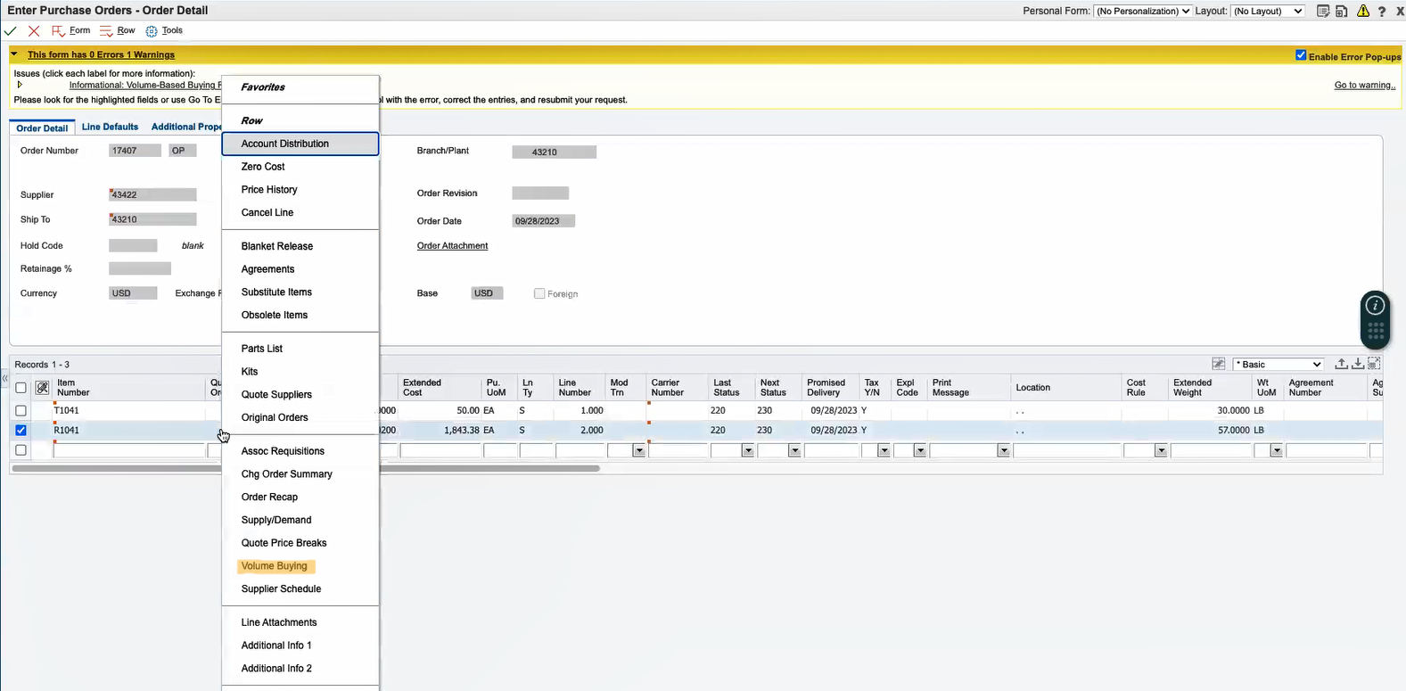

    When you enter the purchase order line for the item number R1041, the system displays a buying recommendation for this order quantity because this item found a volume buying adjustment within the tolerance percentage that is set in the processing option. The screenshot below displays the recommendation message for the second item in the purchase order.
    Recommendation message
  6. To view the buying recommendation, right-click the purchase order row that is eligible for a buying recommendation and select Volume Buying.

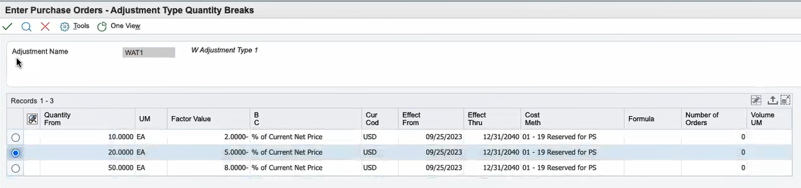

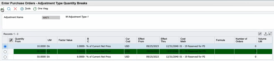

  7. The Enter Purchase Orders- Adjustment Type Quantity Breaks program dynamically identifies and lists all buying opportunities to reduce the item cost and notifies you to increase the quantity and get a better discount on the item. In this example, there are three adjustments listed for the selected item.
  8. Select an adjustment quantity and click OK. You can see that the selected quantity row is highlighted.
    In this example, the item quantity is entered as 19 for the second item in the purchase order. The item was eligible for a 2% discount from the supplier. But with the new volume-based buying recommendation feature, the system displays a message stating that if you increase the item quantity to 20 (This quantity increase is within the tolerance level of 25% set in the processing option ), you are eligible for a 5% discount for the same item. When you select the new adjustment in the Adjustment Type Quantity Breaks program, the item quantity is automatically updated in the Purchase Order program.
    Adjustment Quantity
    Adjustment Quantity

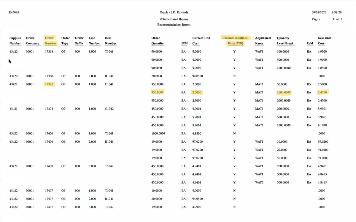

section 4Using the Volume-Based Buying Recommendation Report
There are many ways of creating a purchase order apart from using the Enter Purchase Orders program. You can create new purchase orders using electronic data interchange (EDI), Orchestrations, or Business Services (BSSV).
To know or search for the recommendations for the items ordered using the above methods, we use the Volume-Based Buying Recommendation report.

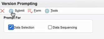

  2. In the Version Prompting page, select the Data Selection checkbox and click submit.
    Version Prompting Page

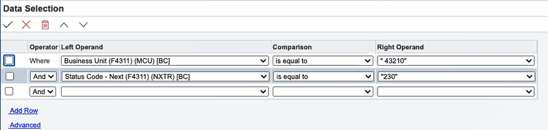

  3. You can provide the criteria for the purchase order data that must be displayed in the report.
    In this example, the data selection criteria are specified to list the purchase orders with the Business Unit as 43210 and the Status Code for the item as 230.
    Data Selection
    Data Selection

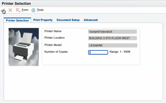

  5. Specify the printer details and click OK.
    Printer Selection
    Printer Selection
    The report is downloaded to the Download folder on your system.
  6. Open the downloaded report from your system.
    You can see that the sample report below has information about the Supplier, Order Company, Order Number, Type, Recommendations Exists, and so on.
    Volume-Based Buying Recommendations Report
    The Recommendation column displays Yes if there is an opportunity to get more discounts on the items when you increase the quantity. You can access the respective purchase order from the Enter Purchase Order – Order Header program and make the required quantity adjustment for the item. In this way, Volume-Based Buying Recommendations report can also help you to know of a buying recommendation.
    From the above report, the purchase order “17392” is eligible for a volume-based buying recommendation. Let us view the purchase order entry and update the item quantity.

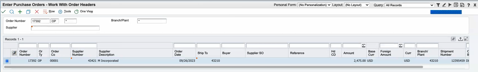

  7. Access Enter Purchase Orders – Work With Order Headers program and Enter the Order Number as “17392” and click find. The order is displayed in the table.
    Work With Order Headers Program

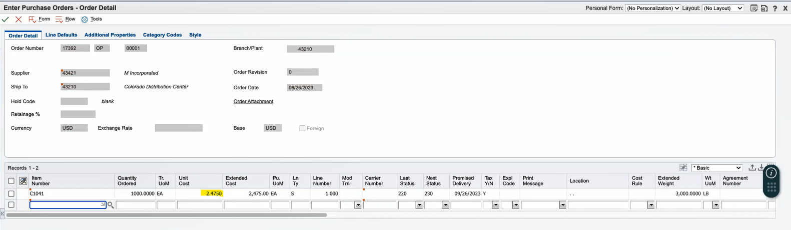

  8. Select the order item row in the table and right-click to access the row exit options. Click the Detail Revision option from the list.
    The Order Details program is displayed with the ability to change the values in the row.
    Order Details Program
  9. Change the Order quantity to 1000 to receive a reduction in the unit price from 2.5000 to 2.4750.
    Updated Unit Cost
    Updated Unit Cost
    In this way, the JD Edwards Advanced Pricing system for Procurement automatically notifies you that a different level break can be achieved by increasing the quantity ordered by a specific percentage thereby, optimizing your discounts and making the purchasing process efficient with the new volume-based buying recommendations feature.
