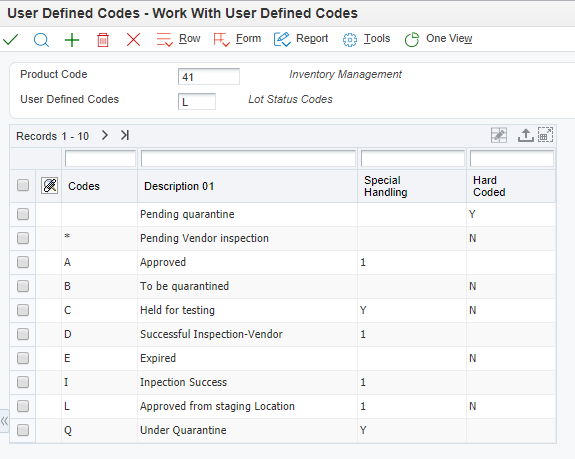

 - Select the codes that will indicate an approved lot status
                  and enter 1 as the special handling code value for these
                  codes.
In this example, codes with blank, A, D, I and L represent an approved lot status.
 UDC Table Note: Codes that contain special handling code values other than 1 indicate that the lot status is unapproved or on hold. If you want to use a blank code as an approved lot status, the special handling code must be 1.

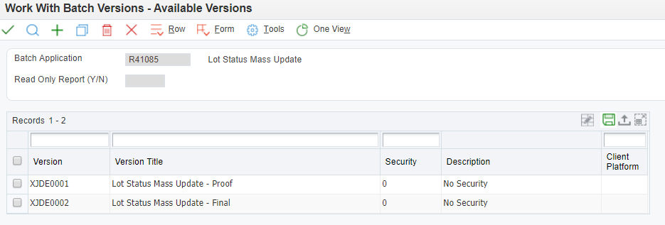

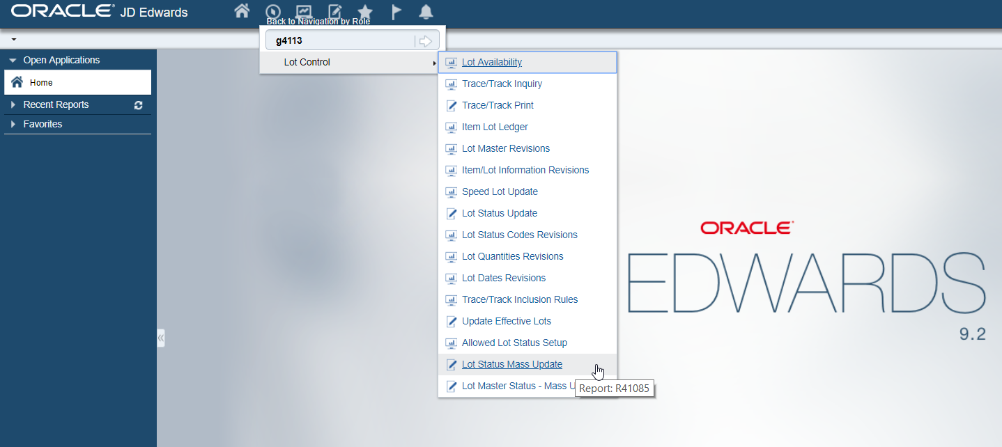

Report Table Updated Lot Status Mass Update (R41085) Item Master – F4101, Item Branch – F4102, Item Location – F41021 Lot Master Status - Mass Update(R41087) Lot Master – F4108  - Use the Fast Path to navigate to the Lot Control (G4113)
                  menu and select the Lot Status Mass Update report (R41085).
                    Fast Path  - Select a version and click the Row tab and select Processing
                  Options.
                    Versions

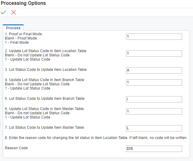

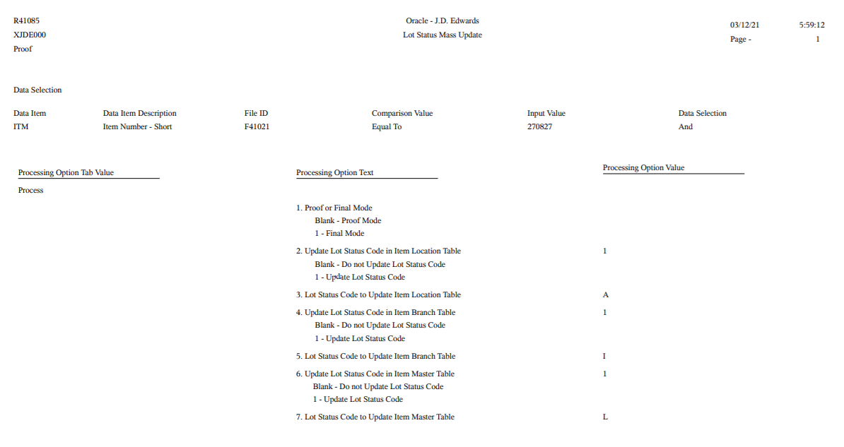

                    Processing Options  - Set the value in the Processing Options 2, 4, and 6 as 1 to update the lot status codes in the tables Item Location, Item Branch, and Item Master. If these processing options are not set to 1, then the tables are not updated.
 - Enter valid lot status codes in the Processing Options 3, 5, and 7. These statuses will be updated in the Item Location, Item Branch and Item Master tables.
 - Run the report with the data that you select from the Item
                  Location (F41021) table.
The PDF output should be similar to this:
                    PDF Output

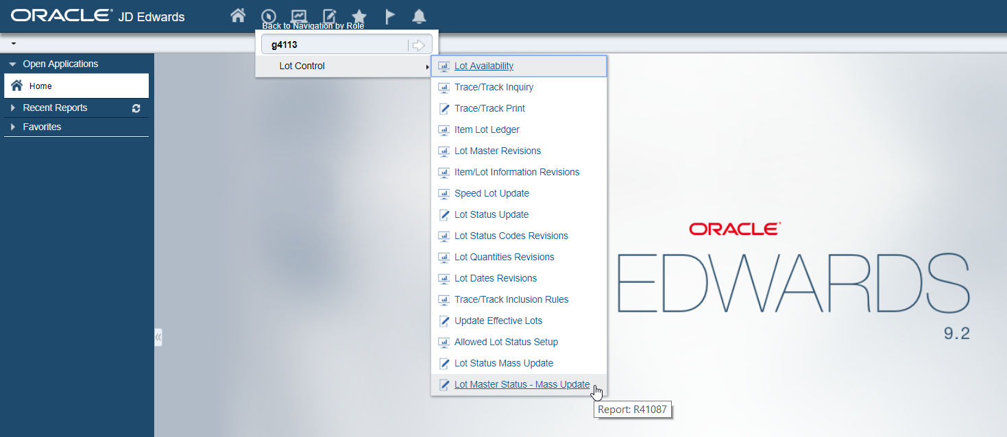

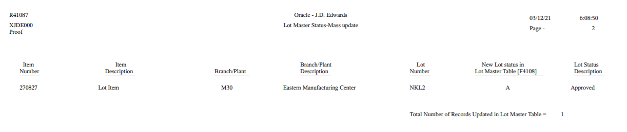

                    PDF Output  - Use the Fast Path to navigate to the Lot Control (G4113)
                  menu and select Lot Master Status - Mass Update report
                  (R41087) to update the lot status in the Lot Master table
                  (F4108).

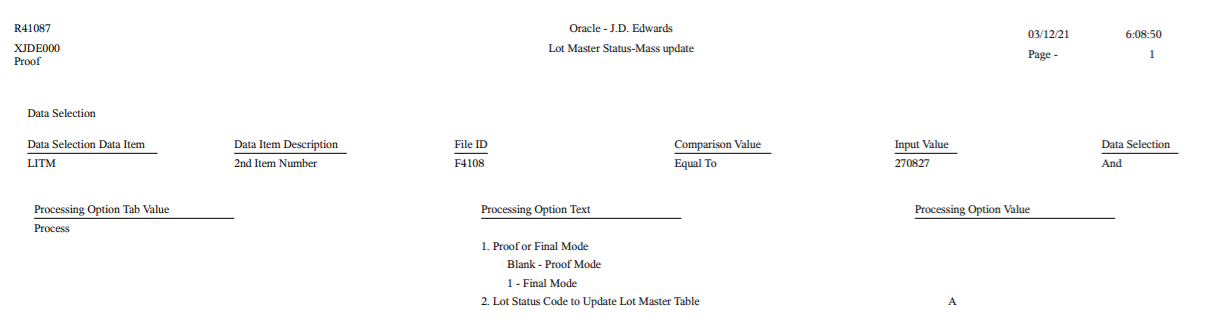

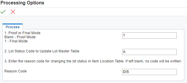

                    Fast Path  - Click the Row tab and select Processing Options.
 - Enter a valid lot status code in Processing Option 2. This
                  status will be updated in the Lot Master table.
                    Processing Options  - Run the report with the data that you select from the Lot
                  Master (F4108) table.
                    PDF Output

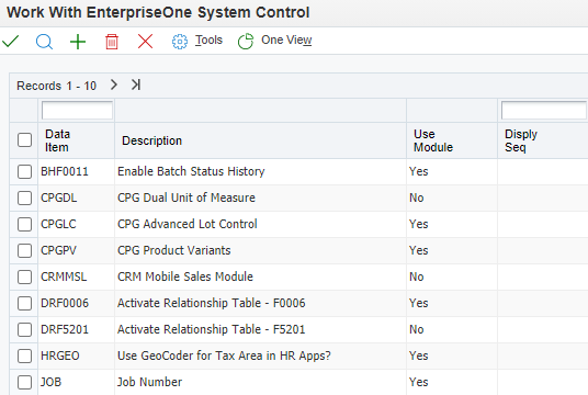

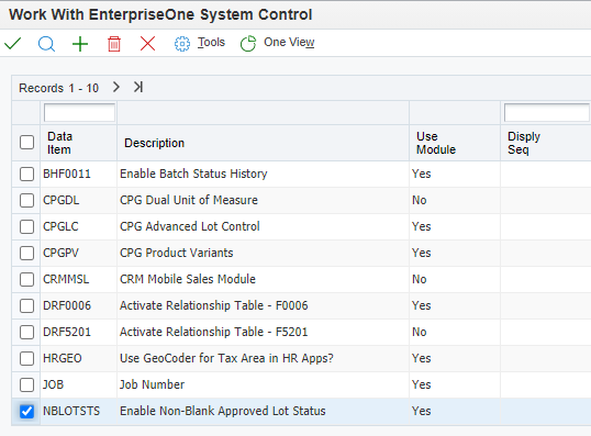

                    PDF Output  - Use the Fast Path to access the Work with EnterpriseOne
                  System Control program (P99410).

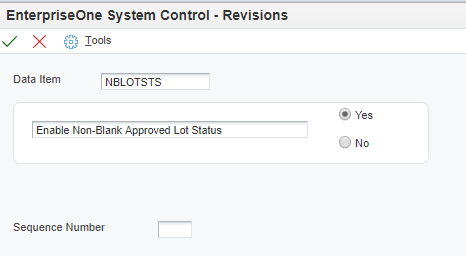

                    Work with EnterpriseOne System Control  - Click Add + and enter NBLOTSTS in the Data Item field and
                  select Yes. Click OK to save the transaction.
                    Data Item Field

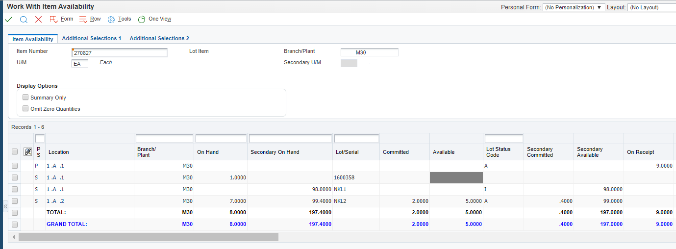

                    Work with EnterpriseOne System Control For example: Note that Item 270827 has the following availability status in the Work with Item Availability program (P41202) after changing the lot status value to blank in location = 1.A.1 with Lot/Serial = 1600358.
                    Availability Status Because a blank code indicates a non- approved lot status, the Available column for that row with Location 1.A.1 and Lot/Serial 160358 is grayed out.

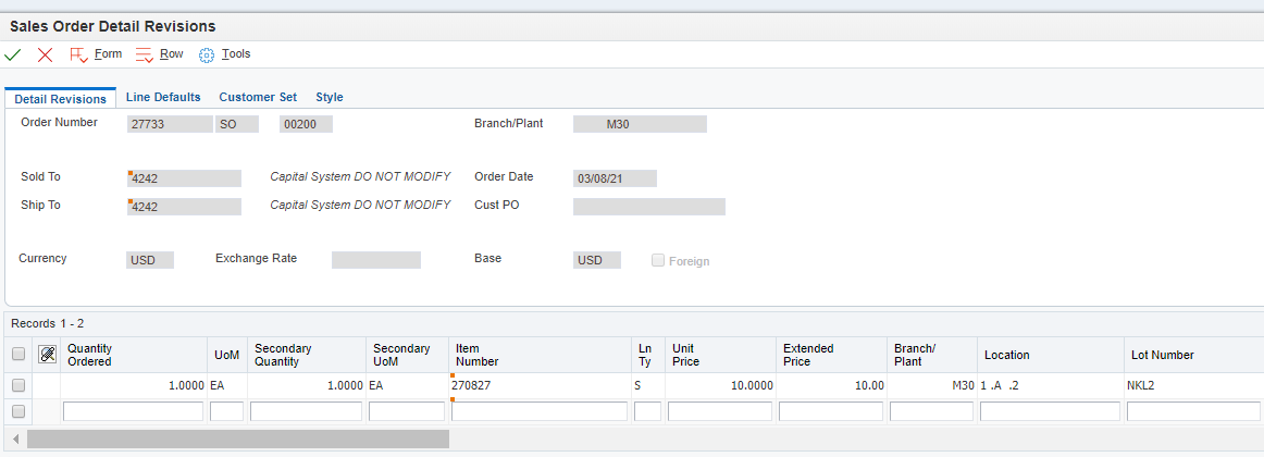

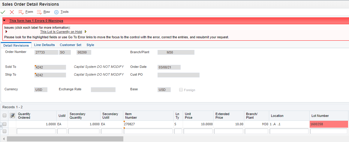

The Item 270827 from Location 1.A.2 with Lot/Serial = NKL2 is eligible for the creation of sales order.
                    Sales Order Details Revision When the location is changed to 1.A.1 and Lot/Serial to 1600358, the system displays an error message. The lot status code value is blank for this location and lot/serial indicating a non-approved lot status.
                    Error Message
