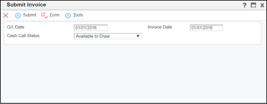

  4. Complete these fields:
    • G/L Date: 01/01/2016
    • Invoice Date: 01/01/2016
    • Cash Call Status: Available to Draw
  5. The Submit Invoice window should look like this:
    Submit Invoice
    Submit Invoice
  6. Click Submit to complete the invoice generation for the cash call.
    After the invoice is generated, the cash call should look like this with the status of Available to Draw.
