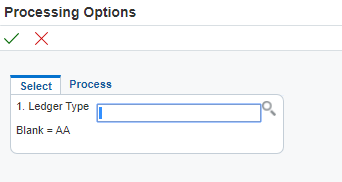

  2. On the Work With Batch Versions form for Generate Joint Venture Distribution Detail (R09J402), select the XJDE0001 version. Then, from the Row menu, select Processing Options.
    Processing Options for R09J402 Program
  3. On the Select tab, leave the Ledger Type processing option blank.
    This will create distribution detail records for the AA ledger.
  4. On the Process tab, leave the AA Ledger as Distribution Only processing option blank.
    All distribution detail records that are entered can be used to create journal entries, invoices, and vouchers.

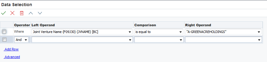

  6. On the Data Selection form, enter the following values on the first row and click OK:
    • Left Operand: Joint Venture Name (F09J30) (JVNAME) [BC]
    • Comparison: is equal to
    • Right Operand: Literal
    • Literal Value field under Single Value tab: A-GREENACREHOLDINGS
    Your Data Selection form should look like this:
  7. Data Selection for R09J402 Program

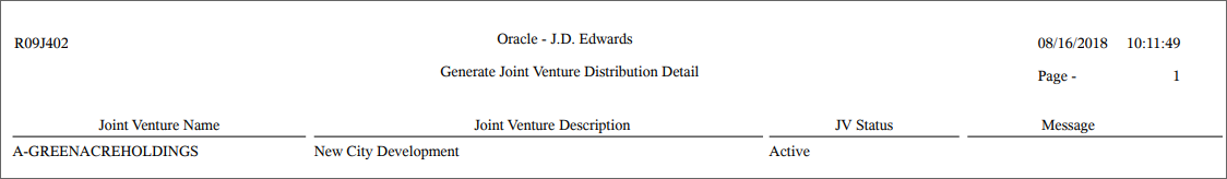

  9. Review the PDF report. This will list all joint ventures that are processed with a message that indicates if any errors and/or warning were encountered. In this case, the message should be empty.

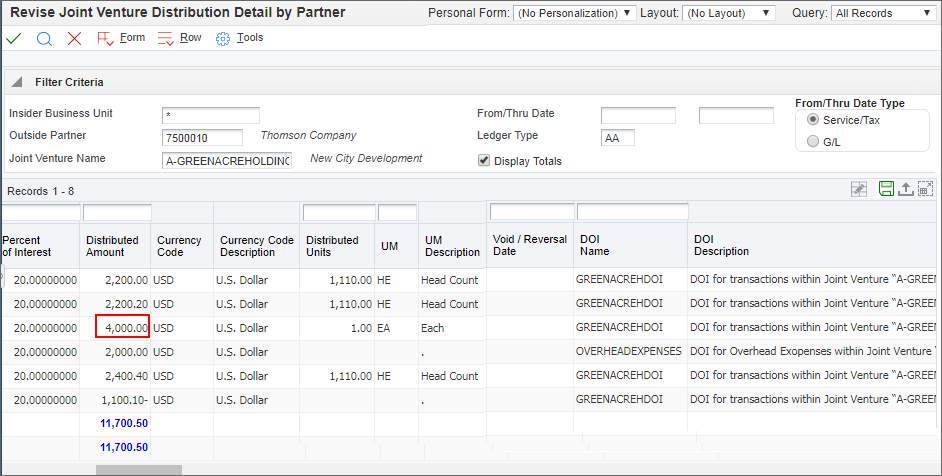

    You review the distribution summary and find that the distributed cost/expense amounts for an outside partner is more than expected.
  3. To review the distribution detail, select the outside partner 7500010 – Thomson Company and from the Row menu, select Partner Dist Detail.
  4. The system displays the Revise Joint Venture Distribution Detail by Partner form of the JV Distribution Detail by Partner program (P09J12C).
    The records for the distribution detail by partner should look like this:

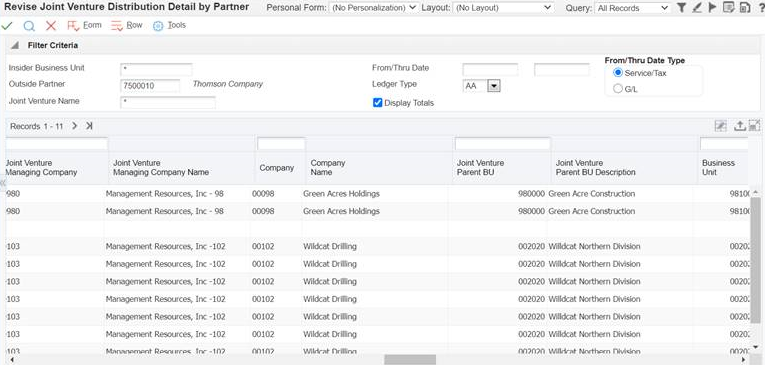

  5. Scroll to the right and note that there is a distribution for 4000.00. You find that this is incorrect. This amount should have been billed directly to the managing business unit (981 – Green Acre Holdings Share).

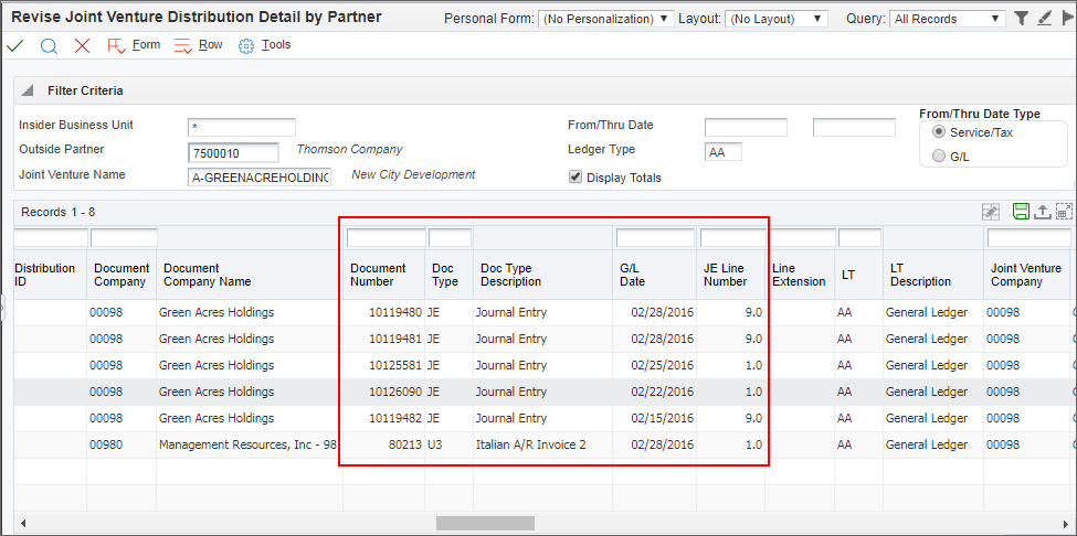

  6. Continue to scroll to the right until you are able to find the source transaction information that this distribution record was based on. Note down the following information. You will use this information in the next task.
    • Document Number = 10125581
    • Doc Type = JE
    • JE Line Number = 1.0

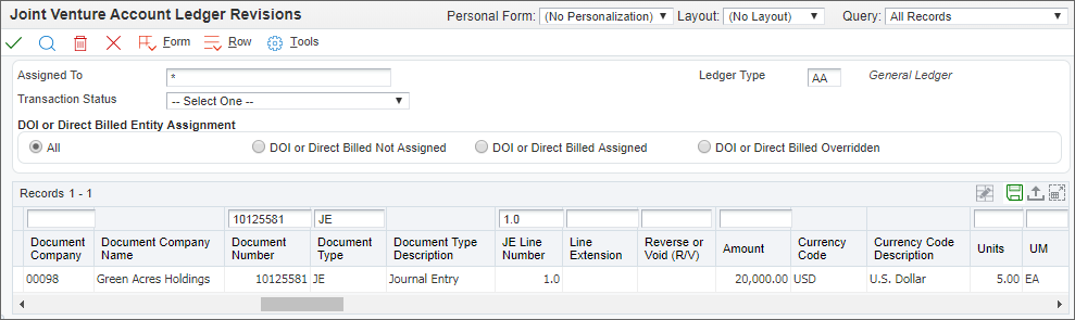

  3. Scroll to the right until you find the source document columns (Document Number, Doc Type, and JE Line Number). In the QBE fields for these columns, enter the values for the source transactions that you have noted in step 5 of the previous task, and click Find.
    The joint venture account ledger record that the system displays should look like this:

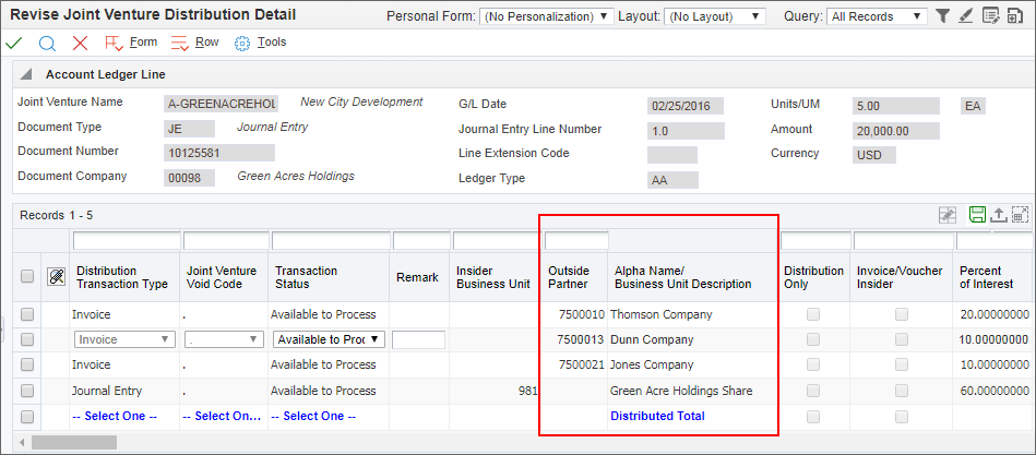

  5. The system displays the Revise Joint Venture Distribution Detail form of the P09J12 program. This form has information about how the source transaction was distributed to each of the partners.
    Distribution Details of a JV Account Ledger Record
  6. Scroll to the right of the form to see the 4000.00 that was distributed to the outside partner 7500010 – Thomson Company as well as the distributions made to the other partners.

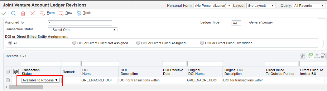

  10. On the Confirm Delete window that is displayed, click Yes to confirm the delete.
  11. Note that the Transaction Status is now Available to Process for the record.
    Joint Venture Account Ledger Revisions

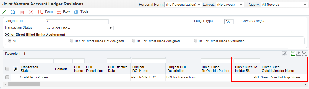

  12. Clear the DOI Name field and populate the Direct Billed To Insider BU field with the value 981.
    Reassigned Directly to Insider Business Unit
  13. Click OK.
