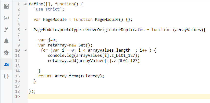

You must create a JavaScript function to remove the duplicate Originator values returned by the orchestration.
  1. On the Functions section of the po_approval_home-filter page, enter this code inside define:
    PageModule.prototype.removeOriginatorDuplicates = function (arrayValues){
        var j=0;
        var retarray=new Set();
         for (var i = 0; i < arrayValues.length  ; i++ ) {
            console.log(arrayValues[i].z_DL01_127);
            retarray.add(arrayValues[i].z_DL01_127)
        return Array.from(retarray);
    The JavaScript code to remove duplicate values in the Originator values returned by the orchestration should look like this:
    Description of 1.png follows
    Remove Originator Duplicates Code
