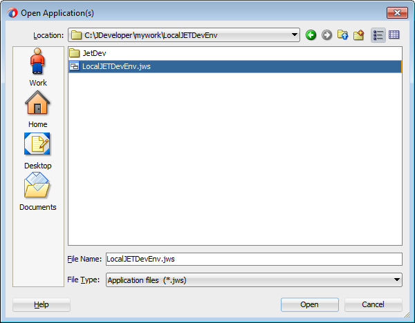

  1. In JDeveloper, open the extracted contents of the development environment download by opening LocalJETDevEnv.jws.
    Extracted Content

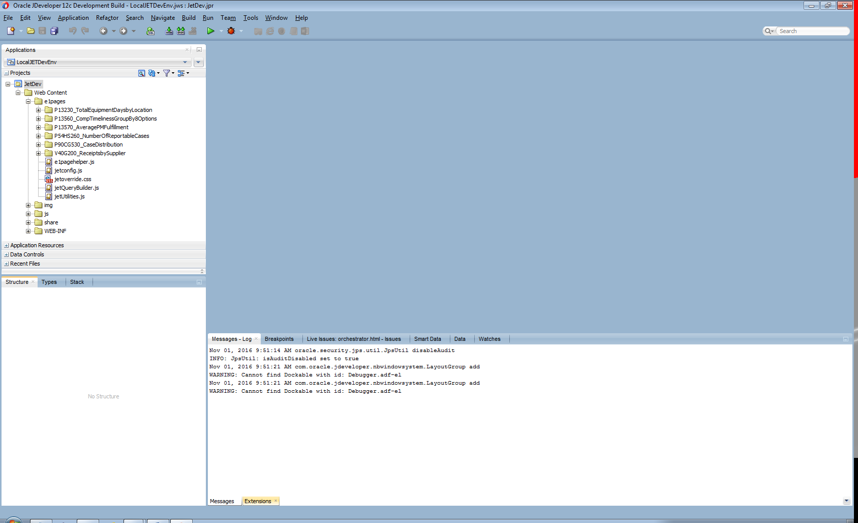

  2. In JDeveloper, navigate to and open the e1pages folder.
    e1 pages Folder

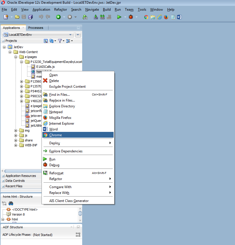

  4. Register one or more browsers as external tools in JDeveloper, and then test one or more of the included samples by opening the folder and running the home.html file in a browser.
    See Adding External Tools to JDeveloper for more information.
    e1 Pages Folder
    If the sample does not run, validate the AIS Server configuration in e1pagehelper.js. After successfully running the samples, you can proceed with building a new JET application. If you get the "Query definition is required" message, you can either create a query in the application for selection or use the QueryBuilder from the menu to create an ad hoc query.
