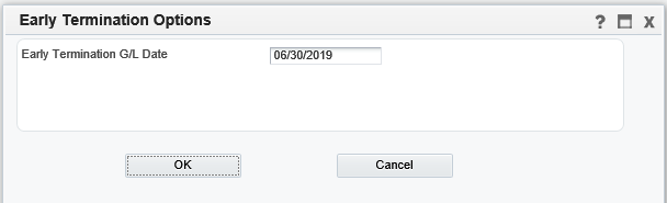

  5. In the Early Termination Options dialog box, enter 06/30/19 as the Early Termination G/L Date.
  6. The Early Termination Options dialog box should look like this:
    Early Termination Options Dialog Window

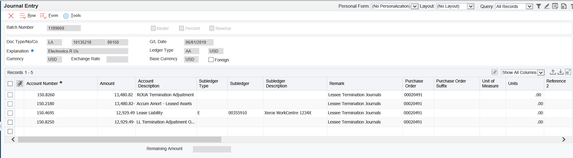

  4. Review the journal entries created for a Finance type lease:
    • JE termination amount = lease liability beginning balance for the start termination month – (minus) lease liability prior month ending balance
    • Debit to Lease Liability
      • AAI = LL
      • Lease liability ending balance – start termination month/year (6/19)
    • Credit to LL Termination Adj Offset
      • AAI = L7
    • Credit to Accumulated Amortization
      • AAI = LC
      • ROUA Ending Balance – start termination month/year (6/19)
    • Debit to ROUA Termination Adj Offset
      • AAI = L8
  5. This is how the early termination journal entries should look:
    Journal Entry
    Journal Entry

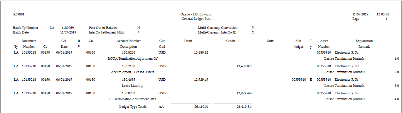

  4. This is how the General Ledger Post report should look:
    General Ledger Post Report

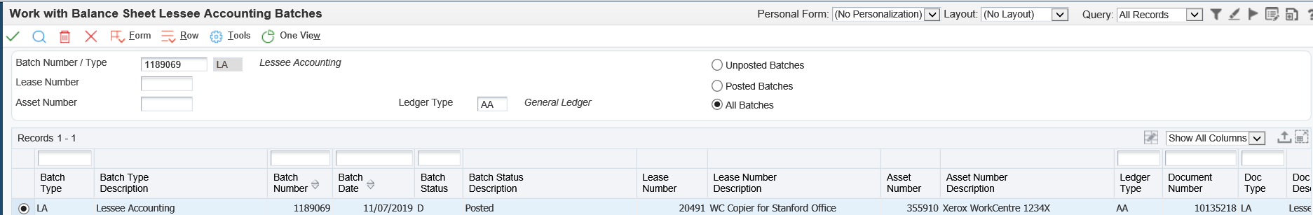

  6. Make sure that the option to display All Batches is selected and click Find.
  7. Note the Batch Status is D (Posted) for the early termination batch you just posted.
  8. This is how your early termination batch record should look:
    Work with Balance Sheet Lessee Accounting Batches form
