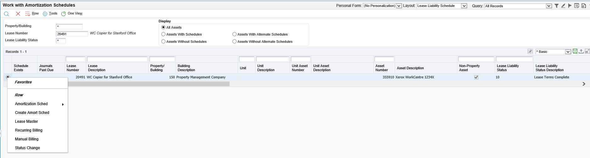

  1. Navigate to EnterpriseOne Menus, Financials (G1), Lessee Accounting (G15202), Periodic Processing (G1520220), Amortization Schedules (P15171).
  2. On the Work with Amortization Schedules form, enter 20941 as the Lease Number to find the lessee lease you created in the OBE "Creating a Lessee Lease".
  3. Click Find.
  4. Lease 20941 is displayed in the grid.
    Work With Amortization Schedule Form
    Work With Amortization Schedule form

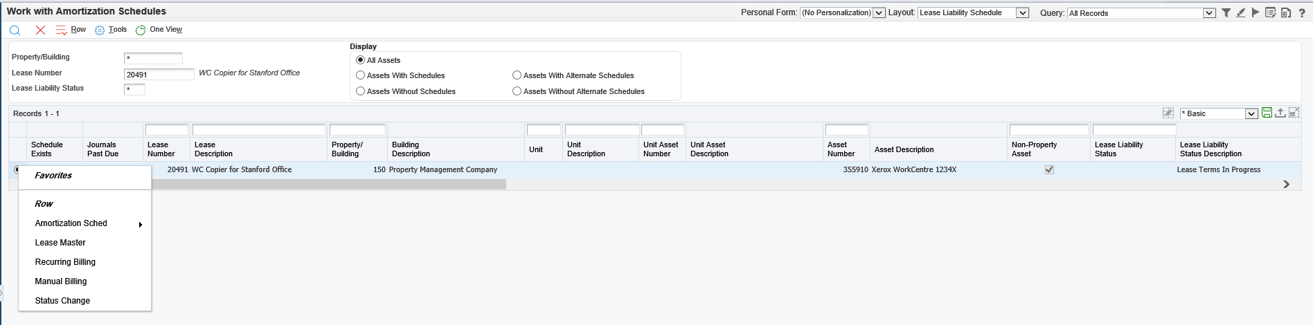

  5. Select Status Change from the Row menu
  6. Row menu of Work With Amortization Schedule Form
    Row Menu - Work With Amortization Schedule Form

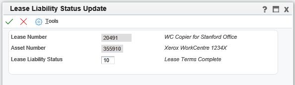

  7. Change the Lease Liability Status to the status that is required for creating amortization schedules.
    • Change the following field from the Lease Liability Status Update pop-up window:
      • Lease Liability Status: 10 (Lease Terms Complete)
  8. Note the Lease Number and Asset Number are displayed.
    The Lease Liability Status Update dialog window should look like this:
    Status Update Dialog Window
  9. Click OK to save the change to the lease liability status and exit the pop-up window.

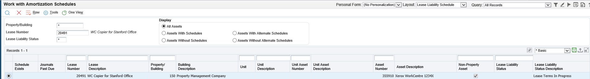

  10. The lease liability status is updated in the Work with Amortization Schedules form and a Row menu is now available to create amortization schedules for the asset.
    Your equipment asset record should look like this:
    Equipment Asset Record
    Work with Amortization Schedule Form

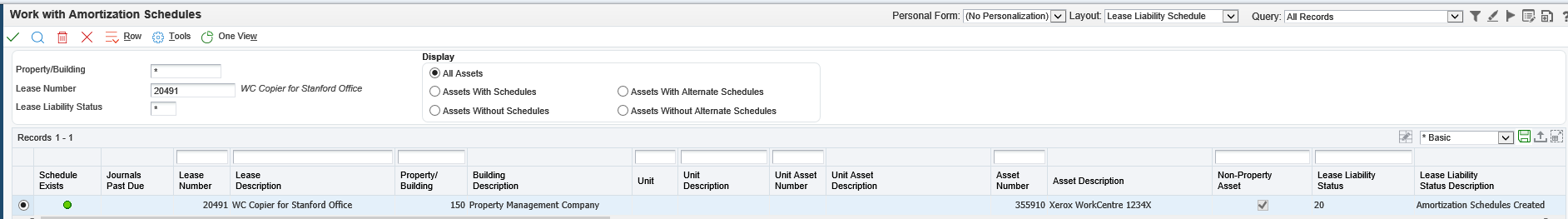

  11. Select Create Amort Sched from the row exit.
    The amortization schedules for the asset are created.
    • The Lease Liability Status is updated to 20 (Amortization Schedules Created)
    • A green circle icon is displayed in the Schedule Exists grid column
    • The ROUA End Date is updated with the Ending Date from recurring billing – 12/31/2020.
  12. Your equipment asset record should lookj like this:
