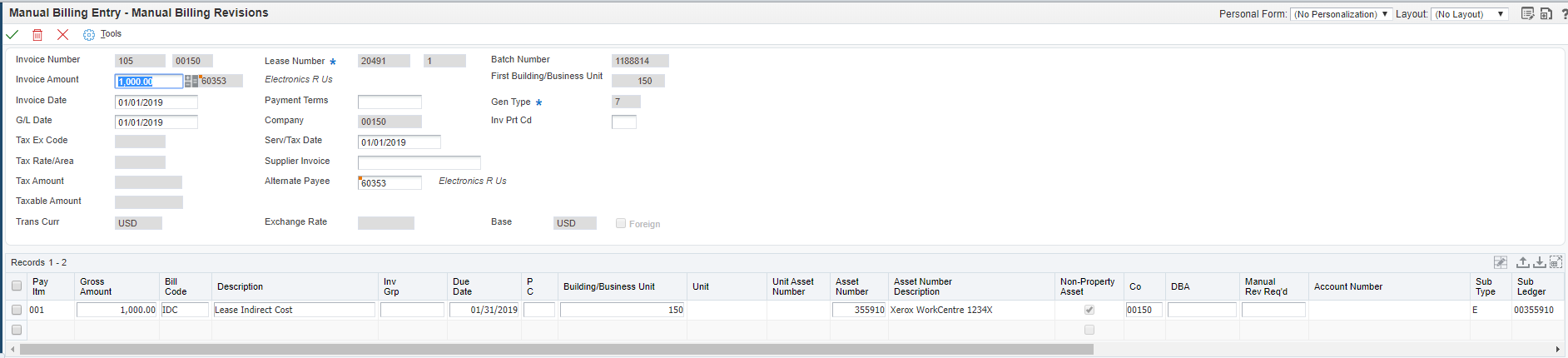

  1. Navigate to EnterpriseOne Menus, Financials (G1), Lessee Accounting (G15202), Periodic Processing (G1520220), Manual Billing (65/G1520220), Manual Billing Entry (P1511).
  2. On the Work with Manual Billings form, select Add to add the manual billing.
  3. On the Manual Billing Revisions form, complete these fields:
    • Lease Number: Enter the lease number added in the OBE
    • Invoice Amount: $1,000
    • Invoice Date: 01/01/19
    • G/L Date = 01/01/19
    • Gen Type = 7
  4. On the grid, complete these columns in the grid:
  5. Gross Amount Bill Code Effect on ROU Asset
    $1,000 IDC(Lease Initial Direct Cost) Initial Direct Cost
    Other header fields default from the lease defaults.
  6. Exit the row to populate the other columns from the lease defaults.
  7. Click OK to save the entries.
  8. Your manual billing record should look like this:
    Manual Billing Record
    Scroll to the right of the grid to see the Effect on ROU Asset column. Note that the Sub Type (Subledger Type) is automatically set to “E” (equipment number) and the Sub Ledger column is populated with the asset number.
    Manual Billing Record with Effect on ROU Asset
