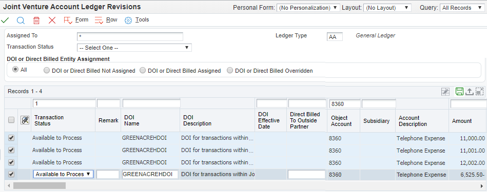

  3. Select the telephone expense records as shown in the graphic below.
    Joint
                        Venture Account Ledger
    Joint Venture Account Ledger

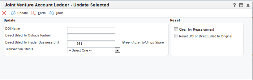

  4. Navigate to the Row menu and click Update Selected.
    In this tutorial, you are using the Update Selected mass update feature to reassign account ledger transactions (telephone expenses) directly to the insider business unit 981. These transactions were originally assigned to the DOI, GREENACREHDOI.
    Note: The Update Selected feature enables you to accomplish the following:
    • Assign a Division Of Interest(DOI) to selected account ledger records.
    • Assign an outside or inside partner to selected account ledger records.
    • Update the Transaction Status to a given status for selected account ledger records.
    • Clear the existing assignments to reassign values.
    • Reset the values to the original values.
      Your Update Selected form should look like this:
      Update
                            Selected Joint Venture Account Ledger Records
      Update Selected Joint Venture Account Ledger Records

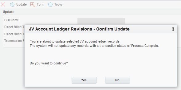

  5. Click Update.
  6. Click Yes on the Confirm Update window.
    Update
                        Selected Confirmation Window
    Update Selected Confirmation Window

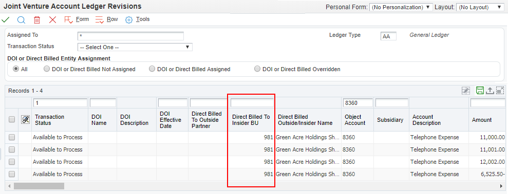

    The system updates the selected records with the new values. Your updated account ledger records should look like this:
    Reassigned
    Reassigned Joint Venture Account Ledger Records

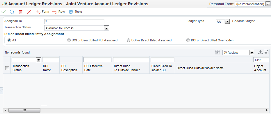

  1. Navigate to EnterpriseOne Menus, Financials, Joint Venture Management (G09J), Daily Processing, JV Account Ledger Revisions (P09J11).
  2. Filter records for material expense using the values in the table below:
    Header Filter/QBE Field Value
    Transaction Status Available to Process
    Fiscal Year 16
    Period No. 2
    Joint Venture Name A-GREENACREHOLDINGS
    Object Account 1344

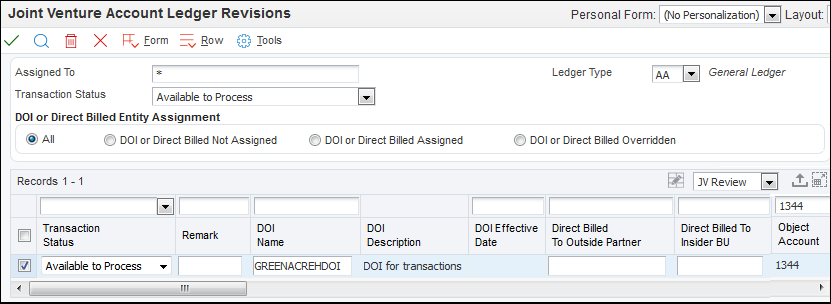

  3. Select the material expense record as shown in the graphic below.

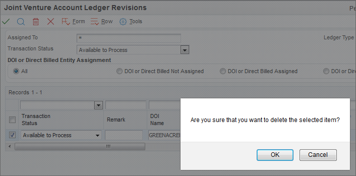

  4. Click Delete to delete the record.
  5. The Equipment Depreciation account loaded into the Joint Venture Account Ledger will be removed.
    Note that additional joint venture transactions can be reloaded into the Joint Venture Account Ledger by running the Load Joint Venture Account Ledger program (R09J400).
  6. Review the warning message and click OK to proceed.
    Delete
                        Warning Message
    Delete Warning Message
