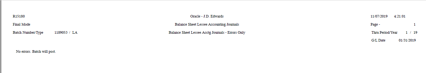

  11. Find the batch job you just submitted: Balance Sheet Lessee Acctg Journals – Errors Only.
  12. Click on the View Output grid column and click Open when prompted.
  13. Review the report to ensure there are no errors. Note the batch number.
    Your monthly journal report should look like this:
    Monthly Journal Report

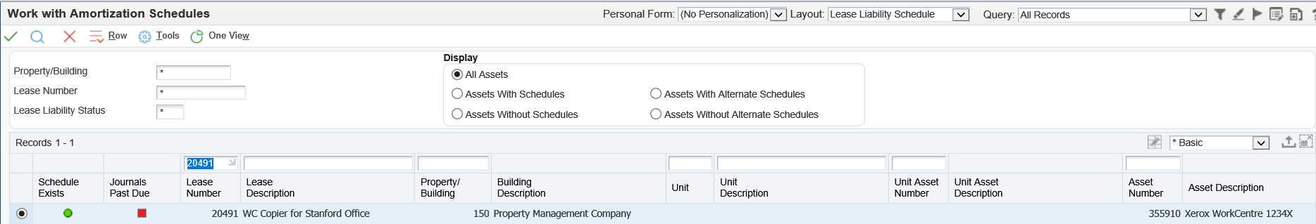

section 1 Reviewing Amortization Schedules
  1. Navigate to EnterpriseOne Menus, Financials (G1), Lessee Accounting (G15202), Periodic Processing (G15202220), Amortization Schedules (P15171).
  2. On the Work with Amortization Schedules form, enter the lease number 20491 find the lessee lease you created in the OBE “Creating a Lessee Lease”.
  3. Click Find. Lease 20491 is displayed in the grid.
  4. Note: The journal entry Through Date is updated to 01/01/2019.
    Work With Amortization Schedule

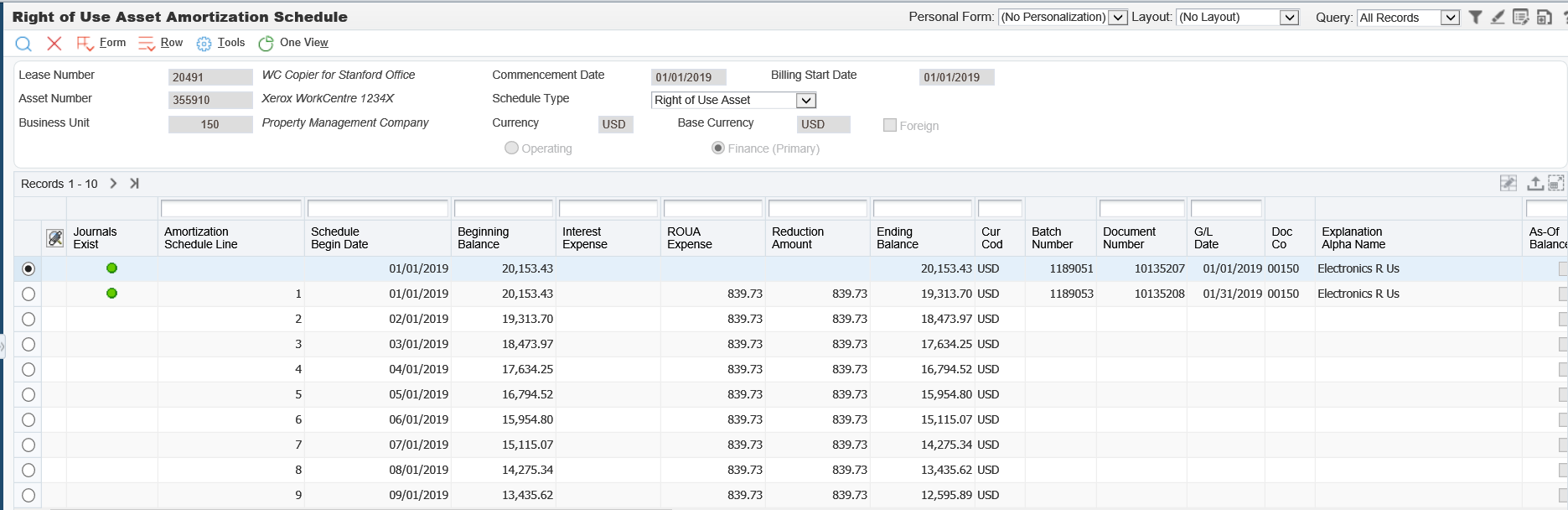

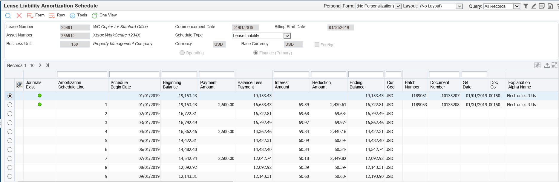

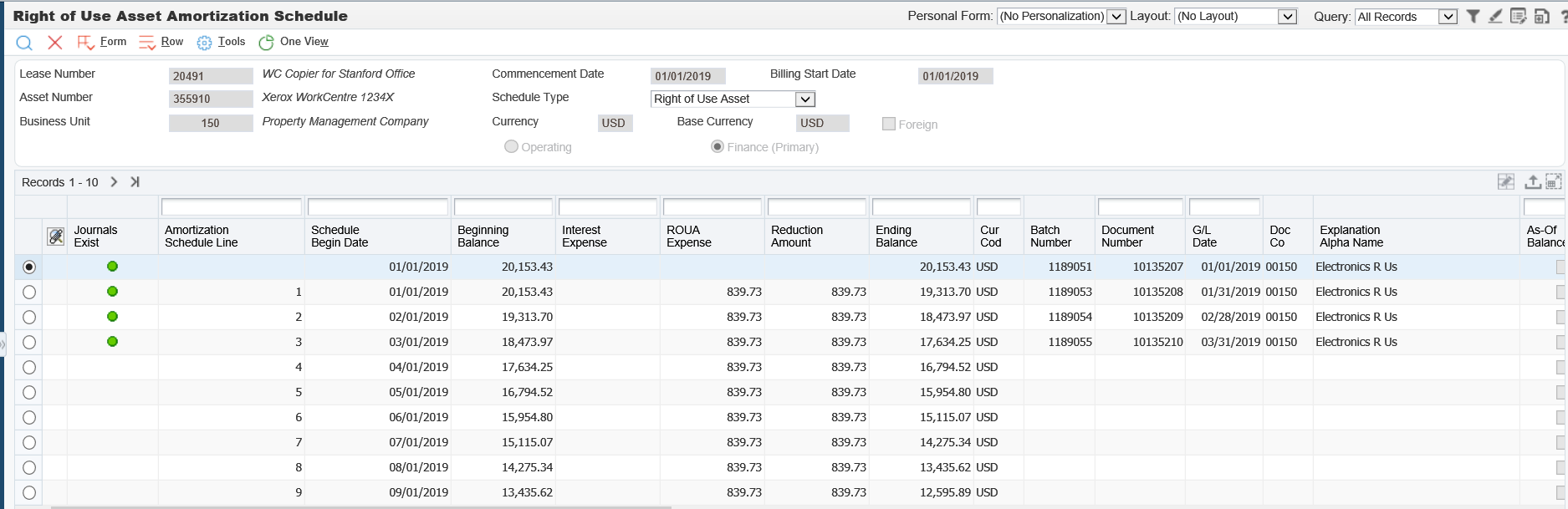

  5. From the Row menu, select Amortization Sched and then select Lease Liability to review the schedule after monthly journals are created for 01/01/19.
    • A green circle icon is displayed which indicates that monthly journals were created for the schedule line.
    • The Batch Number, Document Number, Document Company, and G/L Date grid columns are populated with the information from monthly journal processing.
    • Note: The same batch information is displayed from both the lease liability and right of use asset schedules.
      This is how the amortization schedules should look after the monthly journals are created:
      Lease Liability Amortization Schedule
      ROUA Amortization Schedule

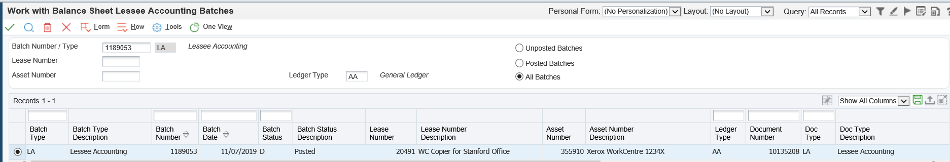

section 1 Reviewing Monthly Journal Entries
  1. Navigate to EnterpriseOne Menus, Financials (G1), Lessee Accounting (G15202), Periodic Processing (G1520220), Balance Sheet Lessee Accounting Batch Review (P150911).
  2. From the Work with Lessee Accounting Batch Review form, select the grid row for the monthly journals batch for January 2019.
    • Batch: 1189053 (Your batch that was created)
    • G/L Date: 01/31/19
    • Explanation/Remark: Balance Sheet Lessee Journals
    • Batch Status: A (Approved)
  3. Select JE Review from the Row menu.

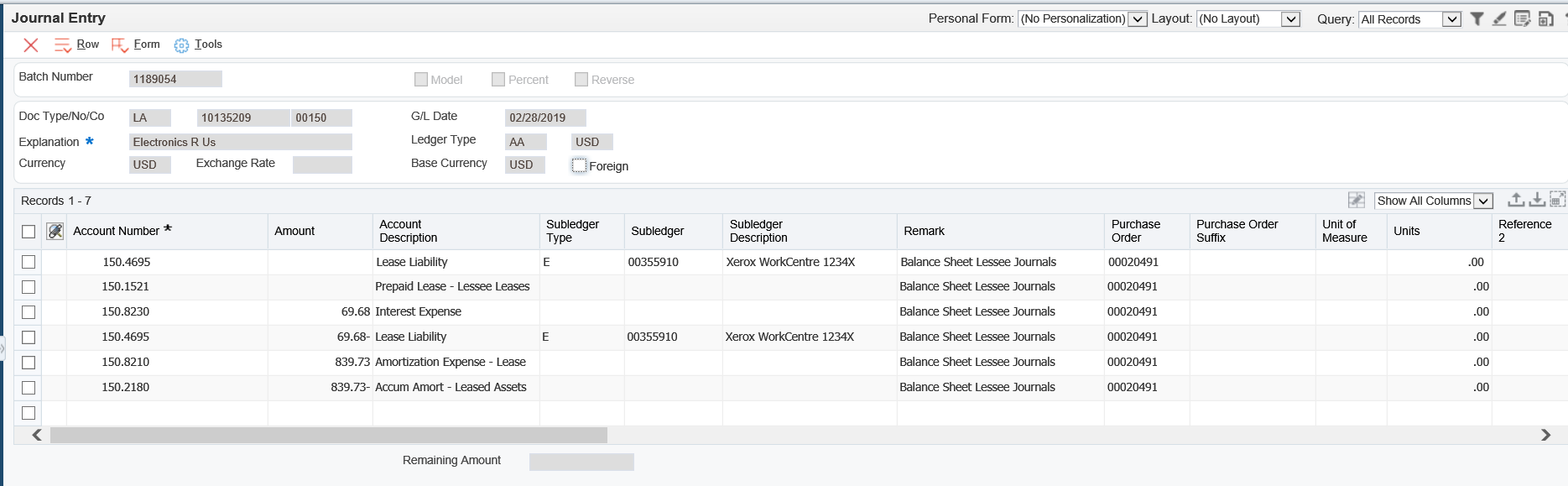

    This is how the monthly journal entries for January 2019 should look like:
    Journal Entry
    Journal Entry

    This is how your monthly journal batch record should look:
    Monthly journal Batch Record
    Monthly Journal Batch Record

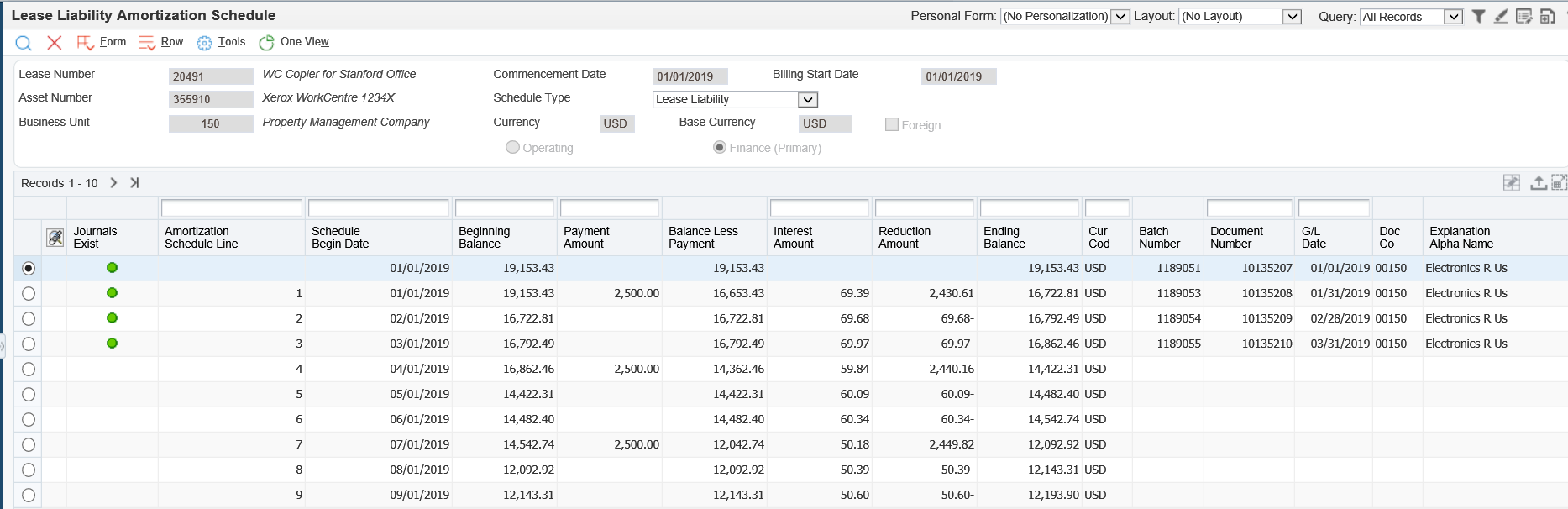

  5. Review the amortization schedule for each monthly journal using the Amortization Schedules program (P15171).
  6. This is how the amortization schedules should look after creating monthly journals for the first quarter:
  7. Review the monthly journal entries using the Balance Sheet Lessee Accounting batch program (P150911).
    • February: G/L Date = 02/28/19
    • March: G/L Date = 03/31/19
    This is how the journal entries should look after you create monthly journals for the first quarter:
    Journal entries after Q1
    Journal Entries After Q1
