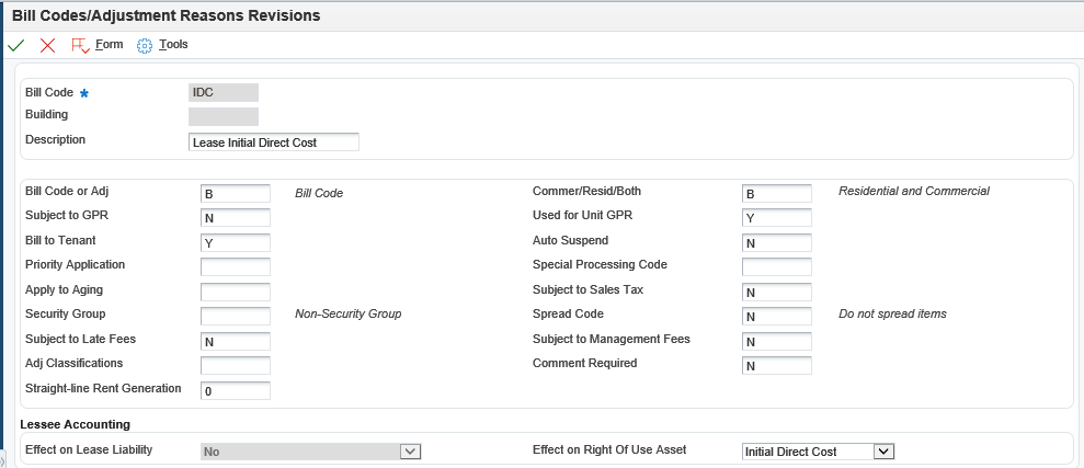

  6. Add another bill code. Complete the following fields:
    • Bill Code: IDC
    • Description: Lease Initial Direct Cost
    • Lease Accounting:
      • Effect on Lease Liability: No
      • Effect on Right of Use Asset: Initial Direct Cost
  7. Leave all other fields blank. These fields are automatically populated with default values.
    Your bill code record for IDC should look like this.
    Bill Code for IDC
    Bill Code Record for IDC
