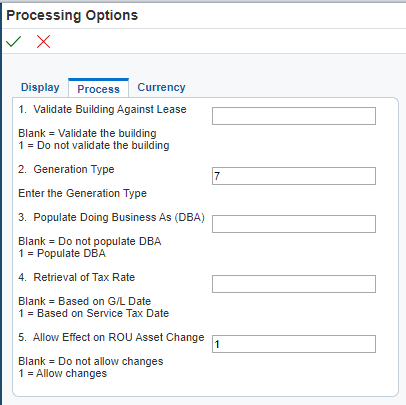

    Process Tab:
    • Generation Type: 7
    • Allow Effect on ROU Asset Change: 1 (Allow changes)
    Leave all the other processing options in this tab blank.
    The Process tab should look like this:
    Process Tab
    Process Tab

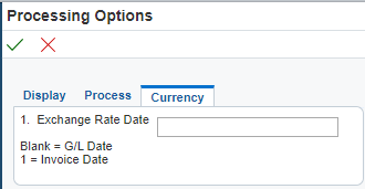

    Currency Tab:
    • Exchange Rate Date: Leave this processing option blank.
    The Currency tab should look like this:
    Currency Tab
    Currency Tab
