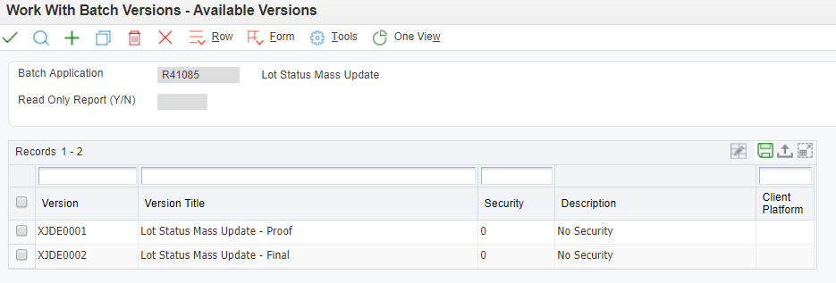

  7. Select a version and click the Row tab and select Processing Options.
    Description of 6.png follows
    Versions

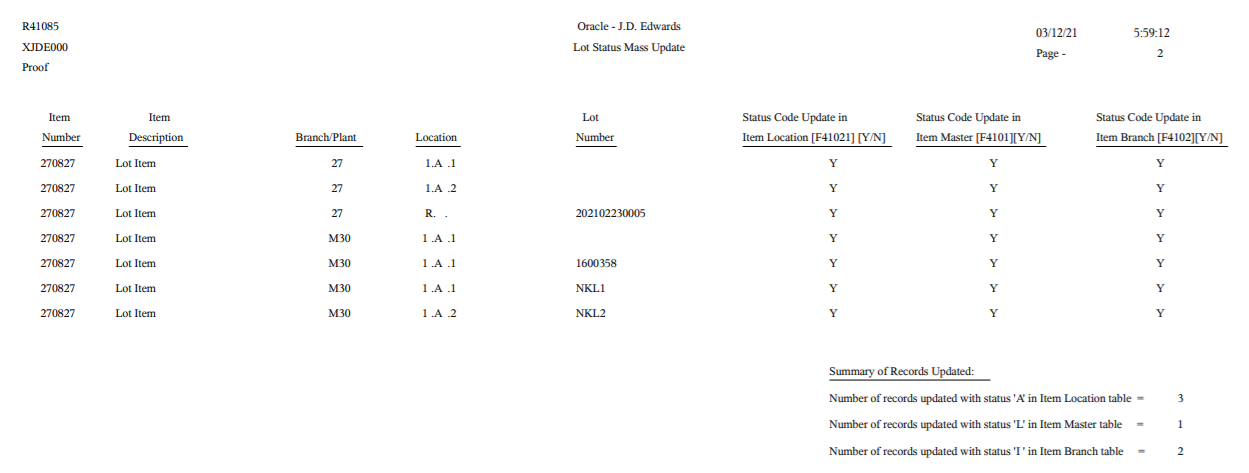

  10. Run the report with the data that you select from the Item Location (F41021) table.
    The PDF output should be similar to this:
    Description of 8.png follows
    PDF Output

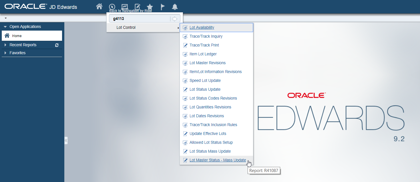

  11. Use the Fast Path to navigate to the Lot Control (G4113) menu and select Lot Master Status - Mass Update report (R41087) to update the lot status in the Lot Master table (F4108).
    Description of 10.png follows
    Fast Path

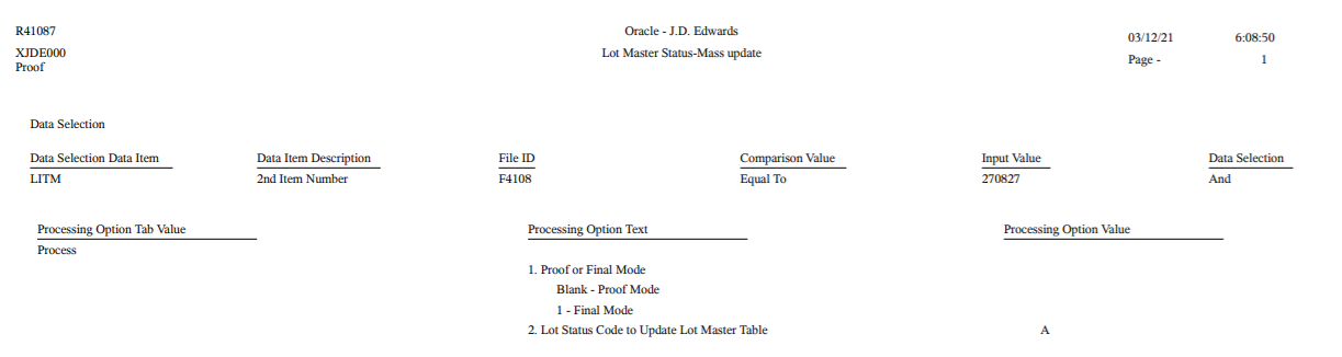

  12. Click the Row tab and select Processing Options.
    Description of 11.png follows
    Processing Options

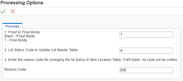

  13. Enter a valid lot status code in Processing Option 2. This status will be updated in the Lot Master table.

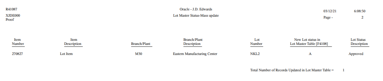

  14. Run the report with the data that you select from the Lot Master (F4108) table.
    Description of 21.png follows
    PDF Output
    Description of 13.png follows
    PDF Output

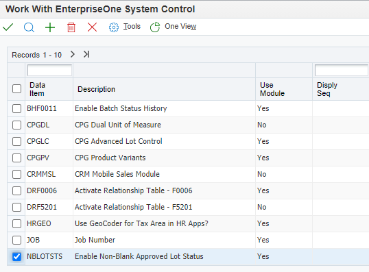

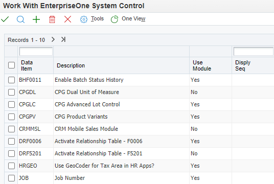

  15. Use the Fast Path to access the Work with EnterpriseOne System Control program (P99410).
    Description of 1.png follows

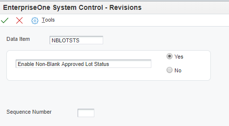

  16. Click Add + and enter NBLOTSTS in the Data Item field and select Yes. Click OK to save the transaction.
    Description of 2.png follows
    Data Item Field
    Description of 3.png follows

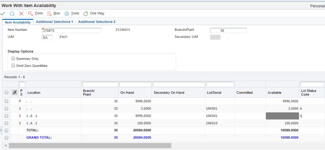

    For example: Note another item 270875 has the following availability status in the Work with Item Availability program (P41202).
    Description of 14.png follows
    Availability Status
    Because a blank code indicates an approved lot status, the Available column for that row with Location 1.A.1 and Lot/Serial 1NK010 is not grayed out.

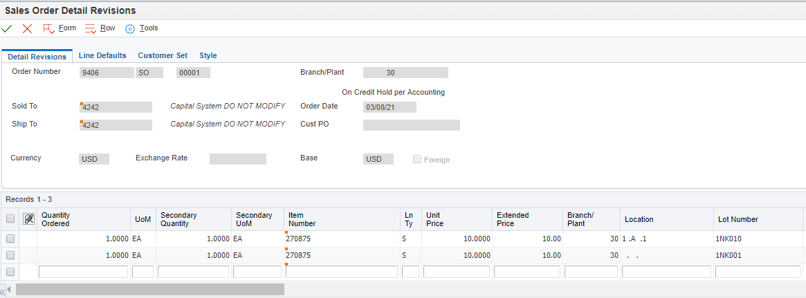

    These are the valid Location and Lot/Serial combinations that support the creation of a sales order for Item 270875.
    Location = 1.A.1
    Lot/Serial = 1NK010
    Location = . .
    Lot/Serial = 1NK001

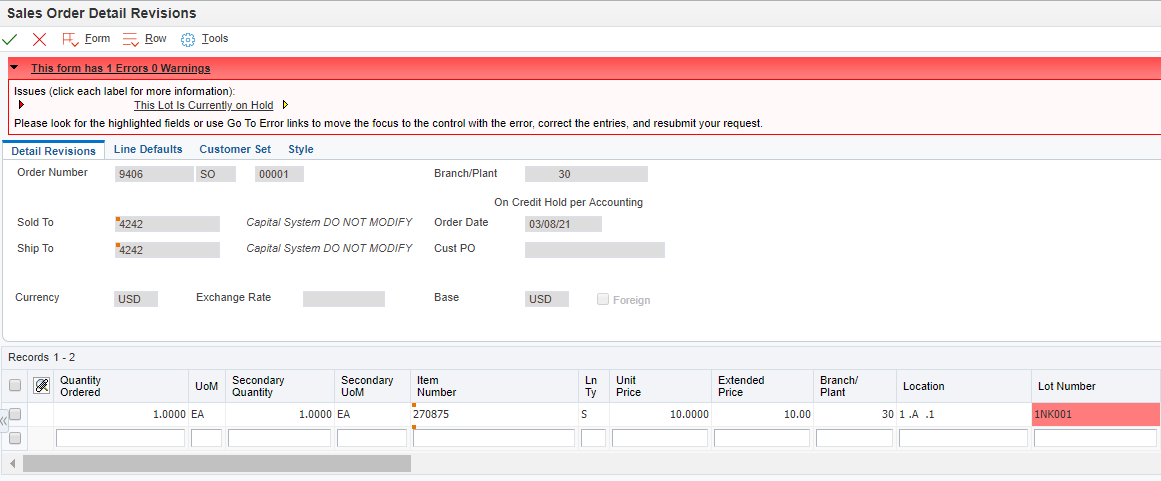

    Description of 15.png follows
    Sales Order Details Revision
    When the location that corresponds to Lot/Serial 1NK001 is changed to 1.A.1, and Lot/Serial = 1NK001 the system displays an error message. The lot status = Q [non-approved] for this item in location 1.A.1 with Lot/Serial = 1NK001.
    Description of 16.png follows
    Error Message
