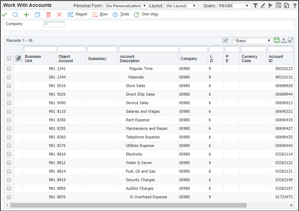

  3. Also, set up the accounts required for the managing business unit using the information in the table below. The chart of accounts for the managing business unit must have all the distributable accounts from the joint venture business units participating in the joint venture.
    Note: Leave the Subsidiary field blank for all the accounts.
    Business Unit
    Object Account
    Account Description
    981 1341 Regular Time
    981 1344 Materials
    981 5010 Store Sales
    981 5020 Direct Ship Sales
    981 5090
    Service Sales
    981
    8870
    JV Overhead Expense
    981 8110
    Salaries and Wages
    981 8350
     Rent Expense
    981 8360
    Telephone Expense
    981 8810 Electricity
    981 8812 Water & Sewer
    981 8814 Fuel, Oil, and Gas
    981 8815 Security Charges
    981 8850 Auditor Charges
    981 8370 Utilities Expense
    981 8355 Maintenance and Repair
    Your accounts for the managing business unit should look like this:
    Work With Accounts
    Chart of Accounts for the Managing Business Unit

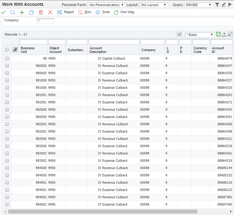

    The chart of accounts for the joint venture business units must include the cutback accounts based on the account type (capital cost, revenue, or expense).
  4. For this tutorial, set up the required cutback accounts using the information in the table below.
    Note: Leave the Subsidiary field blank for all the cutback accounts.
    Business Unit
    Object Account
    Account Description
    98 4990 JV Capital Cutback
    980000 9950 JV Revenue Cutback
    980000 9990 JV Expense Cutback
    981000 9950 JV Revenue Cutback
    981000 9990
    JV Expense Cutback
    981001 9950
    JV Revenue Cutback
    981001 9990
    JV Expense Cutback
    982000 9950
    JV Revenue Cutback
    982000 9990
    JV Expense Cutback
    982002 9950
    JV Revenue Cutback
    982002 9990
    JV Expense Cutback
    983000 9950
    JV Revenue Cutback
    983000 9990
    JV Expense Cutback
    983003 9950
    JV Revenue Cutback
    983003 9990
    JV Expense Cutback
    984000 9990
    JV Expense Cutback
    984000 9950
    JV Revenue Cutback
    984001 9990
    JV Expense Cutback
    984001 9950
    JV Revenue Cutback
    984002 9990
    JV Expense Cutback
    984002 9950
    JV Revenue Cutback
    Your cutback accounts should look like this:
    Cutback Accounts
    Cutback Accounts
