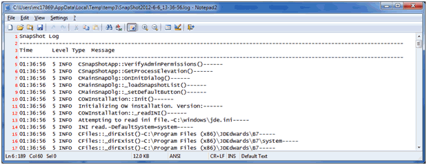

        Above is an example of a SnapShot log file. When troubleshooting within the SnapShot log file, you should scan the Type column for a status of ERR, which indicates an error. If the error message itself is insufficient to isolate the cause of the problem, examine the messages immediately before and after the error for hints as to the root cause.
