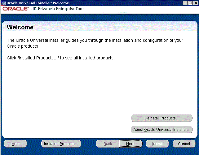

  4. On Oracle Universal Installer: Welcome, select the Deinstall Products ... button.

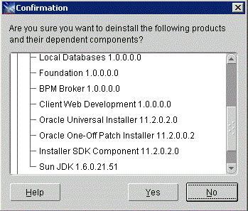

  7. On Confirmation, verify that you want to uninstall the listed components and their dependent components and if so, select the Yes button.

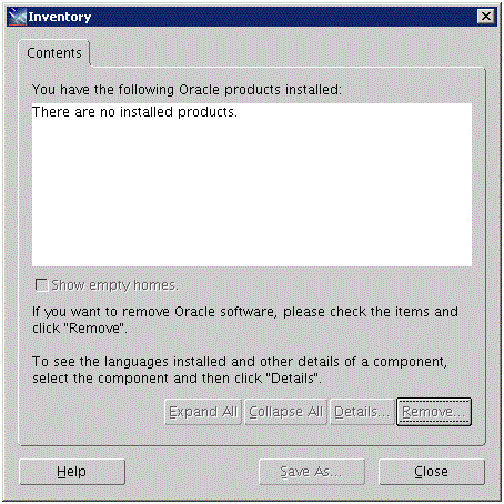

  8. When the uninstallation process completes, the Inventory is shown again. The products you selected for uninstallation should no longer be displayed in the inventory.
  9. Select the Close button.
