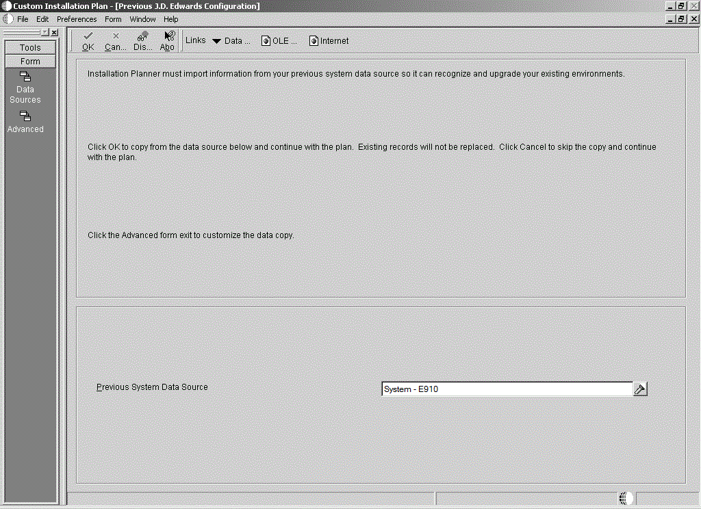

    This image is described in the surrounding text.
  4. This form imports information from your previous system data source. The previous system data source you are upgrading from should be prepopulated. Use the Data Sources form exit to verify the data source is set up correctly.
  5. If this is correct, click the OK button and proceed to Step 9. Click the Advanced form exit and continue with the next step. This screen sets up to copy information from the previous system data source into planner while providing some default information for the user. It is also used for spec merge and table conversions to provide access to the previous environments.

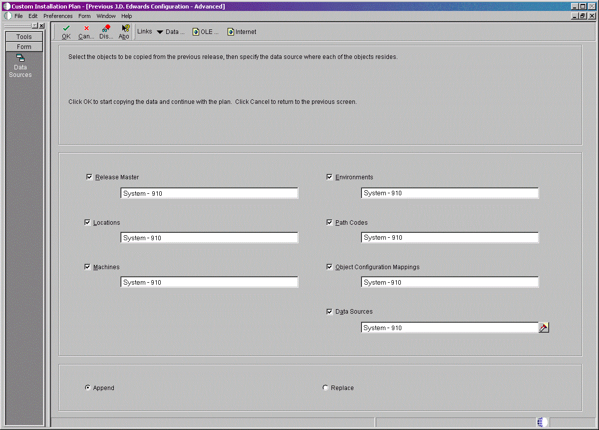

    IIf you want to force the system to retry the imports, click the Advanced form exit, which presents the following screen labelled Previous J.D. Edwards Configuration - Advanced. On that screen, you should enable the checkboxes for all data sources and then click the OK button, which forces the system to import the information from your previous data source. Under normal circumstances it should not be necessary to force a form import.
    The Release Master checkbox may not be selected, but the release master has already been copied at this point in the process.
  6. Select the objects to be copied from the previous release, then specify the data source where each of the objects reside.
  7. Select the appropriate radio button for your data load:
    Radio Button
    Description
    Append
    Adds records to your existing tables. This is the typical selection.
    Replace
    Clears existing tables prior to loading new data.
  8. Click the OK button.

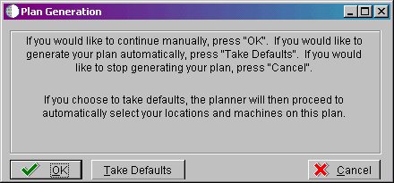

    The above screen may not always appear for upgrades, which is preferable because the recommended method is to step through the planner rather than taking defaults. See "Caution When Choosing Take Defaults" below.
    • From this form, you have the option to automatically enter the locations and machines into the plan that you defined in the previous version of the software.
  10. Choose a method for generating your plan:
    • To manually create your plan, click the OK button and continue with Entering Location Information.
    • To enable the system to automatically enter the locations and machines from the previous version, click the Take Defaults button.
      The machines that were imported from the previous system data source are entered into the current plan. Skip the sections on entering locations, Deployment Servers, Enterprise Servers, and machines or servers, and continue with Entering Shared Data Source Information.
      Caution when choosing take defaults:
      In order to ensure the validity of all subsequent plan information, it is strongly recommended that even advanced users should not choose this Take Defaults option. Instead, you should step through plan and verify that the Planner is populating information exactly as you expect to match your requirements.
    • To exit the plan, click the Cancel button.
