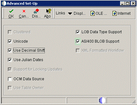

On Advanced Set-Up, because the central objects data source must be Unicode, verify the Unicode setting is checked.
