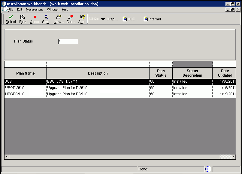

  3. On Work with Installation Plan, double-click your plan.

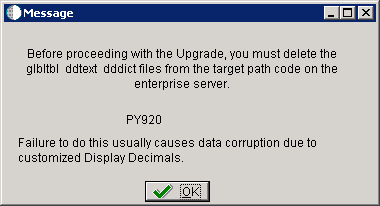

  4. If you have selected that you want to run Table Conversions on the Enterprise Server, the Installation Workbench displays the following message:
    This image is described in the surrounding text.
    This message warns that before proceeding with the Upgrade, you must delete the glbltbl, ddtext, and dddict spec files from the target path code on the Enterprise Server. Failure to do this usually causes data corruption due to customized Display Decimals.
    At this point you should delete these spec files as instructed, and then click the OK button in the Message to continue.
