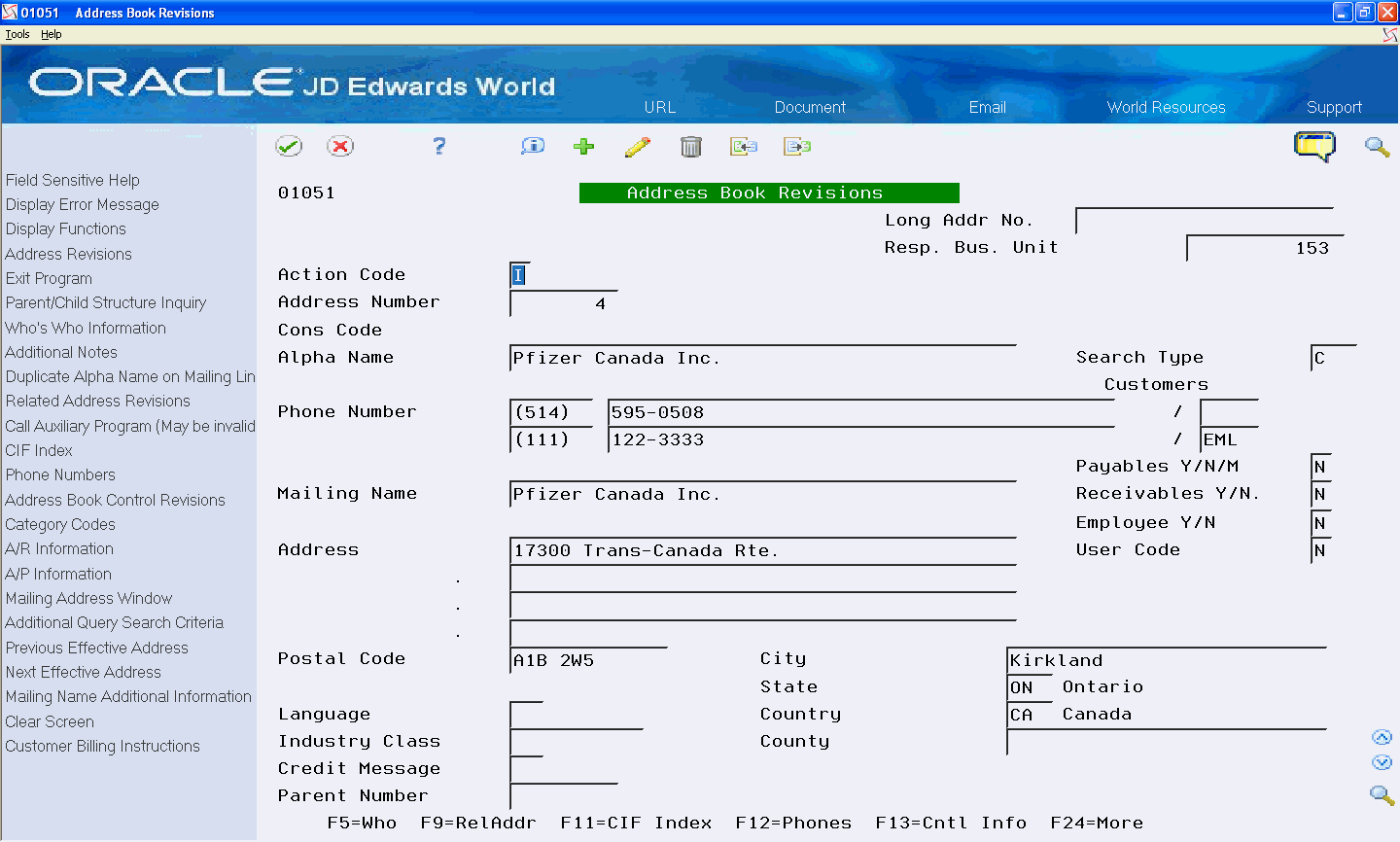

From Address Book (G01), choose Address Book Revisions
The following illustrates the company address information for year-end purposes.
