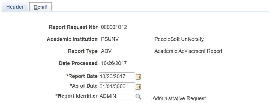

This example illustrates the fields and controls on the Header page. You can find definitions for the fields and controls later on this page.
Request Multiple Reports-Header page
Field or Control Description
Report Request Nbr
A unique identifier assigned to the report request.
Report Date
The default value based on the setup in the Define Advisement Report Types page for the requested report.
As of Date
The default value based on the setup in the Define Advisement Report Types and/or Academic Advisement Installation pages for the requested report.
Report Identifier
Enter the report identifier from the Report Identifier table; for example, ADMIN.

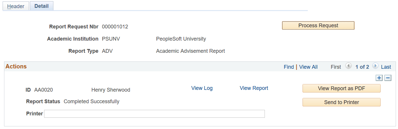

This example illustrates the fields and controls on the Detail page. You can find definitions for the fields and controls later on this page.
Request Multiple Reports- Detail page
After selecting the Report Type on the Header page, select an ID in the Action box on the Detail page. Then select the Process Request button. The Actions box contains the name and ID of the student and following information:
Report Status
Indicates the status of your report request- pending, successful or failed.
View Log
Select to view a detailed log of report requests for the particular student.
View Report
Click to view the report that was generated. This link appears on the page after the report request is processed.
View Report as PDF
Click to view a .PDF version of the advisement report. This button appears on the page after the request is processed.
Printer
Enter the path for your local postscript printer. This field appears on the page after the request is processed.
Send to Printer
Click to send the report results to the designated printer. This button appears on the page after the request is processed.
