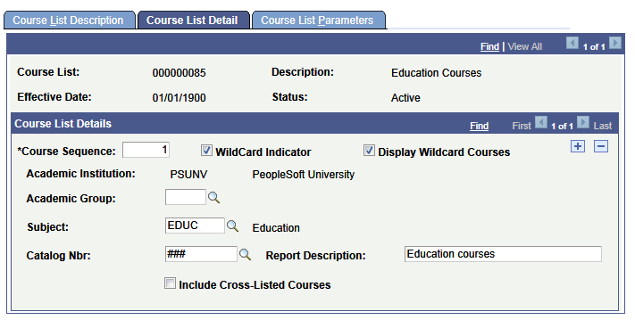

Creating a Course List Detail
Access the Course List Detail page (Curriculum Management, and then Enrollment Requirements, and then Enrollment Course Lists, and then Course List Detail).
This example illustrates the fields and controls on the Course List Detail page. You can find definitions for the fields and controls later on this page.
Field or Control Description
Fetch
Click to retrieve and display the course sequence data, including the related detail parameters for the effective-dated row. When you access this component, the system loads only effective-dated rows, without any detail, to enhance performance for those course lists that have hundreds of course sequence rows.
Course Sequence
Indicates a unique component of the course list. Each sequence represents a course ID or a group of equivalent courses. The system assigns the numbers sequentially, but you can change them. Usually, courses in a course list do not have to be in a particular order. However, you must put courses in sequential order when you plan to assign the course list to a requirement line type of Sequential Restriction or Global Sequential Restriction. In those cases, enter the correct course order here so that the advising process requires the student to complete the courses in the course sequence that you specify. For example, students should take French 1, French 2, and French 3 in that order.
Course ID
Enter the ID that specifies the course needed to satisfy this course list. (Prompt on this field and enter search criteria to narrow the choices.) If a course ID contains multiple offerings, then any of the offerings attached to that course ID satisfies that course list. In addition, if a student takes two offerings in a course ID, then the audit allows both classes to count toward unit and grade point average (GPA) requirements. The classes are treated as separate courses.
This field is unavailable if you select the WildCard Indicator check box.
Include Equivalent Courses
Select to have the system include in its evaluation both the course ID that you specify and all courses that are set up as equivalent to the selected course ID for this course list. If you select this check box, then the Term, Associated Class, and Topic IDfields become unavailable
If you select this check box, the advisement engine must search the database for any valid course equivalencies, even if no equivalencies exist for this course ID. Therefore, clear the check box if the course ID has no equivalents.
Clear this check box to further narrow your course parameters for the Term, Associated Class, and Topic ID fields. For example, you may specify not only the course ID, but also the term in which the specific course must be taken.
See Student Records: Creating Course Equivalency Groups.
Term
Enter the term in which the student must take the course that you specify in order for the course to be used in this course list. Leave this field blank to return all values.
Associated Class
Enter the associated class number, of the course that you specify, that the student must take for the course to be used in this course list. For class associations, indicate a term to prompt off valid values. Leave this field blank to return all values.
Note: You cannot enter 9999 because this special associated class number can be associated with any other associated class number and is never an enrollment section.
See Student Records: Defining Class Associations.
Topic ID
Enter the topic ID, of the course that you specify, that the student must take for the course to be used in this course list. This field prompts from the topics defined in the course catalog. Leave this field blank to return all values.
See Student Records: Defining Course Catalog Data.
WildCard Indicator
Select to specify that the course is a wildcard course, and use additional variables to specify the course that you want to capture.
Note: When this check box is selected, the remainder of the fields discussed in this section are available.
Display Wildcard Courses
Select to specify that a link appears below the course name in the course grid on the My Academic Requirements page. If this check box is cleared, then the wildcard course (subject and catalog number) appears in the course grid on the My Academic Requirements page but is not linked.
Note: Note that this check box is available only when the WildCard Indicator check box is selected, and it applies only to advisement report based on advisement report types (not those based on transcript types).
Academic Group
Enter the academic group from the course catalog offering. Leave this field blank if any academic group is acceptable.
Academic Institution
Enter the name of the academic institution.
Subject
Enter the subject of the course offering. Leave this field blank if any subject is acceptable.
Catalog Nbr (catalog number)
Enter the required portion of the catalog number that is a 10-character field. Use the format NNNNAAAAAA, where the first four characters are numeric (leading zeroes are blank-padded) and the last six characters are an alphanumeric suffix. For example, a catalog number of 3## indicates that any 300-level course is acceptable, including 301A, because suffixes are ignored when a numerical wildcard is specified unless a suffix value is exclusively indicated. In another example, a catalog number of 3##B would accept only 300-level courses with a suffix of B. In a third example, a catalog number of 321* indicates that 321, 321A, and 321B, but not 321AB, are acceptable. You can use a wildcard in any position in the field. When you use wildcards, the system does not check equivalent courses. (This is an efficiency constraint.)
Note: The Catalog Nbr field does not support ranges of numbers. However, you can establish multiple detail lines. For example, in one detail line you can use a wildcard for 100-level courses, and in a second detail line you can use a wildcard for all 200-level courses. Use the pound sign (#) to represent the first four numeric values, and use the asterisk (*) to represent the last six alphanumeric characters. If you enter #, then the system right-justifies the value. If you enter *, then the system left-justifies the value. For example, 1#* retrieves 1 through 19 plus one alphanumeric character.
Report Description
Enter a description that you want to display in the Description field of the course grid on the My Academic Requirements page. The report description also appears on the .pdf advisement report under available courses.
If the field is left blank, then message catalog text, View Course Details, appears in the Description field on the course grid on the My Academic Requirements page. On the .pdf report, the subject and catalog number appear under courses available (if applicable).
Note: This field is only for use if your institution generates advisement reports based on advisement report types (not transcript types).
Include Cross-Listed Courses
The check box is available when the WildCard Indicator check box is selected. By default, the check box is cleared. Select the Include Cross-Listed Courses check box for the audit engine to evaluate cross-listed courses for the purpose of satisfying the requirement line pointing to the wildcard course.
For example, Course ID 123456 has cross-listed courses of Math 100 and Bus 120 offered by the Math department in the School of Letters, Arts and Sciences and the School of Business respectively.
If the check box is selected, and the student has taken the business offering (Bus 120), the audit engine can use the Bus 120 class to comply with the academic requirement of taking a course from the wildcard course list.
This table lists the results of how the system processes wildcard values:
Catalog Number Results
The search retrieves all courses with a single-digit catalog number and any number of alphanumeric characters (letters) following the digit. For example, the search engine would pick up 1ABCD.
The search retrieves all courses with no numbers and a single alphanumeric character identifier. The system assumes that this value is preceded by four blank spaces, which are represented by NNNN.
The search retrieves all courses with one digit followed by one alphanumeric character.
The search retrieves all catalog numbers up to three digits, including any characters that follow the numbers.
##W
The search retrieves all one- and two-digit catalog numbers that are followed only by the character W.
1##***
The search retrieves 100-level catalog numbers, including none, one, two, and three alphanumeric characters. The search will not, however, retrieve a four-digit alphanumeric character.
You cannot place alphabetic characters before numeric characters. The format must be NNNNAAAAAA, where N represents a numeric character and A represents an alphanumeric character. Specifically, four numeric characters must precede all alphabetic characters.
If the Academic Group, Subject, and Catalog Nbr fields are blank, then the system includes all courses in the academic institution in the course list. If the Academic Group and Subject fields are blank but the Catalog Nbr field is populated, then all courses matching that catalog number are included in the course list, regardless of academic group or subject area. If only the Subject field is populated, then the system selects any course within that subject.
