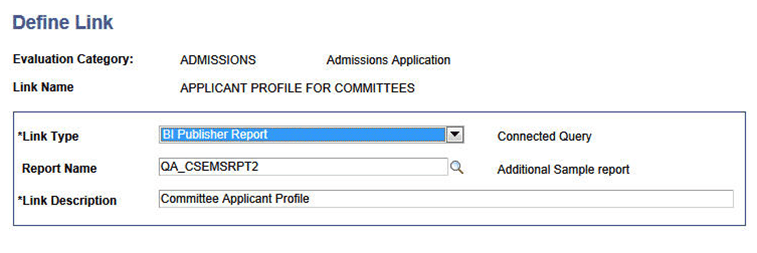

This example illustrates the fields and controls on the Define Link page (for link type of BI Publisher Report). You can find definitions for the fields and controls later on this page.
Define Links page for BI Publisher Report

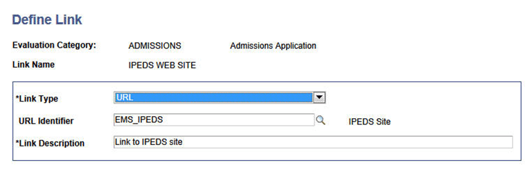

This example illustrates the fields and controls on the Define Link page (for link type of URL). You can find definitions for the fields and controls later on this page.
Define Link page for URL

Link Type
Two link types are delivered: BI Publisher Report and URL. Behavior of the remaining fields on the page will change based upon the link type that you select.
Report Name
This field is available when you select BI Publisher Report as the link type. This field prompts against the BI Publisher Report Definition table (Reporting Tools, BI Publisher, Report Definition, Definition).
URL Identifier
This field is available when you select URL as the link type. This field prompts from the URLs defined in the URL Maintenance page (PeopleTools, Utilities, Administration, URLs).
Link Description
The description defaults in from either the BI Publisher Report definition or the URL definition. You can change this default description.
