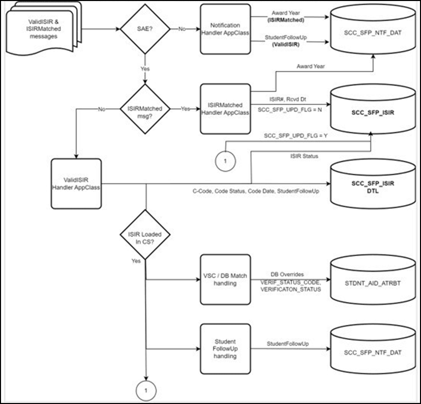

These are the Notification Events currently supported in the SAE Pull Process:
  • FasStudentNotificationEvent.
  • FasDocumentRequestEvent.
  • FasDocumentRejectedEvent.
  • FasLetterNotificationEvent.
  • FasValidIsirProcessStatusInformationEvent.
    ISIR entry saved only if its corresponding StudentFollowUp value is True.
This table explains the notification types.
SAE Notification Type SAE Notification Trigger SAE Notification Message Example
FAFSA
SDI is received and no ISIR exists for any open FAFSA award year OR student continues into a new award year and no ISIR exists.
FAFSA for the 24/25 Aid Year is due. Please go to www.fafsa.ed.gov to complete.
Populate Generic Message when event message includes an ISIR Code where <StudentFollowUp>true</StudentFollowUp>
One or more FAFSA questions require follow up in order process your financial aid. Please log into your financial aid student portal to review and complete any open action items.
