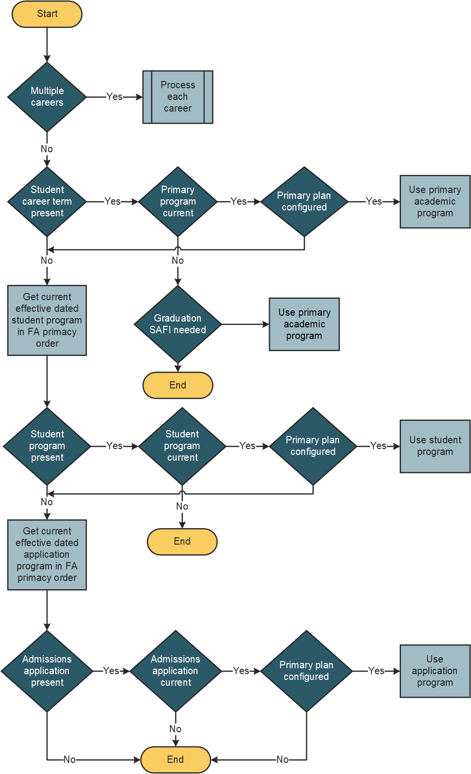

General SAFI Processing Rules
CS/SFP SAFI Process
CS/SFP SAFI Process
Multiple Academic Careers result in multiple SAFIs generated, one for each career.
  • If a student is in multiple Academic Programs within one Academic Career:
    • The Primary Academic Program in Student Career Term is selected.
    • If Student Career Term data is not found, then the Academic Program with the lowest Primacy Number is selected.
  • If a student is in concurrent Academic Programs in the same Academic Career and the Programs are effective at the same time, then the Program with the lowest Primacy Number is selected. The SAFI Process assigns a different Academic Program code for successive programs in the each Academic Career (for example, a student is matriculated in a second undergraduate program after completing an initial undergraduate program).
  • If a student is in multiple Academic Plans within an Academic Program, the Academic Plan with the lowest sequence number (PLAN_SEQUENCE) takes precedence.
  • If a student has an Academic Program with an Expired Program Status such as Completed, Discontinued, Deceased, Dismissed, or Suspended with Effective Dates prior to the Process Run Date, the system sends a Terminating SAFI, as appropriate.
  • If a student has completed a graduate Academic Program and has an open admissions application for a second graduate Academic Program, the SAFI Manager looks in each Academic Career and considers which Academic Program to use in the SAFI in this order:
    1. Primary Academic Program in Student Career Term.
    2. Matriculated Academic Program.
    3. Admissions Application Program.
If you do not want to send a Student Program/Plan to SFP, leave the SFP Program Type blank. This is in the Academic Plan setup and intended for non-degree Academic Programs and Plans you may have defined.
When SAFI Student Resources are sent to SFP, CS Third Party Payment Contracts and CS Waivers are sent with no <PaymentId>.

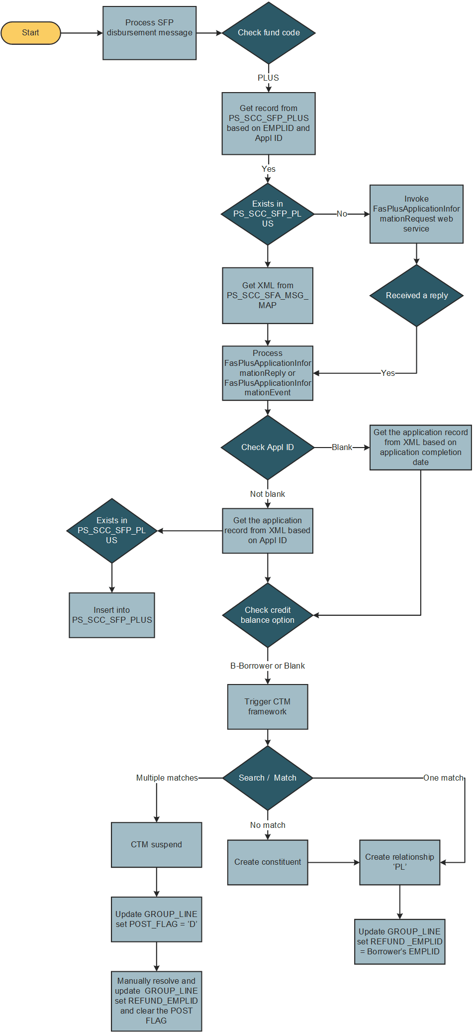

PLUS Disbursement Processing
The CS-SFP pull process for the FasDisbursementInformationEvent looks at the refund indicator, and, if a borrower exists, the FasPlusApplicationInformationRequest web service is invoked to retrieve the biographic and demographic information of the borrower. The FasPlusApplicationInformationReply service provides the information to CS, and the Constituent Transaction Management (CTM) framework is triggered. After the borrower has been found or created, a relationship between the student and borrower is created where the Relationship value is PL (PLUS loan borrower).
  • SFP supports the packaging of multiple PLUS applications submitted by a single borrower for an academic year. SFP packages and originates a separate PLUS loan per PLUS application.
  • For multiple PLUS Loan Application Records, messages include the <ApplicationID> for each borrower.
  • If Transaction Setup Matches Found value is Suspend (multiple matches), then insert into GROUP_LINE.POST_FLAG = ‘D’. This causes the GROUP_CONT_INFO to not be in balance and posting status = incomplete.
  • The posting status of Incomplete alerts the user there is an issue so they can manually research to find the correct REFUND_EMPLID value and then manually reverse the GROUP_LINE.POST_FLAG = ‘N’.
  • The process only throws an exception if the required fields to create a Constituent (SSN, First Name, Last Name) are not found. For the other records, if the required fields are missing, it does not throw an exception or create a row.
  • Integration messages allow your financial system to use the School Credit Balance and Refund Balance options on the PLUS application to accurately determine the anticipated aid and apply the PLUS loan funds to the student account once disbursed.
Graduate PLUS Disbursement Processing does not invoke the FasPlusApplicationInformationRequest web service but does update the Group Line from the FasDisbursementInformationEvent. Graduate PLUS loans do not update Campus Community bio/demo data for the student.

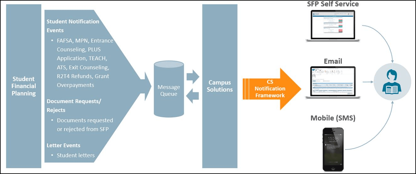

SFP Notifications through the CS Notification Framework
SFP Notification Events are pushed to the CS Notification Framework and CS Batch Notification generates an email, as shown in this diagram.
SFP Notifications through CS Notification Framework
