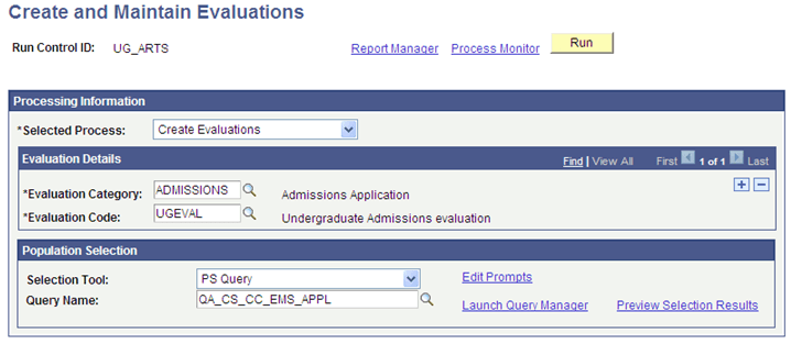

Access the Create and Maintain Evaluations page (Campus Community, and then Evaluation Management System, and then Create/Maintain Evaluations).
This example illustrates the fields and controls on the Create and Maintain Evaluations page. You can find definitions for the fields and controls later on this page.
The fields on this page change, depending on the Selected Process option you select.

Selected Process
Select one of three processing options:
Create Evaluations: To create a new evaluation for the selected IDs.
Delete Evaluations: To delete the evaluation data for the selected IDs.
Update Evaluations: To make updates and changes, within certain conditions, to existing evaluations.
Start Workflow: To initiate workflow processing for the selected IDs.
Evaluation Category
Enter an evaluation category; categories are defined on the Define Evaluation Category page.
Evaluation Code
Enter an evaluation code; codes are defined in the Define Evaluation Code component.
Create Evaluations
Enter an Evaluation Category and Evaluation Code, then use Population Selection to select IDs for which you want to create new evaluations.
Delete Evaluations
Use Population Selection to select IDs for which you want to delete evaluations. The system deletes evaluations based on evaluation instance number.
Population selection is a method for selecting the person IDs to process for a specific transaction. The Population Selection group box is a standard group box that appears on run control pages when the Population Selection process is available or required for the transaction. Selection tools are available based on the selection tools that your institution selected in the setup of the Population Selection process for the application process, and on your user security. Fields in the group box appear based on the selection tool that you select. The fields behave the same way from within the group box on all run control pages and application processes.
The PeopleSoft system delivers predefined sample queries to enable you to select person IDs, organization IDs, or both. The predefined queries are:
  • QA_CS_CC_EMS_APPL – for identifying applicants for evaluation creation.
  • QA_CS_CC_EMS_THESIS – for identifying thesis candidates for evaluation creation.
  • QA_CS_CC_EMS_UPD_DEL – for identifying IDs based upon evaluation instance ID to update or delete an evaluation and also for the Start Workflow process.
The PeopleSoft system also delivers predefined sample equations to enable you to select person IDs, organization IDs, or both. The predefined equations are:
  • CCEMPSCRTADM - for identifying applicants for evaluation creation.
  • CCEMPSCRTTHS - for identifying thesis candidates for evaluation creation.
  • CCEMPSUPDDEL - for identifying IDs based upon evaluation instance ID to update or delete an evaluation.
If your institution uses a specific delivered selection tool (PS Query, Equation Engine equation, or external file) to identify IDs for a specific transaction, you must use it.
When you click the Run button, the SCC_GE_MAINT App Engine process launches and processes the selected IDs for the action selected on the run control. View the message log for information about the process results and actions taken and any exceptions that may have occurred during the processing.
