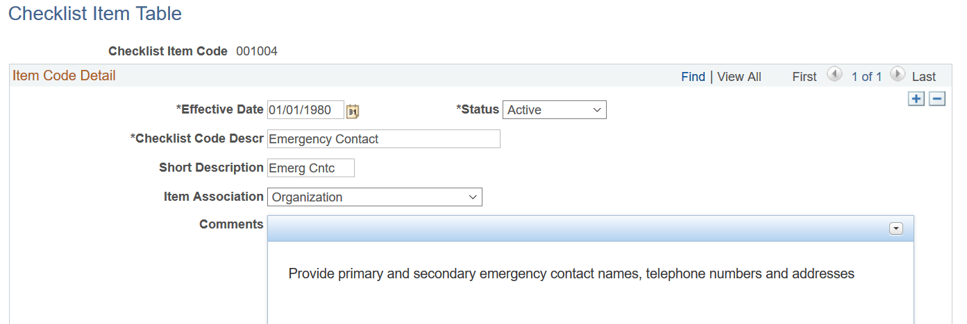

Defining Checklist Items
Access the Checklist Item Table page (Set Up SACR, and then Common Definitions, and then Checklists, and then Checklist Item Table).
This example illustrates the fields and controls on the Checklist Item Table page. You can find definitions for the fields and controls later on this page.
Checklist Item Table page (1 of 2)
This example illustrates the variable fields set up for display in the Fluid User Interface.
Checklist Item Table page (2 of 2)
Field or Control Description
Item Association
If the item is associated with a particular person or organization in any way, you can select either Name or Organization to indicate that.
The item association that you select here is used on checklist management pages when you assign checklists to IDs. Although you assign the checklist to the ID, you might want to know that an item must come from, or is in some other way associated with, another individual or organization. For example, you might assign a checklist item called Transcript to an individual, and that item might be created with an item association of Organization. On the checklist management page where you assign the checklist to the ID, you can identify the organization (for example, PeopleSoft University) from which that transcript is needed for the applicant to be admitted. This is especially helpful if you need to receive multiple transcripts for an applicant.
The Item Update - Automated process, which links checklist items with transcripts with general materials, such as recommendation letters, and with tests scores in PeopleSoft Recruiting and Admissions, also uses this.
Values for this field are delivered with your system as translate values. You should not modify these translate values.
Comments
Enter comments to further describe or define this Item Code. This is a rich text field, so you can format text and include external URLs or email links that are displayed on a Fluid User Interface.

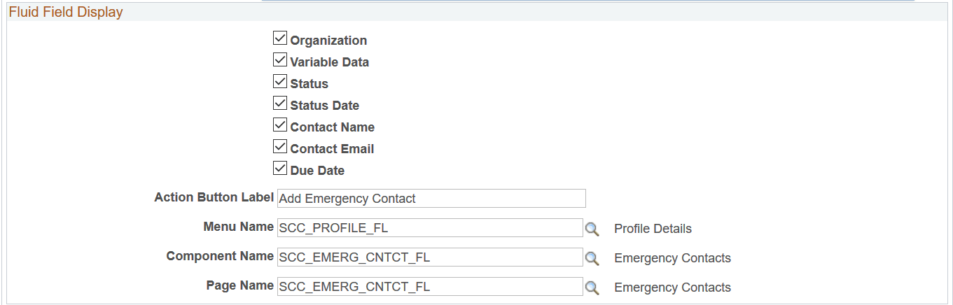

Fluid Field Display
Set up these optional fields for the PeopleSoft Fluid User Interface.
Use the check boxes to set up optional fields to be displayed on the Task Details page from Person Checklist Item. By default, the check boxes are not selected for new records. The Checklist Code Descr and Comments are always displayed. If there is more than one active institution, the institution is displayed.
  • Organization—the check box is enabled only if the Item Association value is Organization. Select either an Ext Org ID (ASSOC_ID) or enter a value on the Checklist Management page.
  • Variable Data—the check box is enabled for checklist items associated with admin functions used for person checklists that have variable data fields. Variable data fields are displayed from the relevant record (VAR_DATA_XXXX) based on the admin function associated with the checklist assigned to the student. If a variable data field does not contain a value or is zero, the field is not displayed on the Task Details page. In some instances, a description is displayed rather than the field value.
  • Status—status of the checklist item.
  • Status Date—date associated with the status.
  • Contact Name—if the check box is selected, the name of the person defined as the Responsible ID in the Person Checklist Item is displayed. If defined, the preferred name is displayed, otherwise the primary name is displayed. If a Responsible ID is not defined, the field is not displayed.
  • Contact Email— if the check box is selected, the preferred email of the defined Responsible ID in the Person Checklist Item is displayed. If a Responsible ID is not defined or if the Responsible ID does not have a preferred email defined, the field is not displayed.
  • Due Date
Note: Since Admissions checklist items appear in the context of an application, the Variable Data fields are not displayed in them.
Action Button Label
Set up an optional button in the Hold Details modal page to navigate to another Fluid self-service page. If configured, also define the target Fluid page in the Menu, Component and Page fields.
For the Action Button to be displayed on mobile devices without the need for horizontal scrolling, ensure that the label value has a maximum of 30 characters.
